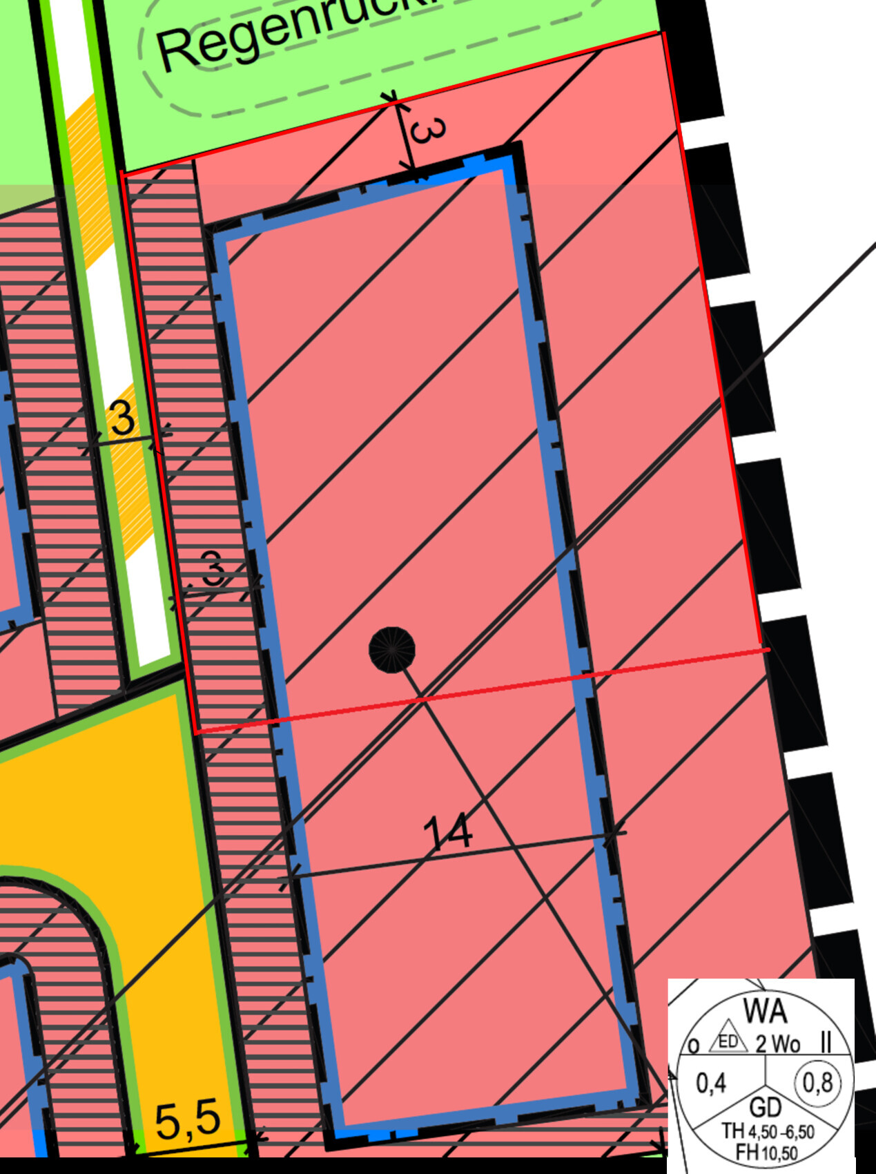

We are still at a very early stage of planning a single-family house with approximately 160m² (1,722 sq ft) of living space. So far, we only have very rough ideas about the house itself, as we want to secure a suitable plot of land first. In general, we have been leaning towards a prefab house.
We are currently in the allocation process for a plot (outlined in red). We generally like the size and location (edge of a field). However, there are several special conditions and restrictions, so we are wondering how to build on this plot sensibly.
- To the north, there is an adjacent retention basin fenced off.
- To the west, there is a bike path. A 3m (10 ft) “front yard” is required here (only a low fence or hedge allowed, no carport or driveway).
- The entrance from the street is to the south-southwest.
- To the east, the plot borders directly onto the field.
- To the south is the neighboring property.
Our initial idea would be to place the carport directly on the southern side, by the street, separate from the house. Then position the house to the north or northeast with a walking path to the west side at the gable entrance.
This way, the terrace and garden could be planned facing south/southeast.
What do you think of this approach? Does it make sense?

Development plan/restrictions
Plot size: 620m² (6,675 sq ft)
Slope: no
Site coverage ratio: 0.4
Floor area ratio: 0.8
Number of floors: 2
Roof type: pitched
Architectural style: open
Orientation: free
Maximum height/building limits: main roof 4.5–6.5m (15–21 ft), full height 10.5m (34 ft)

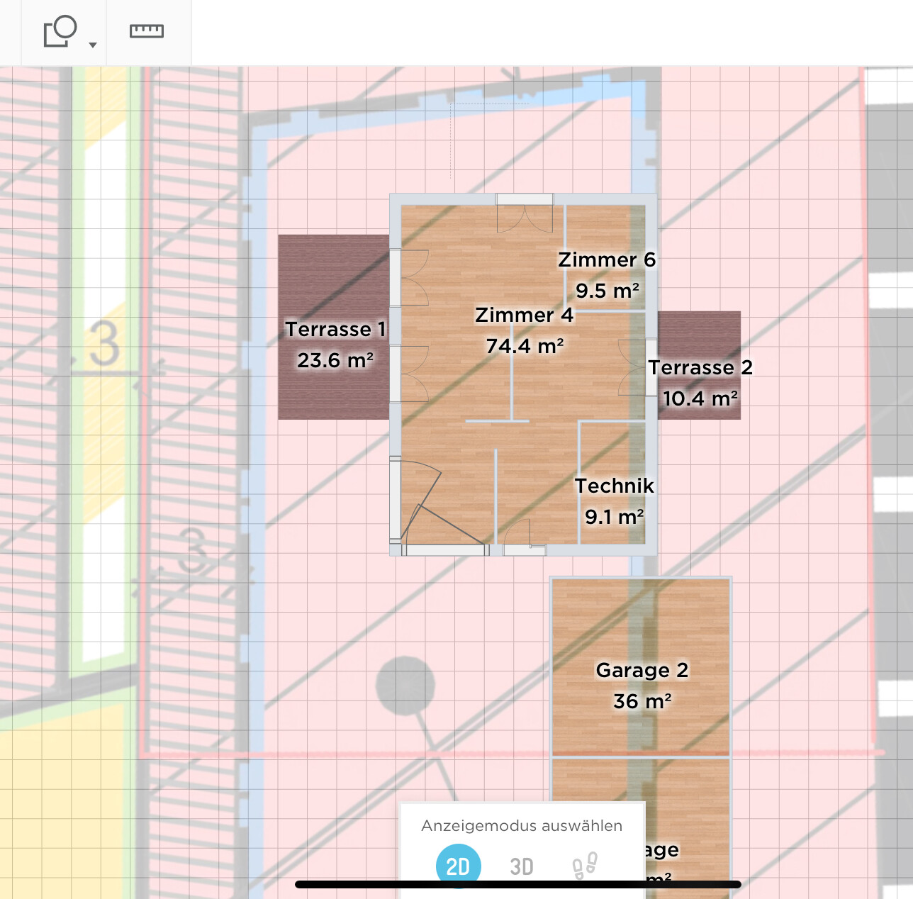

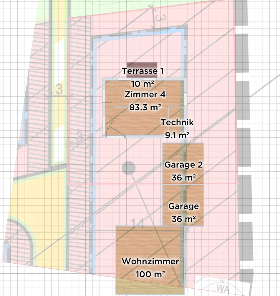

Then you could plan the terrace and garden facing south/southeast. I roughly marked how natural light could enter the house. Of course, this depends on the floor plan.
You could also build a dormer with a large window facing south and create a small open space by the stairs to bring the captured light into the ground floor. However, openness is not everyone’s preference, especially when considering children.
The terrace will receive plenty of outdoor light. The garden gets sun, naturally also on the north side.
Since the terrace is usually enjoyed mostly in the evening during summer, here’s the highlight: the sun sets in the northwest! In summer.
It’s important to get enough light inside the house from east to west.
As for terraces, you can place several around the property. These are called outdoor seating areas.
P.S. The images should be swapped.

- There is a bike path on the west side. A 3m (10 feet) “front garden” is required here (only low fence / hedge, no carport or driveway) So, on nice days, many people cycle by and some of them will curiously look into your property. Does that bother you? If yes, you’ll need to plan the building layout so that not everyone can see onto your terrace. In that case, also consider modern window fronts.
Regarding positioning... placing the carport close to the street is usually a given. The next question is where you want the front door. Traditionally from the north (which means a longer walk), on the west gable side (a gable-side entrance can often be tricky for the floor plan), or for the shortest route from the south (which is rather unconventional). I would initially leave the utility room out of the planning considerations. But yes, every meter counts, and beyond a certain distance (usually 15–20m (50–65 feet)), you get a handover chamber from the supplier, and you’re responsible for everything beyond that point. In any case, it’s not easy to realize floor plans with a utility room plus an extra workspace/guest room on the ground floor. This requires a lot of space on the ground floor. So it’s better not to start with the goal of placing the utility room in the shortest corner right away.
