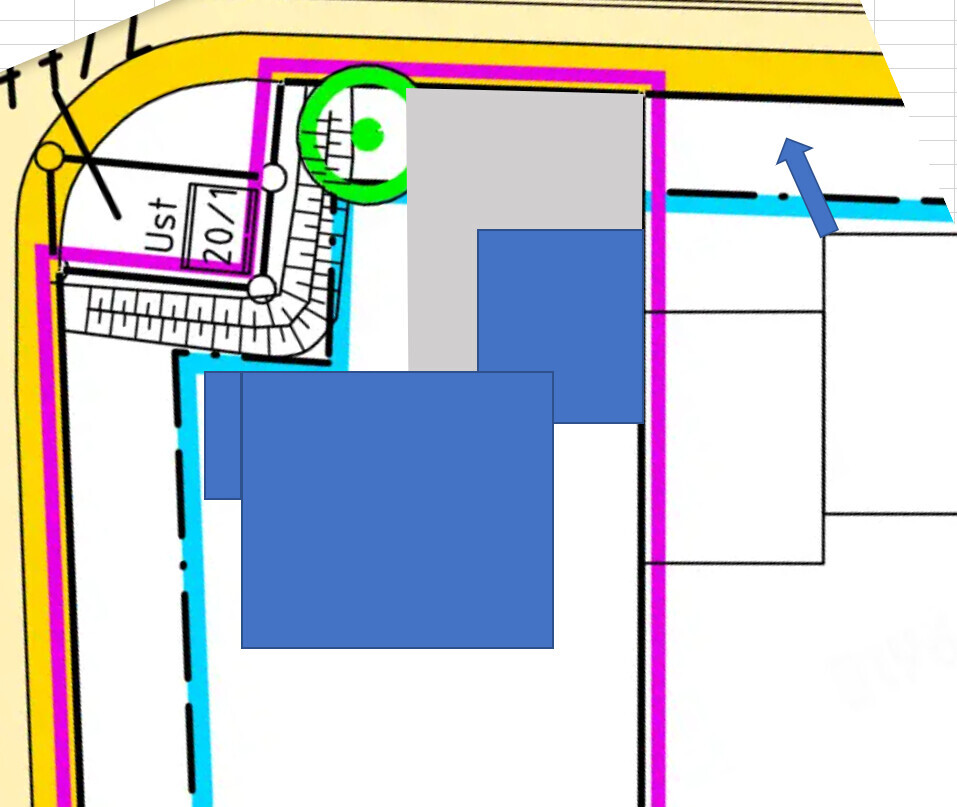

hanghaus2023
26 Feb 2023 12:28
To position the house as far north as possible and also have the garage driveway on the north side, here is the following suggestion.
Colorful building plan layout with measuring stick, protractor, colored lines, and blue areas
Now it would be possible to exclude either the garage or the house.
I quite liked the bay window on the ground floor, as in your first design.
Traufgänger
27 Feb 2023 21:47
hanghaus2023 schrieb:
To position the house as far north as possible and have the garage driveway also accessible from the north, here is the following suggestion.
Now the garage or the house could be left out.
I quite liked the bay window on the ground floor like in your first design.
Hi, greetings Hanghaus2023. We also came up with this idea at the end, or maybe just a garage and instead adding a carport 🙂
The bay window does have something special. We dropped it back then because our external dimensions increased and we prioritized the room at the front left with about 3.85 x 4.00m (12.6 x 13.1 ft) so that it could be used barrier-free in case something happens to one of us 🙂
Best regards and thanks for your inspiration
