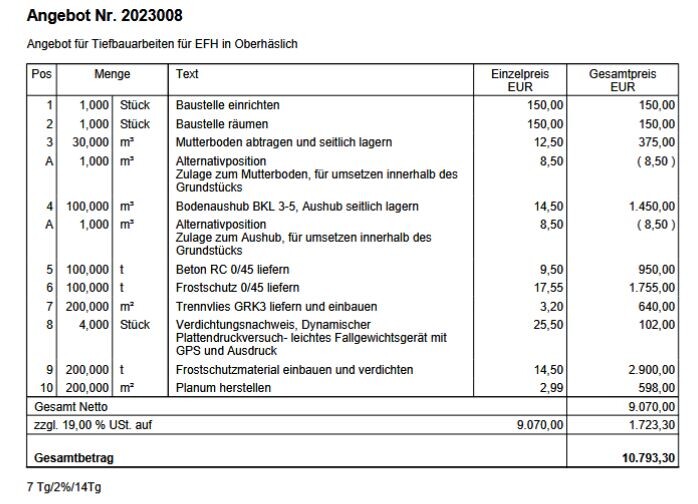

Oberhäslich10 Mar 2023 10:13Things are starting to move for us as well. The building application is still with the authorities, but according to the quote, I have already heard from the civil engineer that it has been approved by the municipal council.
I have been focusing on the foundation and excavation for some time now. I decided to handle the work myself, meaning we will hire the civil engineer directly. Heinz von Heiden gave us a credit of €2,500 (about $2,500) to cover the first 30cm (12 inches) of topsoil excavation.
Now I have requested quotes from two local civil engineers. The first one, located 35km (22 miles) away, charges hourly rates (€650 (about $650) net/8 hours), including the excavator, operator, and vibrating plate. The other gave me a quote based on square meters/cubic meters. His offer is very reasonable; he lives about 5km (3 miles) away and is also involved in the municipal council. The offer is attached. What would you choose? With the hourly civil engineer, I will arrange delivery of the gravel myself. I can get recycled gravel for €13.08 (about $13) per ton including delivery, and fine screening gravel for €17.85 (about $18) per ton from the container service.
In my opinion, the hourly option will be more cost-effective, around €1,000-1,500 (about $1,000-1,500). He estimated about six days of 8 hours each, but I can’t really judge that. Even if it takes one day longer, it would still be cheaper.
About 50cm (20 inches) needs to be excavated and an average of 50cm (20 inches) of gravel filled in. Soil classification 2-4. The soil will remain on the property.

Oberhäslich10 Mar 2023 10:28Yes, based on my gut feeling, I also prefer that, especially because he knows the area well and has a short travel distance. But it could have been that someone else says it can easily be done in 4 or 5 days. That’s already a difference of 2,000–3,000 euros. The hourly rate of €81.25 (net) is not that high, including machinery.
hanghaus202310 Mar 2023 12:13No one can take the risk away from you.
Why are you only getting 2.5k from Heinz von Heiden? Did they design the house directly on the existing soil?
O
Oberhäslich10 Mar 2023 12:17At Heinz von Heiden, the house price includes the removal of the first 30cm (12 inches) of topsoil and nothing else. That means no gravel or similar materials. If you want to do the groundwork yourself, this part will be credited to you. Or did I misunderstand your question...?
