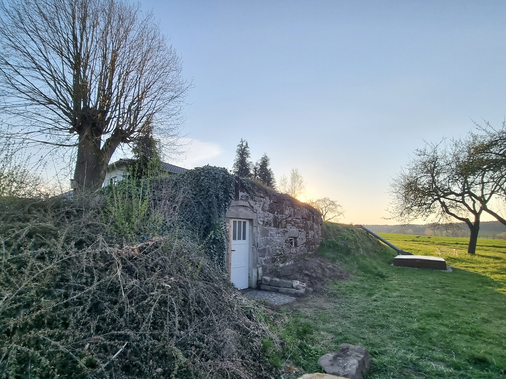

Here’s a little impression of our potato bunker:

Here’s a little glimpse of our potato storage bunker:
[ATTACH alt="Grundstück-efh-c630-heinz-von-heiden-am-standort-sachsen-571885-1.jpg"]71371[/ATTACH]Wow. How romantic and mysterious. And your kids could even practice drums there or start a band or something. Great.Pinkiponk schrieb:
It never occurred to me. It is mentioned and explained in almost every bathroom discussion 😉
