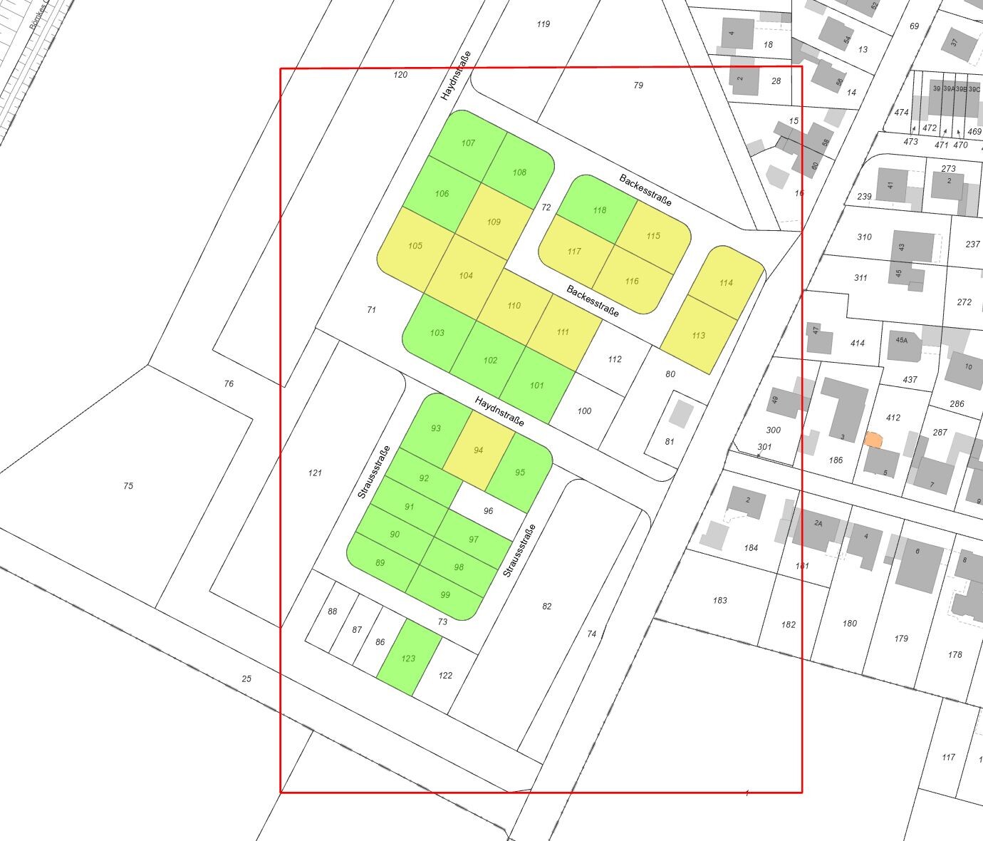

It’s finally becoming more concrete: We have now received information that we will soon be able to choose a plot of land and should start considering our options. There are still applicants ahead of us, but it shouldn’t be many.
In the meantime, the plots we would have favored (basically everything located on the quiet Backesstraße) are reserved and will not be available for selection (green = available; mustard-colored = reserved). From the remaining ones, we currently favor plot 93, followed by 103 and 102. We see 95 further down the list (there will be a daycare center parking lot opposite), and 108, 107, and 106 are less preferred due to their close proximity to the large apartment buildings on plot 119.
We are most concerned about plot 123. The location is ideal, at the southern end of the development area, with a good orientation. However, the biggest drawback is its size of only 372m² (15m width, 25m length) (4000 sq ft (49 ft width, 82 ft length)). Due to the width, a rather narrow house would have to be positioned lengthwise, and I suspect that, considering the floor space index of 0.4, it would only work properly if a basement is included, yet it would still feel quite tight. In our current development area, for comparison, there are several plots around 440m² (4700 sq ft), which is acceptable; anything smaller than that feels quite cramped. In addition, the large trees to the south of the plot would block sunlight from the garden for much of the day – not ideal either. At this point, we think plot 123 will only be an option if none of the other favorites are left.
I would choose 107, 108, and 118. Well-designed houses, located in the north with the main entrance on the north side and a gable roof running east to west. This allows for an efficient floor plan. For the garden, you could then plan a southwest or southeast orientation.
However, I have to admit that I haven’t fully followed the discussion. Is there a slope? What about plot 120? Is it an open meadow or a residential unit? Is the building area already established? If so, I would definitely visit in person to see the place and consider what might influence your comfort there.
