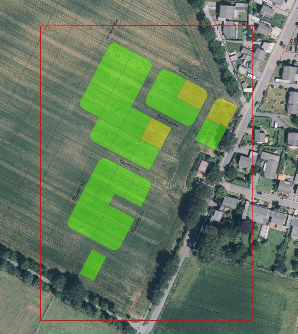

Thank you all for your numerous responses. We have already gathered many pros and cons for each plot of land and will continue to consider them over the next few days. The application deadline is this Friday, and it will probably take some time before marketing discussions begin. One nice aspect is that the process can be followed almost “live,” as every reservation for a plot is immediately visible online. This way, we can check off some plots step by step before we hopefully have a choice in the end.
Regarding the E/D matter, the inquiry is still ongoing. The responsible colleague is currently on Easter vacation.
The development plan takes precedence over the sales brochure here). And the design framework extends the development plan.
-Malte- schrieb:
The application deadline is this Friday, and then it will probably take some time before the marketing discussions begin. What’s really nice is that you can follow the whole process almost "live," since every reservation for a plot is immediately visible online. So, we can already "check off" some plots step by step, before we hopefully have a choice in the end. Then go ahead and post a screenshot of the current status on Friday!

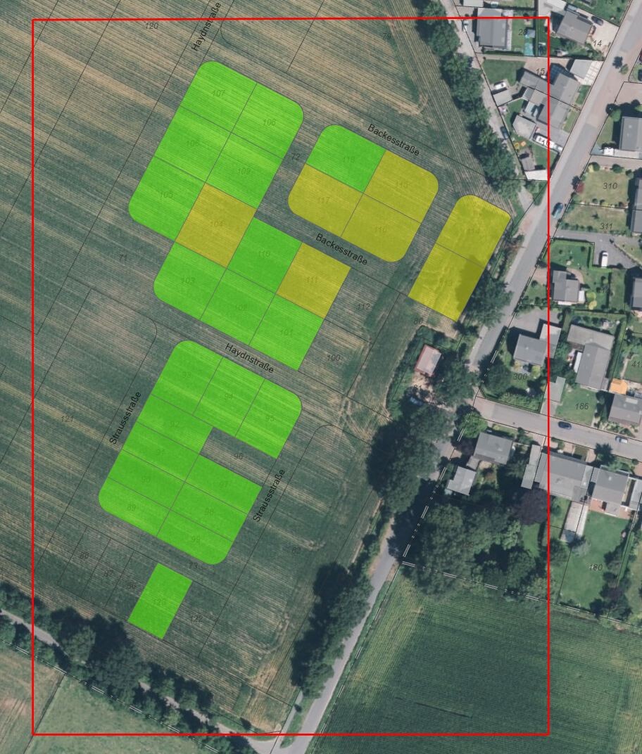

A few weeks have passed, and the application deadline has now closed. In total, there were 229 applications for the 28 advertised plots. The exact ranking in the allocation process is not disclosed; we are somewhere—probably in the upper range—of the second allocation group. The first group includes 11 applications, and the second group, which includes us, has 44 applications. The list is now being processed step by step, and once it’s your turn, you can choose from all the still available plots.
We remain optimistic and check daily how the reservations are being made one by one. So far, three plots have been reserved.
Malte
Malte
-Malte- schrieb:
We remain optimistic and are monitoring the reservations as they gradually come in. So far, three plots have been reserved. So? How does it look? Has there been any progress yet?
In the meantime, we received very positive news: We now know that we are ranked 25th out of 229 applicants. Since there are 28 available plots, we will definitely be successful. We also know that several applicants ahead of us ultimately did not reserve anything. Currently, 7 plots are reserved, so it will probably take another 2-3 weeks before it’s our turn. It will be interesting to see whether there will still be a detached house plot left for us or if it will come down to a semi-detached house.
