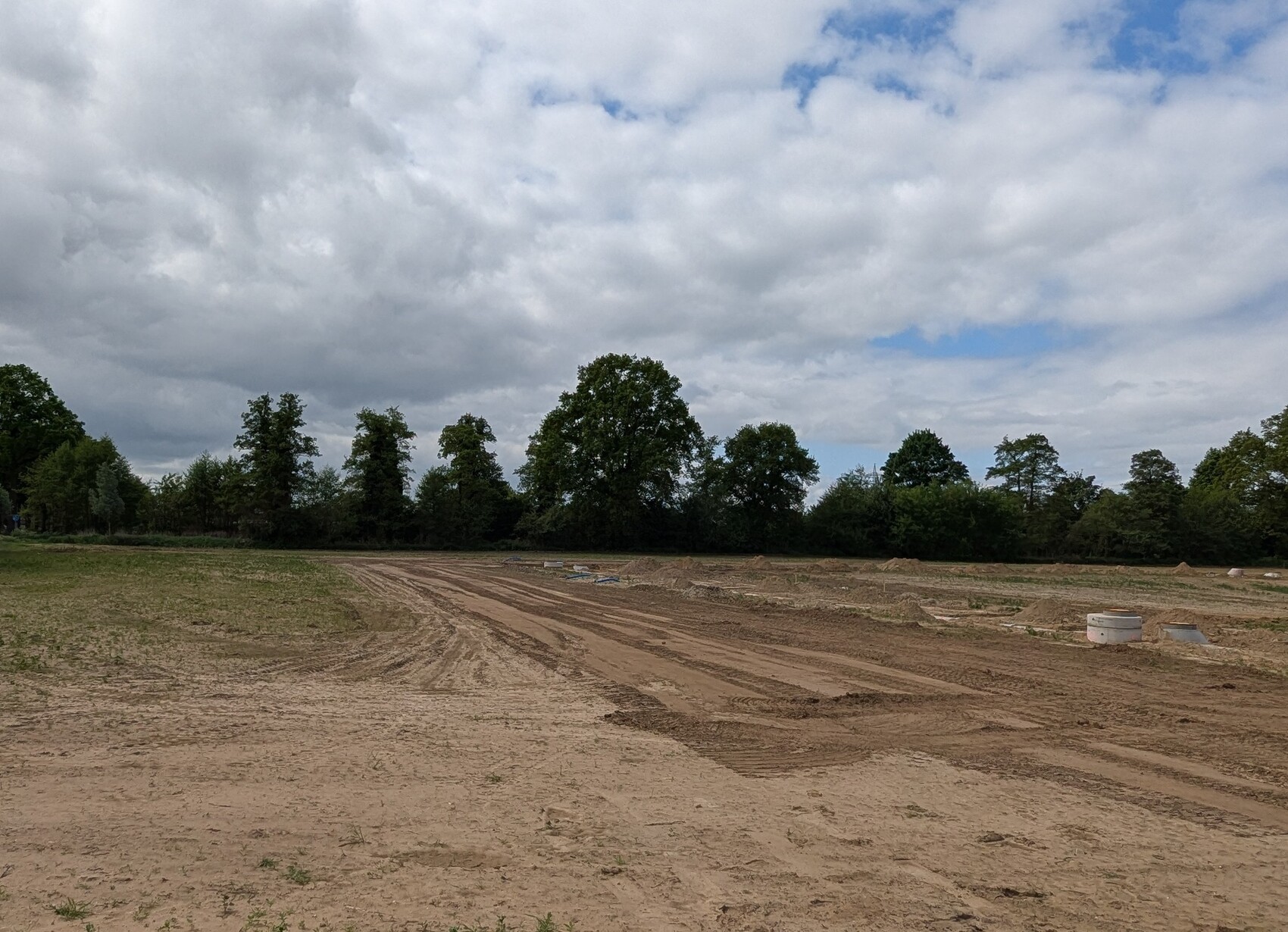

The plot you mentioned, 123 (31), is still on our minds. As you said, the location in the development is ideal. With dimensions of 15m x 25m (49 feet x 82 feet), fitting everything in will be a challenge. In my view, the house would have to be very narrow—practically a “detached semi-detached house” layout. Most likely, a basement will be unavoidable, and even then, the floor area ratio will probably cause issues with creating suitable terraces and parking spaces. The plot is visually extended at the back by the adjacent green area. However, the southern orientation is somewhat limited in practice regarding natural light. The row of trees along the south-facing street, Siegeheide, is dense and tall. In the attached photo, you can see the large tree directly behind the property, which, according to the development plan, has a trunk diameter of 0.9m (3 feet) and a crown diameter of 20m (66 feet). During my recent visits at different times of day, it appeared to me that for much of the day the plot is practically in full shade.
