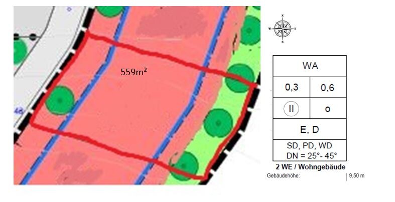

I’m attaching a plan of the plot. It is fairly flat, so that shouldn’t cause any issues. There are building plots to the north and south, a road to the west, and undeveloped farmland to the east. Completion of infrastructure development is expected in the second quarter of 2025. Construction must begin within 36 months after the building permit / planning permission is granted.
So far, we have mainly followed the company’s designs. Some of them fit pretty well, but not perfectly (for example, we want the utility room on the north side, and the terrace facing south / southeast, which sometimes would require mirroring or similar adjustments). However, we haven’t found any design that works for both the ground floor and the upper floor, so we have put together a custom solution. But now we are probably going to approach this more openly.
You shouldn’t go to second or third companies but stick with the first architect (or to an independent building consultant who can refer you to an architect, and after you work out a preliminary design with them, help you choose suitable catalog designs). I am one of those, construction-method-neutral. But there are colleagues of mine who are mostly focused or specialized in prefabricated / turnkey houses (and I regularly mention them here).
So that I don’t have to search everywhere, do you have any recommendations in the Konstanz or Bodensee district?
Plan of a plot: red outline with 559m² (6023 sq ft), green trees, blue lines, building component info on the right.

Unfortunately, the plan is cut off in the tight crop; please state the development plan (without a link). Flatness is often significantly underestimated.
Flomo22 schrieb:
Building obligation within 36 months after the building permit is granted.
Are you sure you’re not mixing this up? Three years is usually the validity period of building permits, while building obligations are typically linked to the land purchase date.
