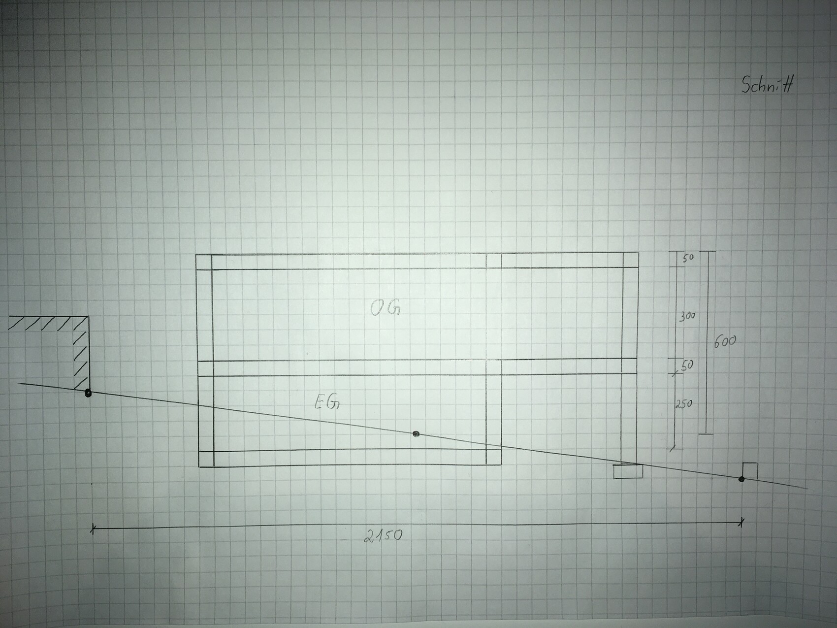

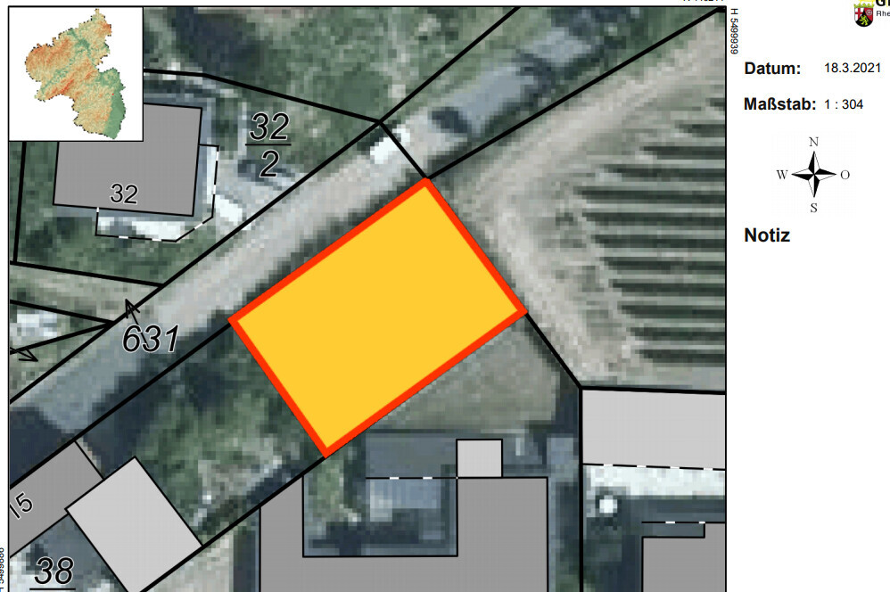

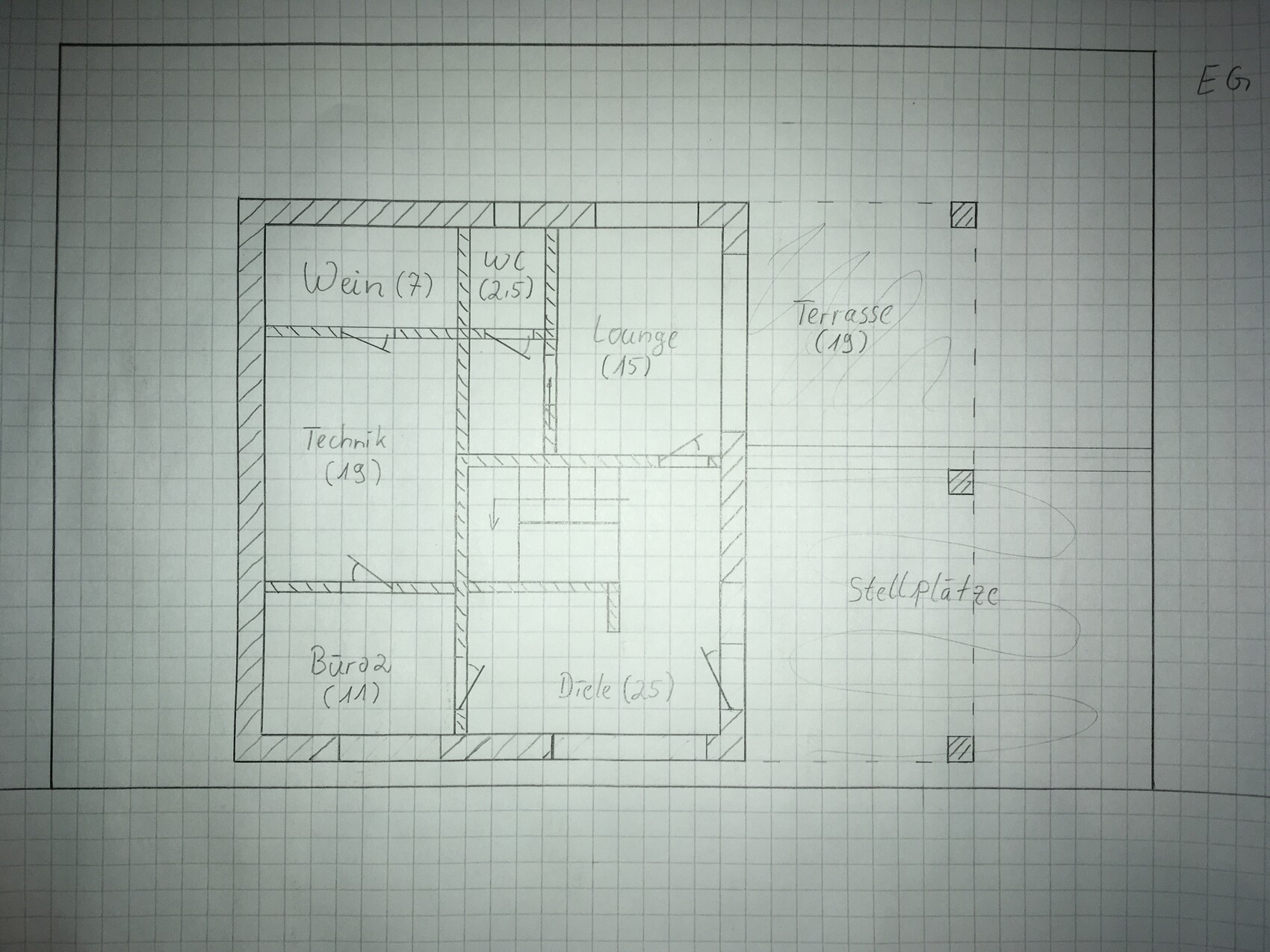

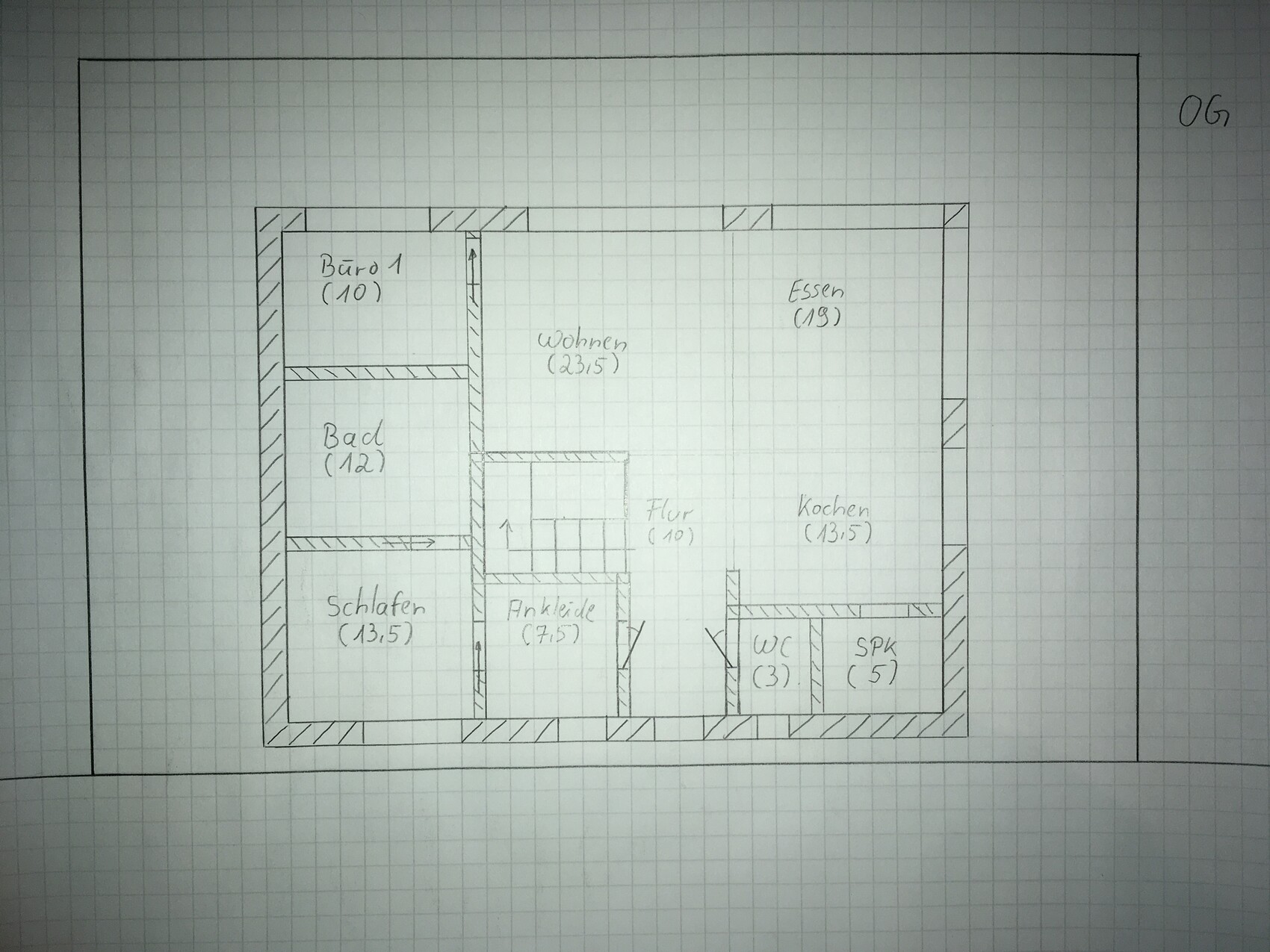

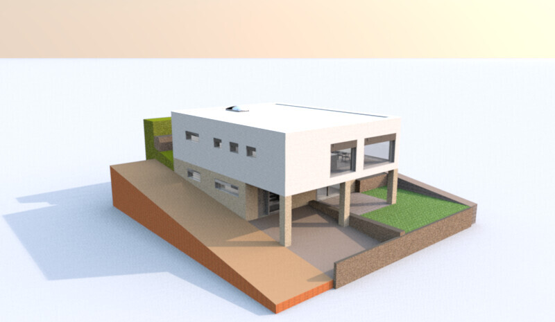

we have now started the first "internal" draft planning and I would be very grateful for any feedback – especially if there are any of our “ideas” that are completely off the mark...
Development Plan / Restrictions:
"Facts"
no development plan, last plot at the edge of a village area
Plot size: 330m² (approx. 21.8m x 14.8m / 71.5ft x 48.5ft)
Slope: about 7°
Clay-loam soil, limestone at shallow depth
Information according to building permit inquiry
Site coverage ratio: 0.6
Floor area ratio: 1.2
Street = building line
2 parking spaces
Number of storeys: max. 2 full storeys
Roof style: any
Eaves height 6m (20ft)
Ridge height 10m (33ft)
Client requirements
Style, roof type, building type: flat roof preferred, but e.g., also “modern barn” style
Basement with daylight from the slope as a lower ground floor, above that a “real” storey
2 persons (35, 36 years old)
Space requirement ground floor and upper floor: approx. 200m² (2,150 sq ft) total
Office: 2x home offices
Guest stays per year: none
Open architecture
Modern construction method
Open kitchen with kitchen island: yes
Number of dining seats: 4
Fireplace: no
Garage, carport: not essential, 2 parking spaces sufficient
Utility garden, greenhouse: as little garden as possible
Other wishes: KNX system, air conditioning for main rooms
Designer: do-it-yourself
What do you like most? Why?: main living areas all on one level
What do you dislike? Why?: bathroom and dressing room borderline “small”
Personal budget for the house, including fixtures: approx. 500,000 to max. 700,000 euros
Preferred heating system: we don’t really care
If you had to cut back, on which details or extensions
- Can be omitted: lounge on ground floor, pantry
- Cannot be omitted: guest WC on upper floor, dressing room, minimum clear ceiling height on upper floor 2.70m (better 3m / 9ft 10in)
Why has the design turned out as it is now?, for example:
“Optimizing” the eaves height while maximizing the use of setback distances
Minimize earthworks as much as possible (considering the soil...)
Have I completely misjudged any fundamental aspect? Is any detail of the design “absurdly expensive”?
Note 1: Views are just for a general idea of the plot situation at this stage – windows and so on still look pretty rough…
Note 2: Plan is drawn roughly to scale (5mm grid = 50cm / 20 inches), numbers in () are m²; north is bottom left on ground floor and upper floor plans, the beautiful view to the south is top right :-)
Already now: many thanks for all your feedback!!!

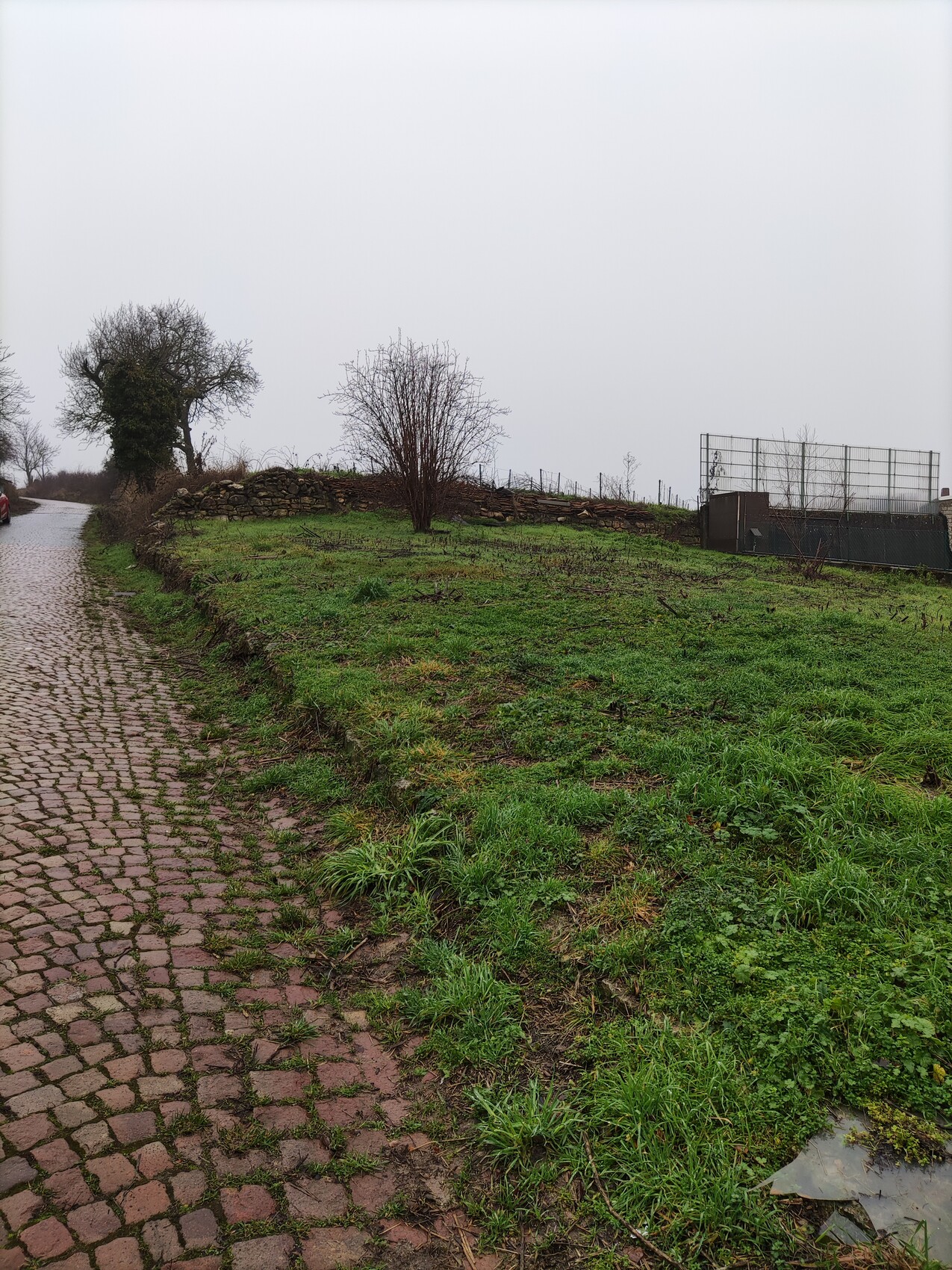

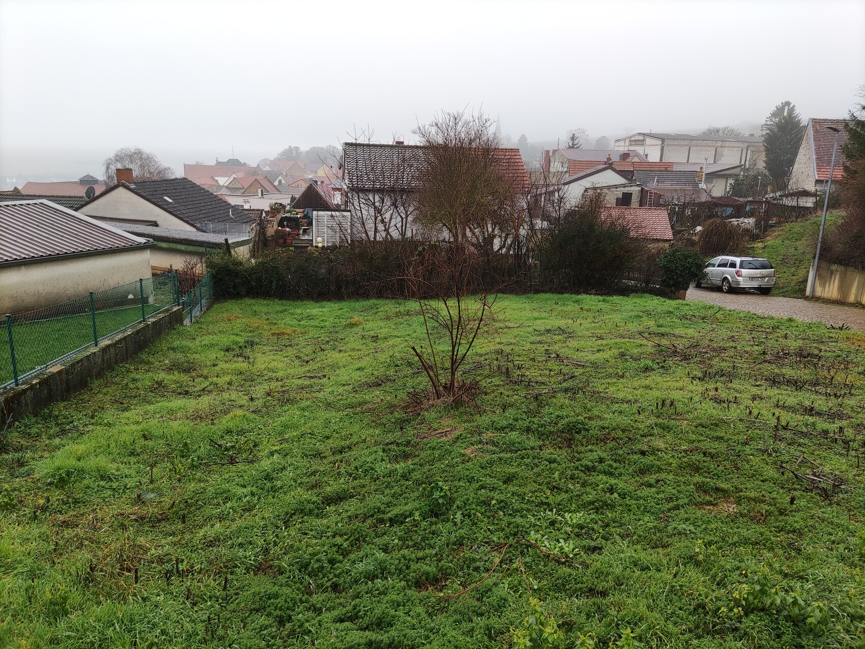

@ icandoit: Yes, there is a change in elevation in the northeast (that’s where the vineyard is, visible as parallel lines on the site plan). Currently, it is built as a dry stone wall. The road basically follows the slope. I’ve attached a photo that I think shows this quite well.
