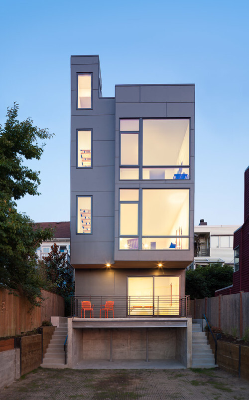

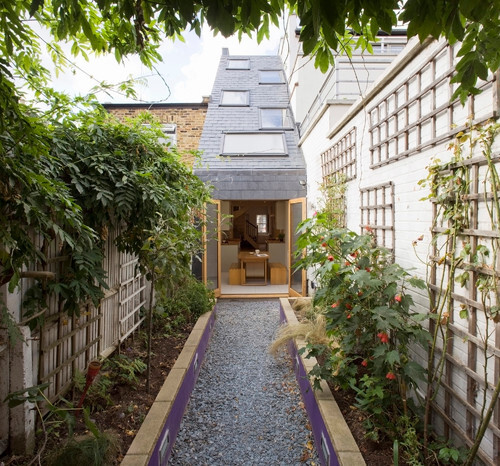

@MarcWen:
A hose is really great. I love hoses.
@MarcWen:
AngelusNoctis schrieb:
@MarcWen:
A narrow layout is really great. I love narrow designs. Have you already looked at a house of your choice to see what you want to install on it?
All the houses we viewed were always between 8–11m (26–36 feet) wide. At that width, the plot and possibilities can become quite limited.
