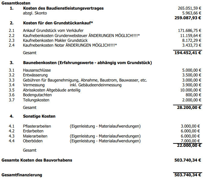

We are considering purchasing a plot of land through a real estate agent. The purchase of the land is linked to the construction of a turnkey house. So, we have an overall offer (land + house without additional construction-related costs).
Does anyone have experience with this? What else should we be aware of? We are uncertain about additional costs that may arise, which the agent did not mention during the construction discussion. I would appreciate any tips.

musswah schrieb:
He estimated additional construction costs at €28,200, other work at €22,000 And the entrepreneurial risk that he might be underestimating these costs (which is hardly avoidable due to the inherent unpredictability of surprises) is being passed on to the client here :-(
I dare to say: a developer disguised as a broker is hardly likely to be reliable (or even want to be).
musswah schrieb:
This is exactly what I was looking for. I will take a closer look at it. But what use is that to you?
A table that makes the calculation of your risk more understandable unfortunately cannot eliminate the unknowns involved.
Only if you are explicitly looking for this kind of thrill, is this a win-win situation — otherwise, the con artist has simply found a fool.
I also think this is the worst of both worlds (a genuine general contractor and "independent" building on your own land): You have the general contractor tied to the property and the risk of underestimated or unmentioned costs that you end up having to cover. Additionally, in this model, you are the client and also bear related expenses like insurance. In a true general contractor model, you wouldn’t have all of this...

Overview of total costs attached.

My humble opinion:
Additional building-related costs are estimated too low (have connection fees been clarified?); other costs are extremely tight.....
Additional construction-related costs are too tight. Civil engineering costs as well. Not to mention the additional purchase costs.
How subtly a tied sale is pointed out with 3 “exclamation marks.” Change possible!!! Cute 🙂
Was your location NRW Krefeld, right? What is the real estate transfer tax on €260,000 + €172,000? In NRW, including taxes, notary, and land registry fees, it's about 9% plus realtor fees. That’s roughly €47,000, which is quite significant. Those costs aren’t included in your calculation. The tax office will be happy about that.
