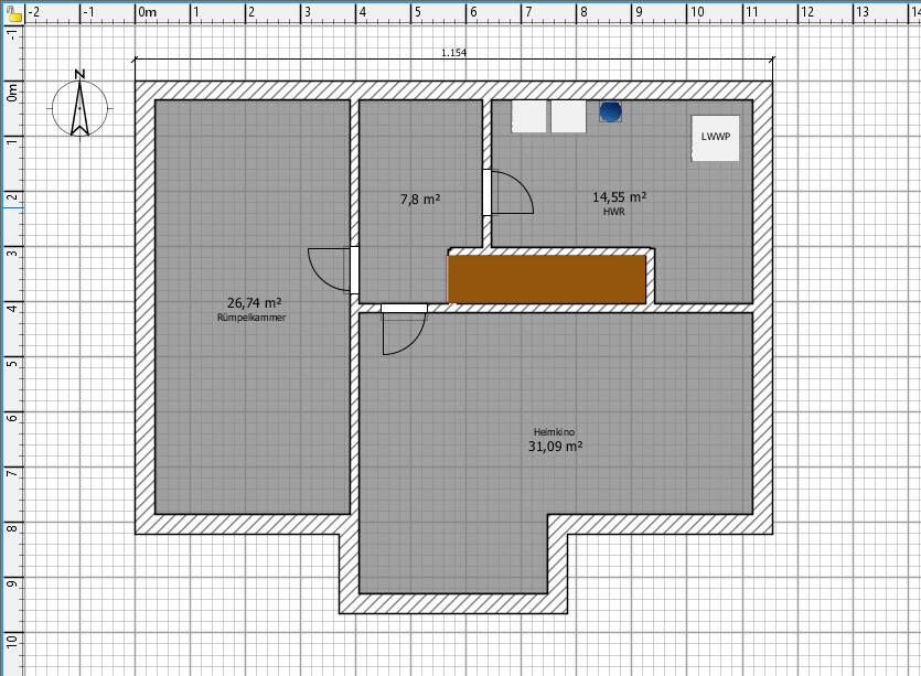

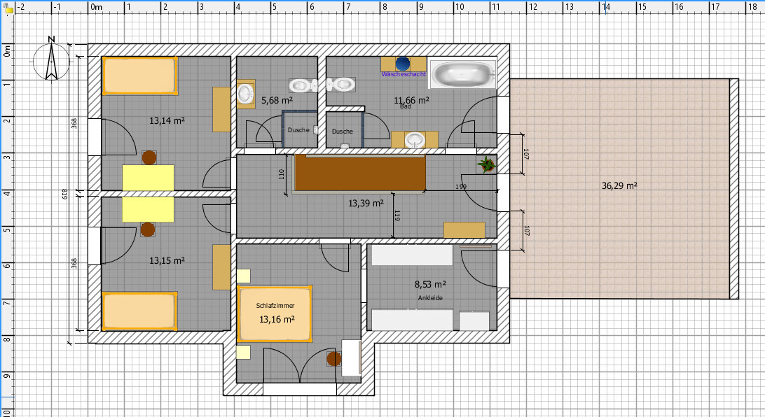

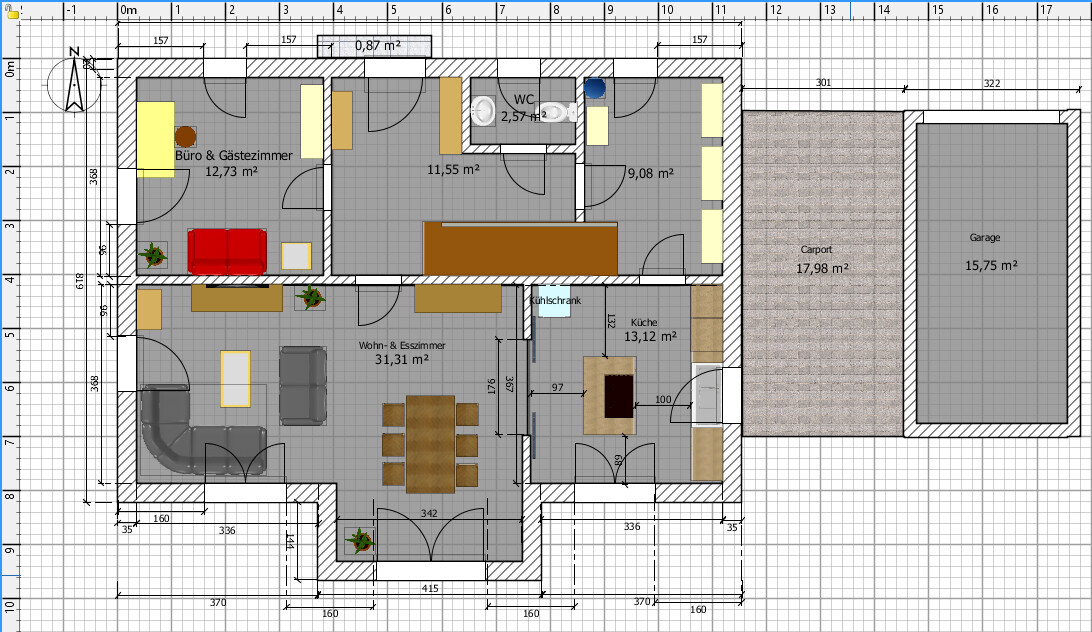

we would love to benefit from your experience and would appreciate it if you could critically review our floor plan draft. The images are attached.
We recently found a plot of land and have started planning. In terms of the house shape and design, I fell in love with a house by Kitzlinger (reference house Erkenbrechtsweiler). This Cape Cod style in sandalwood or cappuccino color just looks great, in my opinion, and goes really well with white. Using a free software program, I copied the exterior dimensions and rearranged the interior walls and staircase completely to our taste. So this is just an amateur draft. Of course, I copied from other floor plans as much as possible.
The ideas behind it:
- We prefer a straight staircase even though it takes up a lot of space. However, it is not a must-have.
- The office/guest room (northwest side) should be on the ground floor, as my wife needs it for work and sometimes wants to take documents into the living room.
- The idea of a separable kitchen: An open-plan kitchen is great. But we would like the option to close it off. If you look closely, I left a gap in the wall between the pantry and kitchen. A slim, lightweight partition could be installed there as a sliding element, allowing the kitchen to be completely separated from the living room. I know that would be 4 meters (13 feet). Such a long sliding door would be a custom solution and the question is whether it can even be built.
Additional details:
- KFW 55 standard
- Solid brick house (which probably means the wall thicknesses in the floor plan aren’t accurate)
- Air-to-water heat pump with underfloor heating

I find the living room far too narrow, if I’m reading it correctly, only 3.68m (12 feet) wide? I believe it should be at least 4m (13 feet) to prevent the living/dining area from feeling like a long, narrow corridor. I suggest reducing the width of the study (for example to 3m (10 feet)); that would provide the extra centimeters needed.
