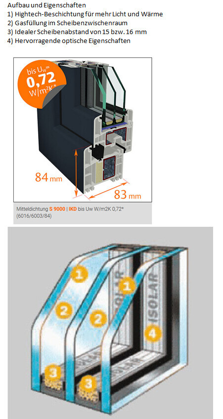

Manufacturer details:
Plastic windows:
Central seal S 9000 | IKD up to Uw W/m²K 0.72* (6016/6003/84)
Color scheme with Acrylcolor (base body and color permanently fused) inside white and outside RAL 7016 (anthracite)
The triple-glazed windows are fitted with insulating glass containing a "SWISSPACER". Ug from 0.5 W/m²K depending on profile thickness, g-value 53%.
Structure and properties:
1) High-tech coating for better light and heat transmission
2) Gas filling in the space between panes
3) Ideal glass spacing of 15 or 16 mm (0.6 or 0.63 inches)
4) Excellent optical properties
Attached is an image showing the window construction.
Do you have any further suggestions for solutions? In particular, I’m interested in how others affected have dealt with this and what the current status is. What are the chances of success when involving a lawyer or expert? I understand that windows can make some noise and that this is not automatically a defect. However, constant and loud cracking due to sunlight is, to me, not acceptable.
Thank you very much for any information, help, or feedback!
Plastic windows:
