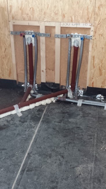

as shown in the two photos, the hot and cold water pipes are insulated. The plumber says the fittings (connectors) do not need to be insulated because they are made of plastic. Is this correct, or could this cause problems regarding thermal insulation, condensation, or noise?
The pipes are located under the screed, meaning there will be polystyrene insulation and a self-leveling screed on top.
The plumber suggests he could wrap fleece over them, but says it is not necessary. What is your opinion?
Best regards, Andreas

wrobel17 May 2016 11:12
Hello Andreas
I can only provide a definite answer for Germany.
All heated pipes, except for branch lines, must be insulated with 100% of the insulation thickness.
At the crossing points of the pipes, the insulation thickness can be reduced to 50%.
Olli

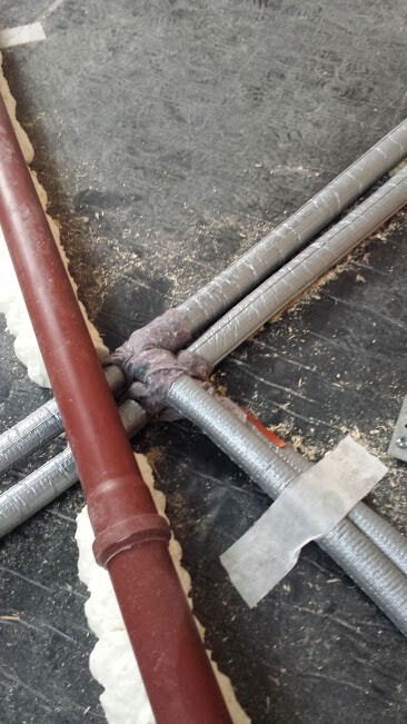

The plumber has now wrapped the fittings with fleece. Is this appropriate? What do you think?

AndreasW
18 May 2016 15:41
What do you think about insulation using fleece/felt? (as shown in the photos above)?

What should the fittings be insulated with instead?
F
FrankH
19 May 2016 08:29
Try searching for insulation fittings from Missel; that might be an alternative. Whether it is cost-effective, however, is another question.
