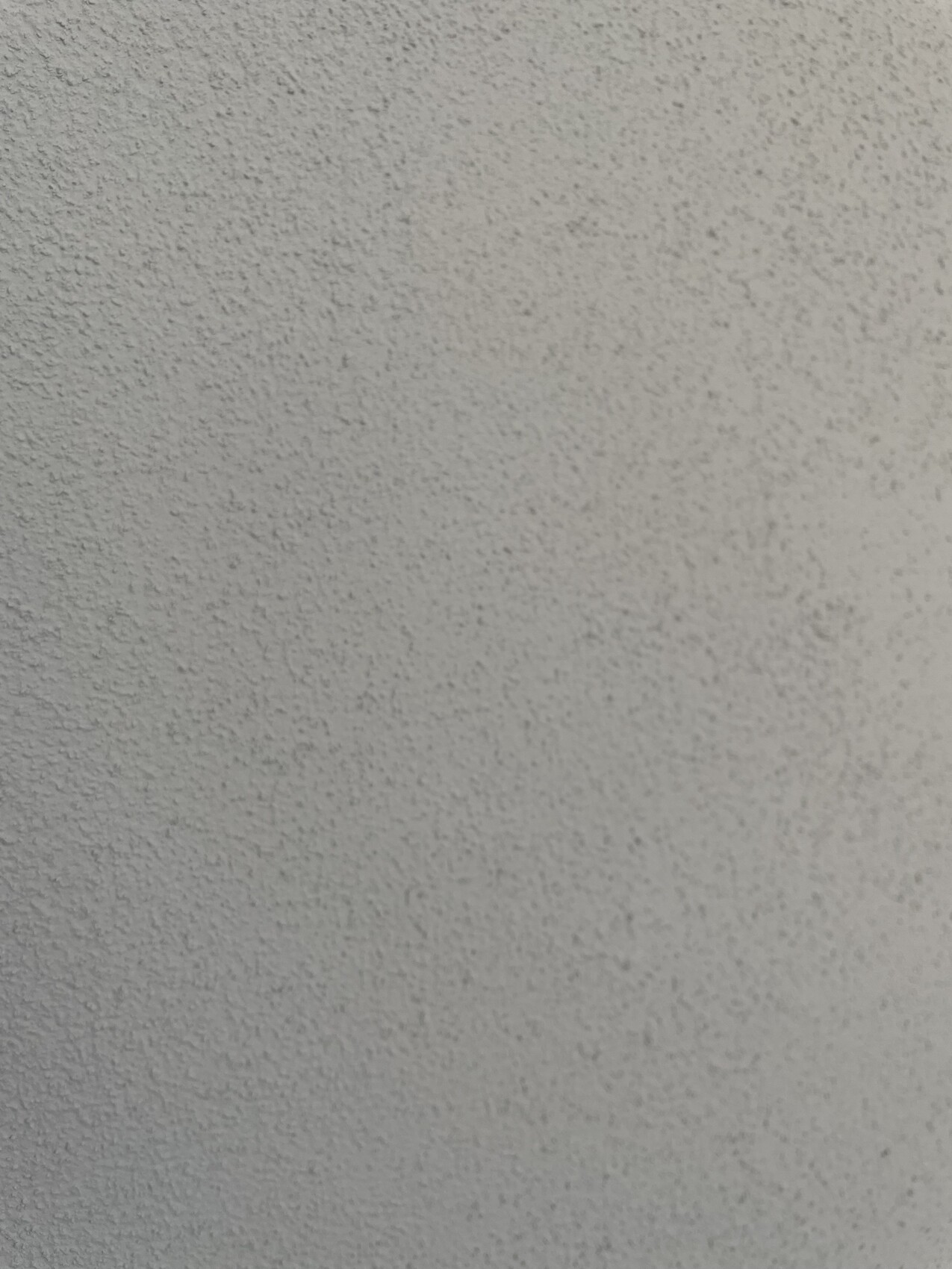

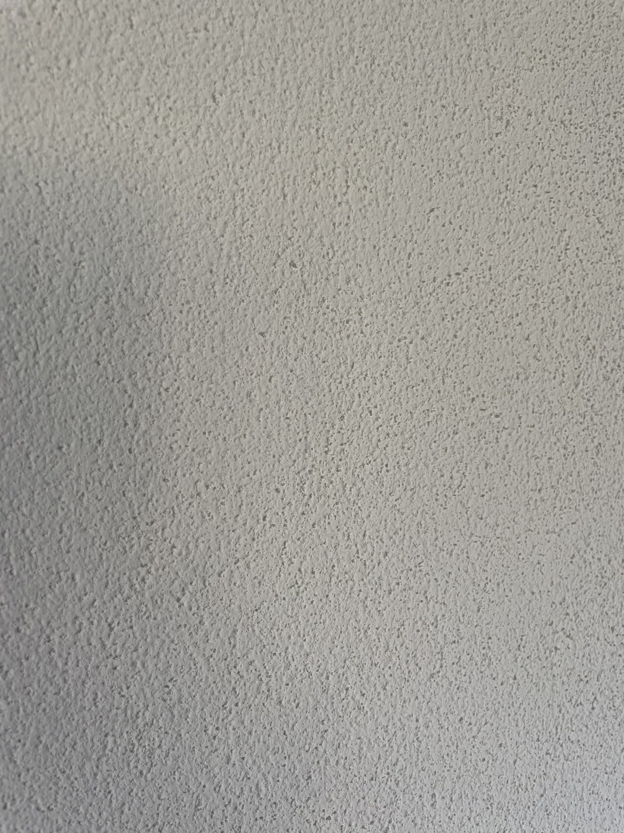

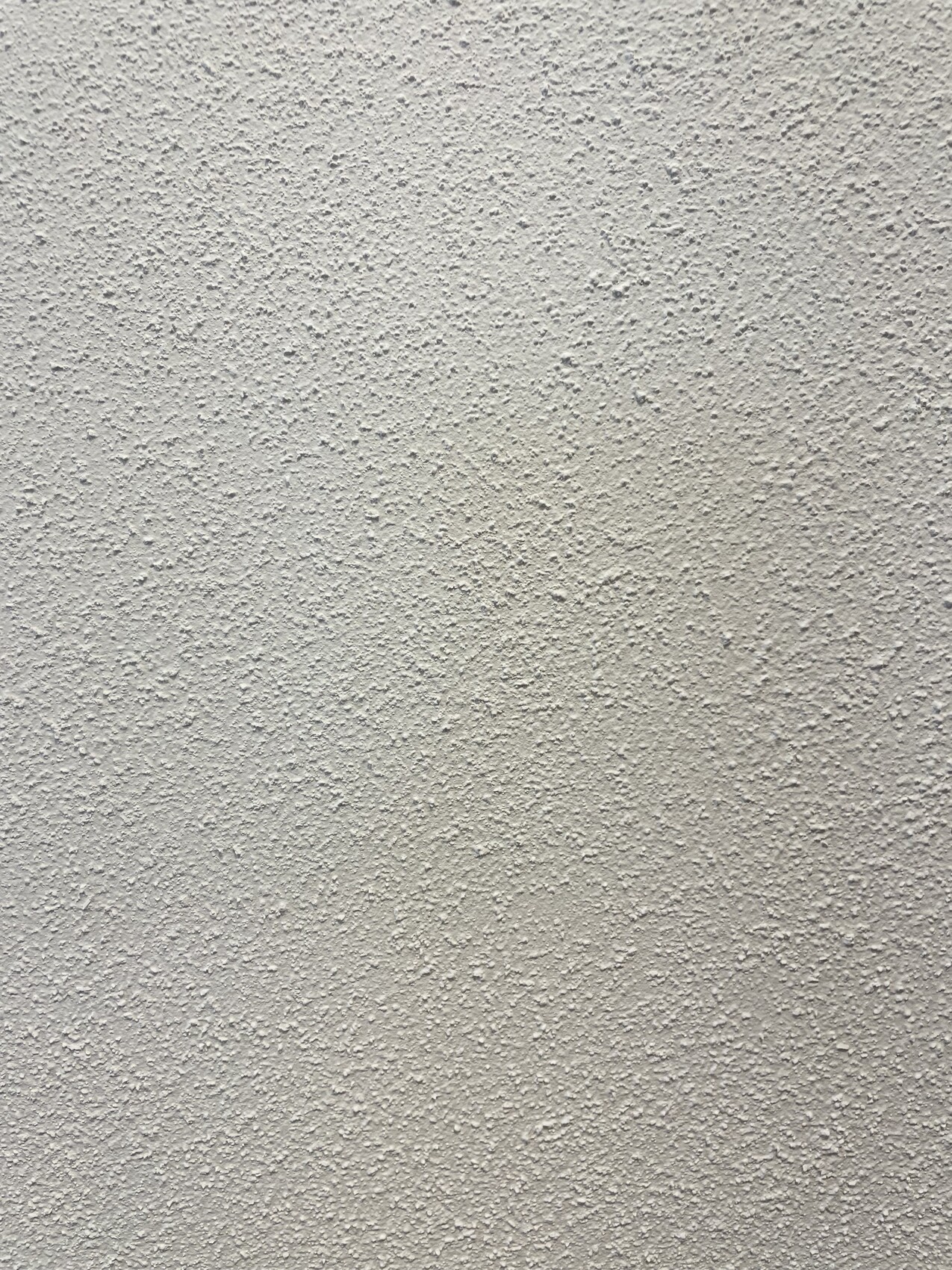

@Benutzer200 could you possibly upload one or two close-up photos of your wall? I’m having trouble visualizing it clearly.Sure – white, gray, and yellow (the colors don’t come through well in the photos), wall distance about 15cm (6 inches): Thank you! That looks great.
And did you follow the method described by Prager91?
Applying a (base) scratch coat over a Q2 plastered wall and then finishing with the quartz plaster?
Why the base coat? Because it's less expensive than applying quartz plaster twice?
And which brand did you use? Also Haering?

Benutzer2002 Mar 2022 16:15MaxiFrett schrieb:
Thanks! That looks great.
And you worked as described by Prager91? I applied two coats of Haering. I hadn’t even considered using a different base render. In my opinion, the base render needs to have a certain texture or grain; otherwise, the Haering won’t spread evenly. After just one coat, the result didn’t look good...
But I was working on an existing surface, not new construction. In the end, that doesn’t really matter. It was old plaster (which had been damaged by electrical work and then smoothed out by me). The finish level was somewhere between Q2 and Q3.
I ordered everything from the painting supply store; Haering isn’t expensive enough for me to try saving 100€. Especially since I used pigmented plaster. That requires two coats for sure. Overall, it’s probably cheaper than base render plus Haering plus paint.
