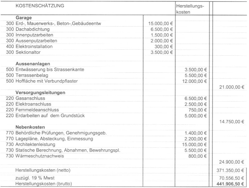

after several attempts, we have finally planned our house (1.5 stories plus basement) with dimensions of 9.5m x 12m (31 ft x 39 ft). The floor plan fully meets our expectations. Now the architect has done some costing and brought us back down to earth 😉.
Although we discussed the cost estimate, I still don’t fully understand it. Especially the items for roofing work at 15,000 EUR, drywall work on the upper floor at 9,000 EUR, and then the heating system (gas heating including chimney plus radiators in the basement and underfloor heating on the ground and upper floors) at 45,000 EUR. Oh, and the shell construction was estimated at 95,000 EUR (all net prices).
The house is planned to be built near Darmstadt. What do you think about the plan and the cost estimation for the trades?
K1300S1 Oct 2014 14:15
I can only agree with my predecessors. There are people who build a similar amount of living space without a basement for significantly more money, and while they may have a high standard, they don’t have luxury. 😉
Masipulami1 Oct 2014 14:47
I can only agree with this. The total price does not seem unrealistic to me.

My question is: How plausible are the calculations? This was already answered, though. Regarding the heating part, I apparently overlooked the sanitary fixtures, and the double scaffolding is a mistake.
Cost estimate building project with garages, outdoor facilities and utility lines

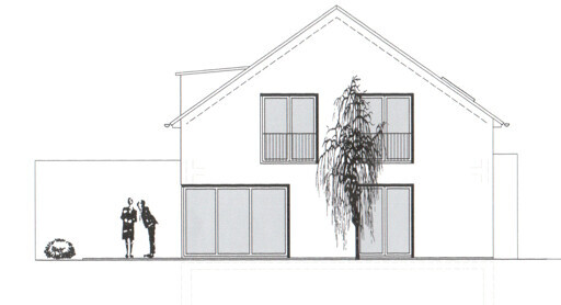

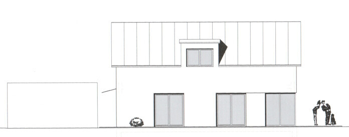

Here are the views...
Front view of a single-family house as a sketch with roof, door, and windows
Front view of a modern single-family house with garage and two slender trees
Front view of a single-family house as an architectural sketch with tree.
Architectural drawing of a modern single-family house facade with flat roof and large windows
toxicmolotof
1 Oct 2014 23:34
The architect’s fee seems too low to me according to HOAI when compared to the cost estimate. Which service phases are included there?
F
ferro
2 Oct 2014 06:53
toxicmolotow schrieb:
The architect’s fee seems too low according to HOAI in the cost estimate. Which service phases are included there?
That was negotiated with him 😉. The architect is a family friend.
