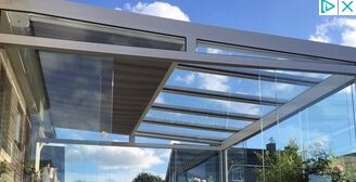

Tego12 schrieb:
You can see the sky through your windows but not through a glass roof... InterestingI think you actually don’t understand the difference.
A roof has support beams, which you can see when looking through it. No roof means no support beams.
[…] because I like to see the sky from inside. With a roof covering, that wouldn't be possible.Claiming that you can’t see the sky with a roof covering is a bit of an exaggeration…
Our canopy is made of reed mats and provides more coziness than protection.
It is also not positioned above the patio door, because I like to see the sky from inside. With a canopy, that wouldn’t be possible. You two: please read carefully – this refers to our reed mat canopy. And yes, I would also like to look outside without seeing supports everywhere. Otherwise, that’s exactly what it would be like. Look out your window and take a photo to share here. No matter how large your panoramic windows are, you won’t be looking at pure nature; somewhere there will be supports, beams, or posts.
But I don’t blame you if you don’t understand what I mean.
Some people notice numerous unnecessary traffic signs at the edge of the road, while others, when asked what they see, say: “nothing.”
The attachment comes from the displayed advertisement and illustrates the difference.

A patio roof adds tremendous value for us. Since it’s made of glass, it hardly blocks any light. With an integrated retractable awning underneath, you get excellent shading options, and especially in summer on the south side, you can keep the annoying exterior blinds up. It feels much nicer from inside. We deliberately decided against the exterior blinds.
