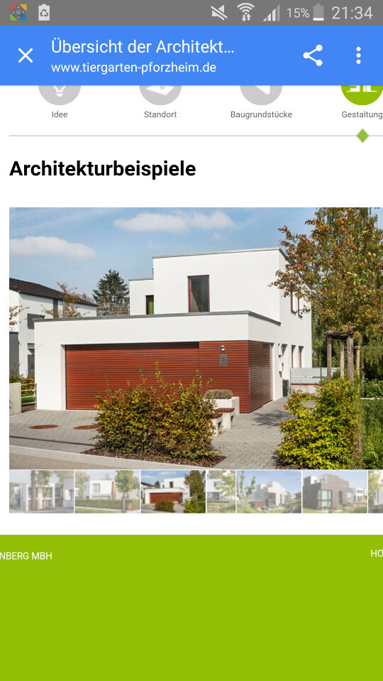

tomtom793 Oct 2016 21:39
Modern white residential house with red garage and well-maintained front garden.
Better?

Oh, I see 😀 no, not yours.
I thought TK still had an attachment because there is a stray dot there.
