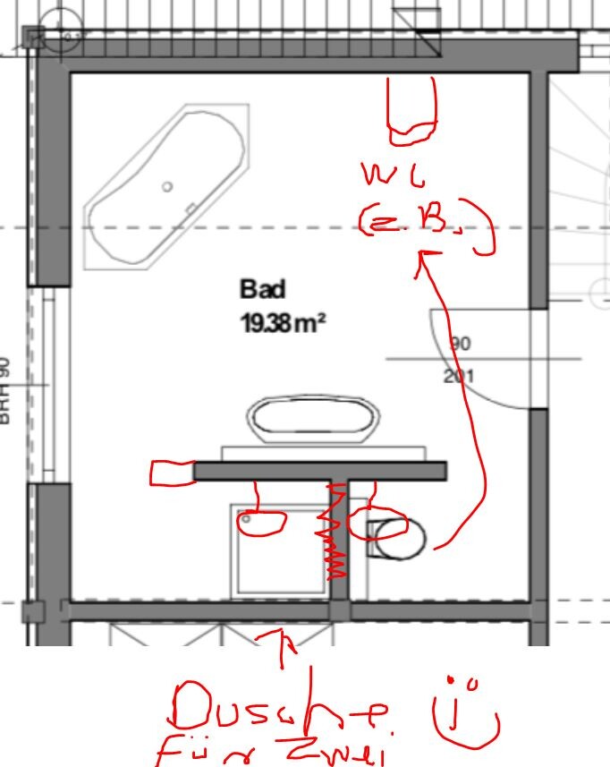

NicoStr schrieb:
...We once saw this in a bathroom showroom. Behind the washbasin, there was a large shower with two showerheads.
