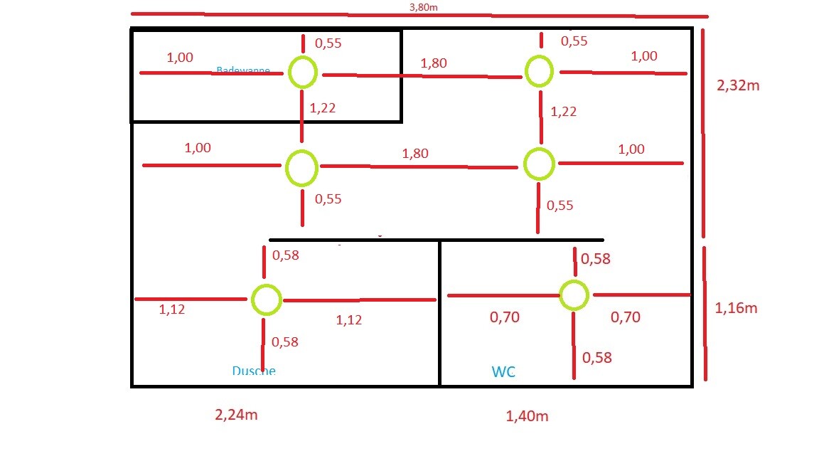

Reini12347 Jul 2019 19:23Hello everyone,
I need to finalize the planning for the recessed downlights in our new build this week. Everywhere there will be suspended drywall ceilings. I know you can calculate everything using beam angles and so on, but I don’t have the time for that. Therefore, I followed the rule of thumb of “double the distance between the spots compared to the distance from the wall” and tried to ensure the number of spots provides adequate lighting for the rooms (hallway 100 lumens, living room 200, bathroom 300 L/sqm² (30 lumens/sqft)).
Could you please take a look and let me know if anything stands out, also regarding the dimensions? The attachments are somewhat simple, but I think everything is understandable.
Kitchen:
Spots are positioned directly above the countertop to avoid shadows cast by people. There will probably be 3 pendant lamps over the island. The question here is whether the lighting will be sufficient or if I should install additional spots for the walkway between the kitchen worktop and the island?
Bathroom in a T-layout
The row of spots in the shower and toilet area should be clear. The question is whether just one row of spots near the vanity and bathtub would be enough?
Hallway:
This is a bit tricky since we have the stairway and additionally a recess in the ceiling for the attic stairs. Also, the hallway extends further at the bottom of the plan, but here the sloped roof begins. Is a 1.35m (4.4 ft) distance from the wall too much, and do I need to install more spots in the 47cm (18.5 inches) niche between the wall and the RuckZuck stairs? Is one spot sufficient for the corridor to the left of the stairs?
Living room:
Here I used two colors because the spots should be switchable separately. The outer red ring will mainly provide indirect lighting. All spots will be dimmable. Unfortunately, I can’t provide the horizontal dimensions yet because they depend on the beam spacing.
I appreciate any suggestions, criticism, or feedback.

hampshire10 Jul 2019 21:43Sorry, it is hardly possible to evaluate a mounting location without knowing the fixtures being used. Diameter, luminous flux, luminous intensity, beam angle, color temperature, CRI, control method... Of course, you can use these mounting locations. Whether it will work out or not also depends on other parameters.
In any case, make sure to plan for space on both sides of the countertop in the kitchen.
In the bathroom, I would only use two rows of three lights each. Two rows in the shower area below and one by the toilet. Then place the other row of three centered between the exterior wall and the T-wall.

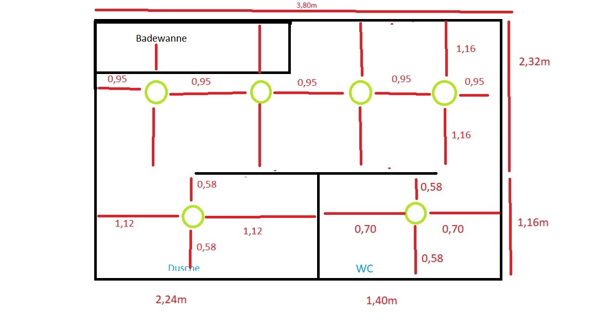

Reini123411 Jul 2019 23:52danixf schrieb:
In the bathroom, I would only use two rows of three. Two below in the shower area and one near the toilet. Then, place the other row of three centered between the exterior wall and the T-wall.I have two other versions here. Do you think one row in the bathtub area would be enough?
Grantlhaua12 Jul 2019 07:40Have you already completed the bathroom design with furniture, fixtures, and so on? In the end, we completely changed the bathroom layout and then had a huge problem with the spotlights...
