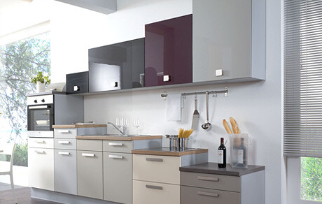

This is how it turned out now. The refrigerator cabinet will still be made lower.
Unfortunately, I forgot to buy the side panels. The IKEA planner didn’t notice either. Without them, the front doesn’t look that good, I think.
And of course, I have one more question:
When installing the countertop - for example, at the sink - should it overhang on the right and left sides, be flush (then it would fit exactly), or is that a matter of personal preference?
Best regards, Jürgen.
