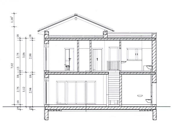

Bauexperte10 Jul 2012 12:13Hello,
I have attached a cross-section so you can better visualize my previous answer. If you raise the hip roof side by 1.0 m (3 feet 3 inches) using a knee wall, you will achieve the required 8.0 m (26 feet) eaves height. The area can only be used as storage space, but this makes sense for building permit / planning permission purposes.
Brasilianer schrieb:
Does anyone have an idea how to avoid a third floor and still reach the required minimum eaves height of 8.0 m (26 feet)?
