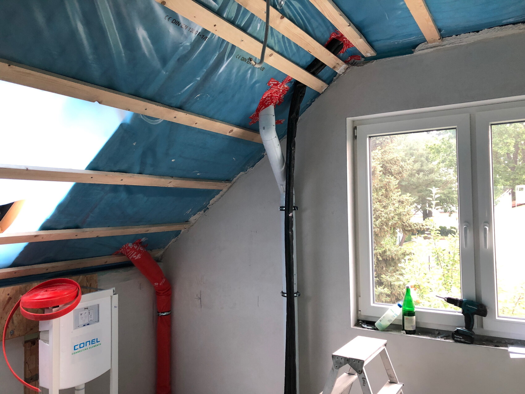

Haha, okay, it almost looks like it was meant to be that way. It’s surprising how quickly you get used to something like this. Looking at it more closely now, it was quite a blunder. I’m not sure if I would let it slide again with the knowledge I have today. Well, it’s just a guest bathroom...
Then the fool who planned this should redo the ceiling opening and have the pipe go through the exterior wall already on the ground floor, then run it up in front of the roof overhang. Unfortunately, finishing it in the attic isn’t possible because it would be in the reveal area. But redirecting it with three bends is simply not appropriate for a new build aesthetically.I agree with you on the latter ☺️We had also considered leading it outside already on the ground floor, which would give us an external chimney, though that wouldn’t look very nice either. But of course, it is an option.
By reveal area, do you mean that it’s too close to the upstairs window? The distance is about 30 cm (12 inches) to the reveal.

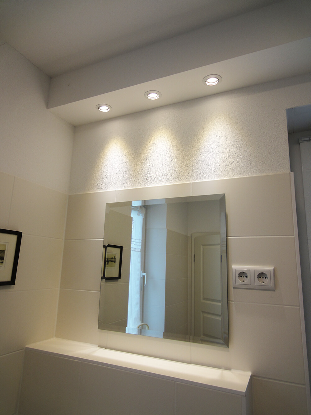

kaho674 schrieb:
Haha, okay, it almost looks like it was meant to be that way. It’s surprising how quickly you get used to something like that. Looking at it more closely now, it was quite a noticeable mistake. I’m not sure I would let that slip again with the knowledge I have today. Well, it’s just a guest restroom... It really looks good and exactly as intended! I could also imagine it like this above my washbasin.Here are some recent photos from today.

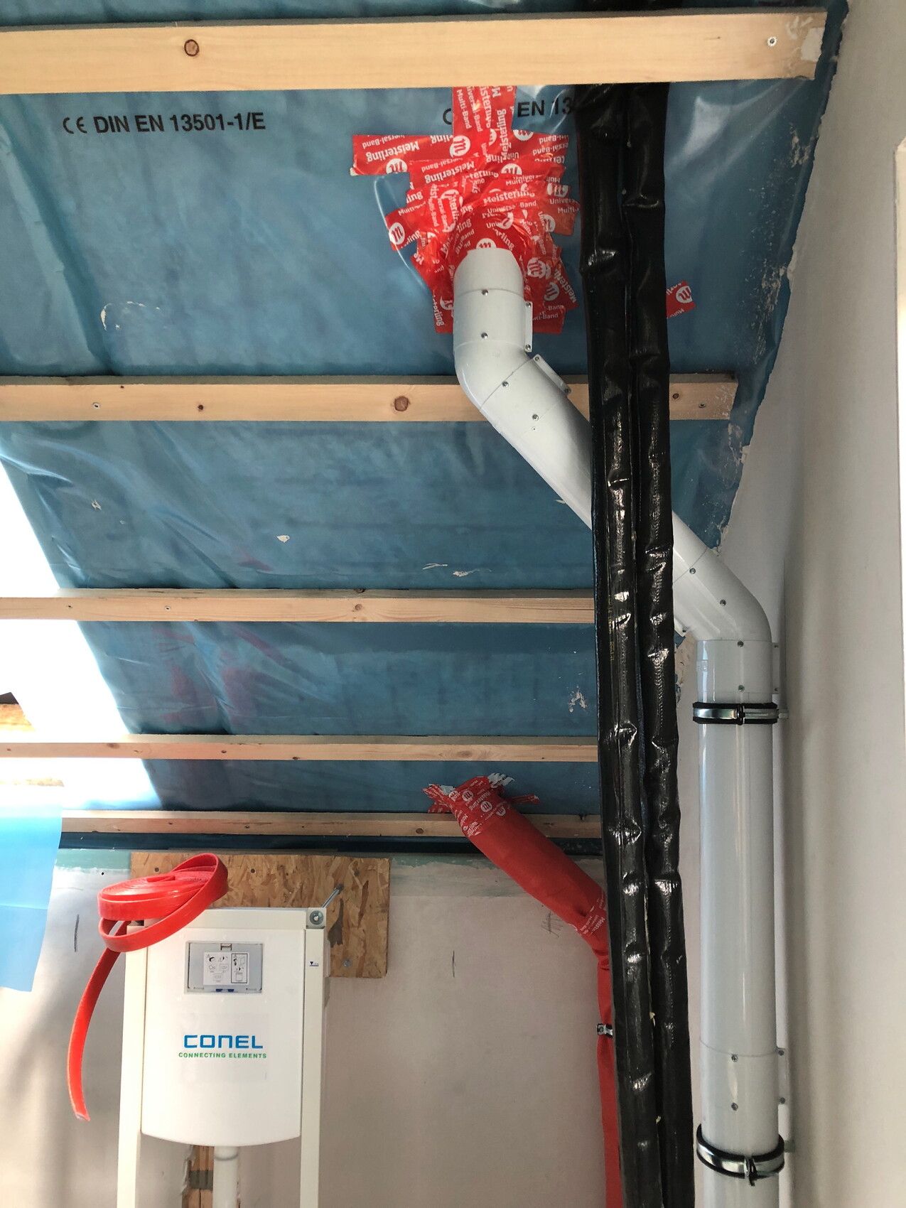

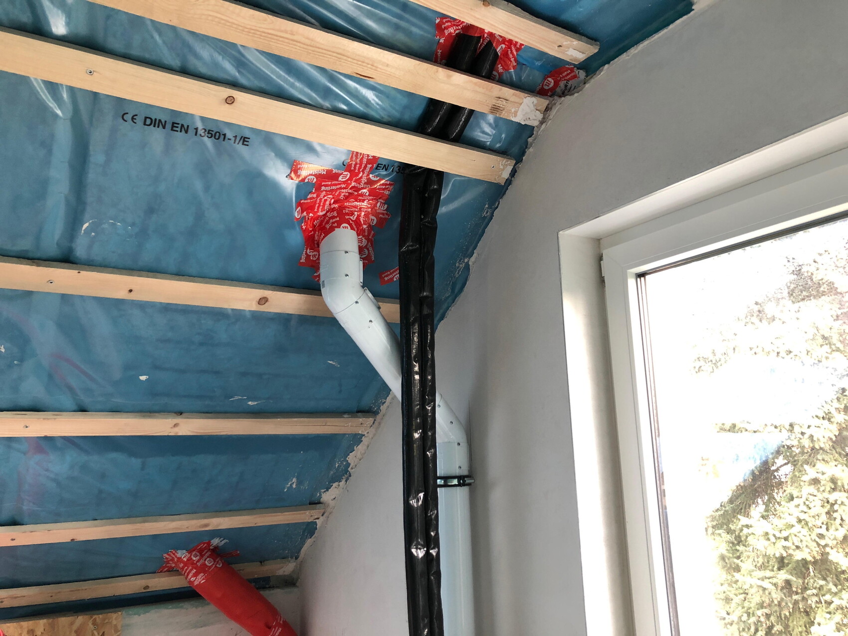

The boxing for the entire exhaust pipe (including the offset) will be about 50cm (20 inches) long!
There were also ideas to box only the part along the wall and then separately box the offset, but the plumber and I don’t think that would look better with another corner in the middle.
The toilet is now positioned according to this boxing, so it has moved fairly close to the bathtub.
Unfortunately, I haven’t been able to reach anyone at the housebuilding company yet, but I don’t think the situation will change anymore.
The offset is technically necessary, and repositioning the pipe probably should have been addressed much earlier.

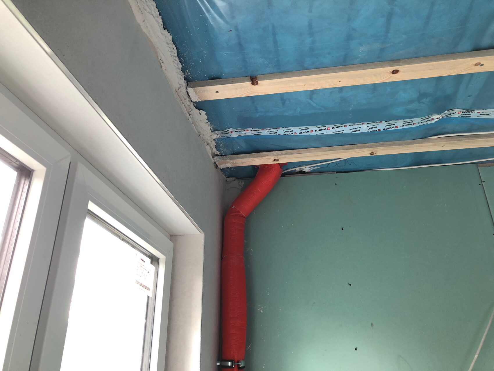

chrisw81 schrieb:
By "reveal area," do you mean that it’s too close to the upstairs window? The distance is about 30 cm (12 inches) to the reveal. In the drawing in post #1, I had confused the casing for the photovoltaic conduit and the exhaust pipe; the first one couldn’t pass through here because the higher-density bricks of the reveal are in front, which are needed due to the lintel bearing. It would still be possible, but more complicated.

but the plumber and I don’t think it would look better with another corner added. Yes, that can hardly be improved. Absolutely fantastic, as the chairperson would say during carnival.
Yes, it hardly gets any better than that. As a session president might say during Carnival season: wonderful, simply wonderful. Of course, you can also take it with humor. But it is still a pity for a new build that it looks like this. I knew all along that a cladding would be added, but I blindly trusted the planners or simply didn’t pay much attention to it. Now I’m annoyed with myself. I have to live with it for the coming years.
