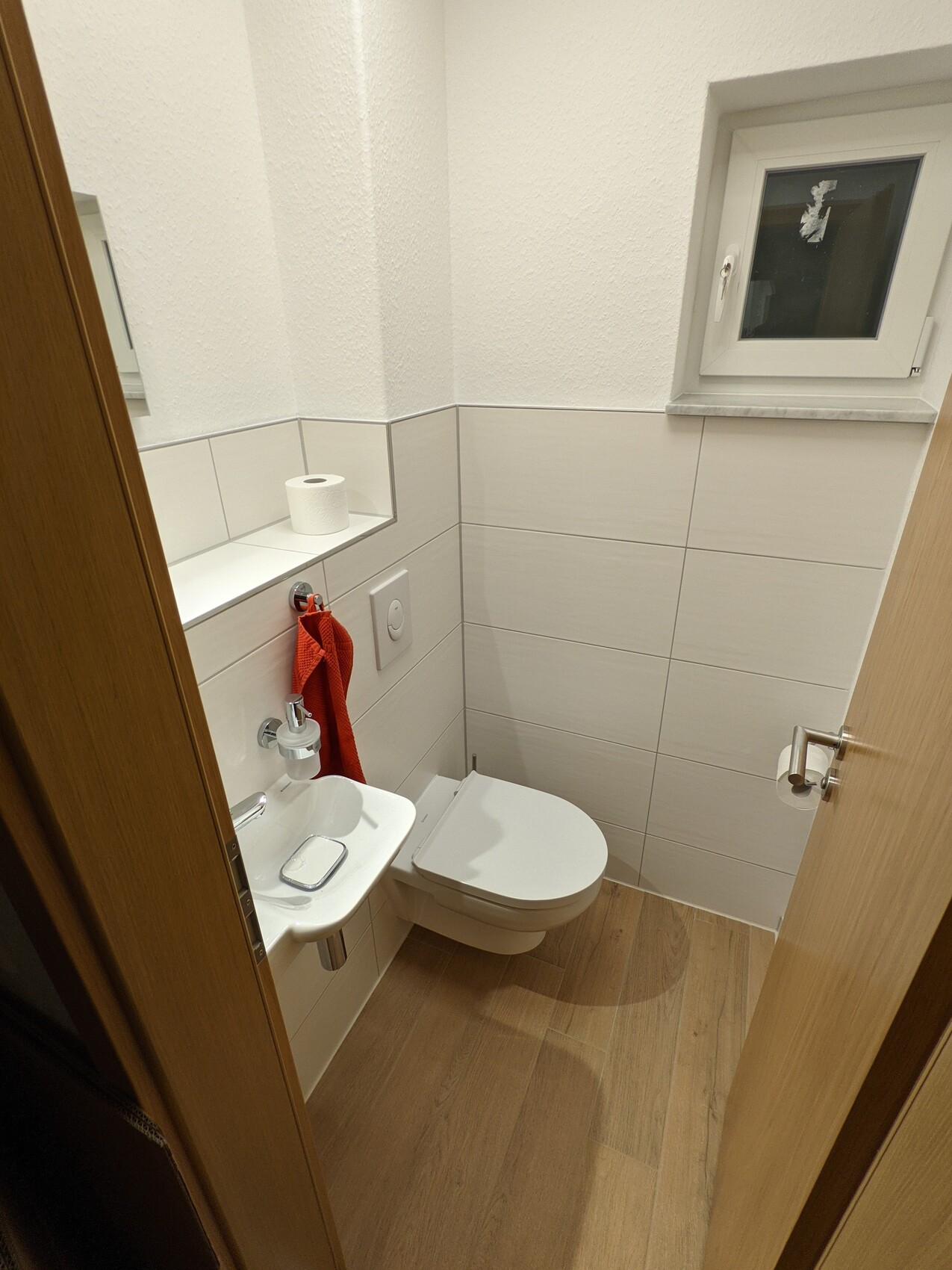

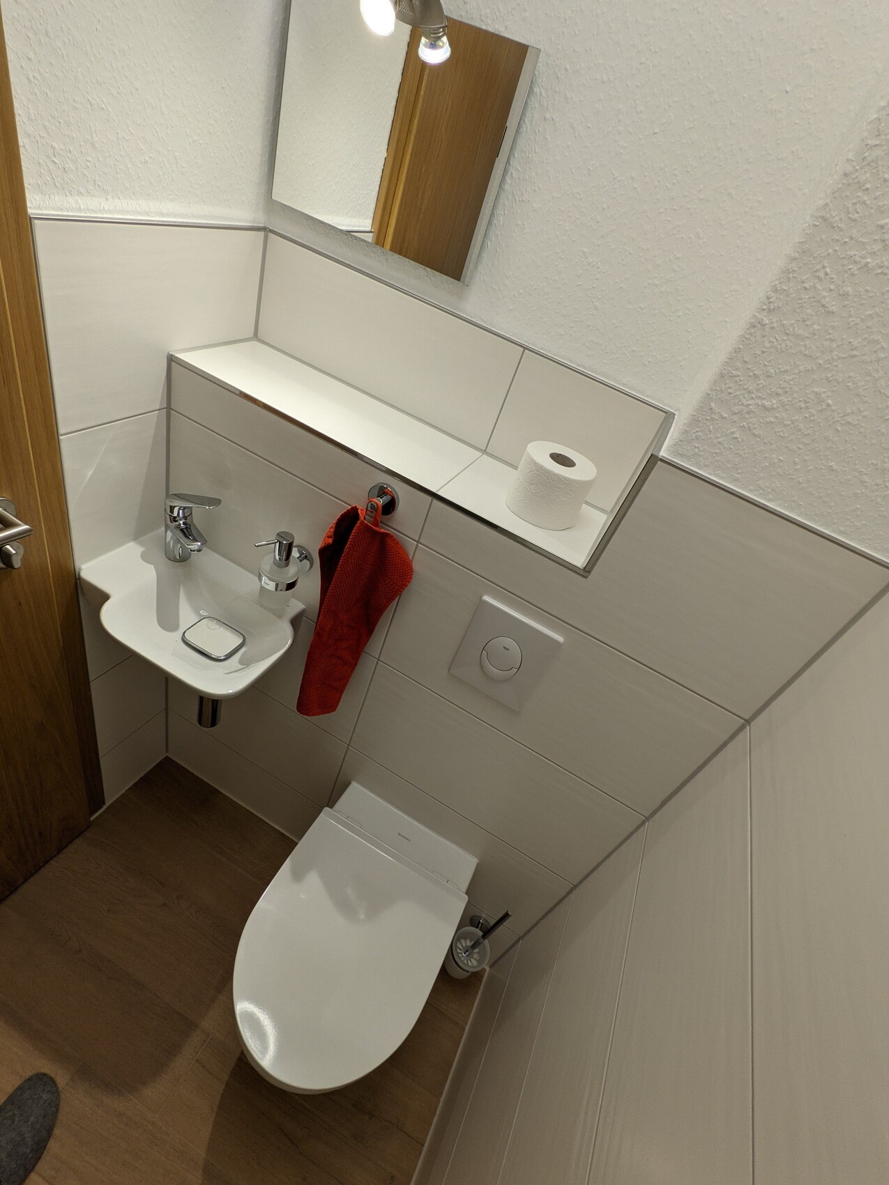

Hello house building forum,
we are currently planning a semi-detached house. The building plot is very small, and the footprint is accordingly limited. To achieve a reasonably usable living area, we want to keep non-living spaces small and allocate the saved space to the living rooms.
On the ground floor, we are planning a guest toilet without a shower—that is, only a toilet and a washbasin. Recently, I have been carrying a laser measuring device when visiting friends and have measured several guest toilets. Conclusion: 1 meter (3.3 feet) in width and 2 meters (6.6 feet) in length are more than sufficient. In our case, the door would be on the short wall, the toilet opposite the door, and the washbasin on the long wall.
We are currently looking for a builder and have roughly presented our plans. One potential builder mentioned that according to the DIN standard, a guest toilet must be at least 1.24 meters (4 feet) wide.
My online research so far hasn’t been enough to find the relevant regulation or DIN. The DIN 18022 on bathroom planning appears to have been withdrawn without replacement.
Is anyone familiar with this requirement? Is it not allowed to plan a 1 meter (3.3 feet) wide guest toilet in a new build?
