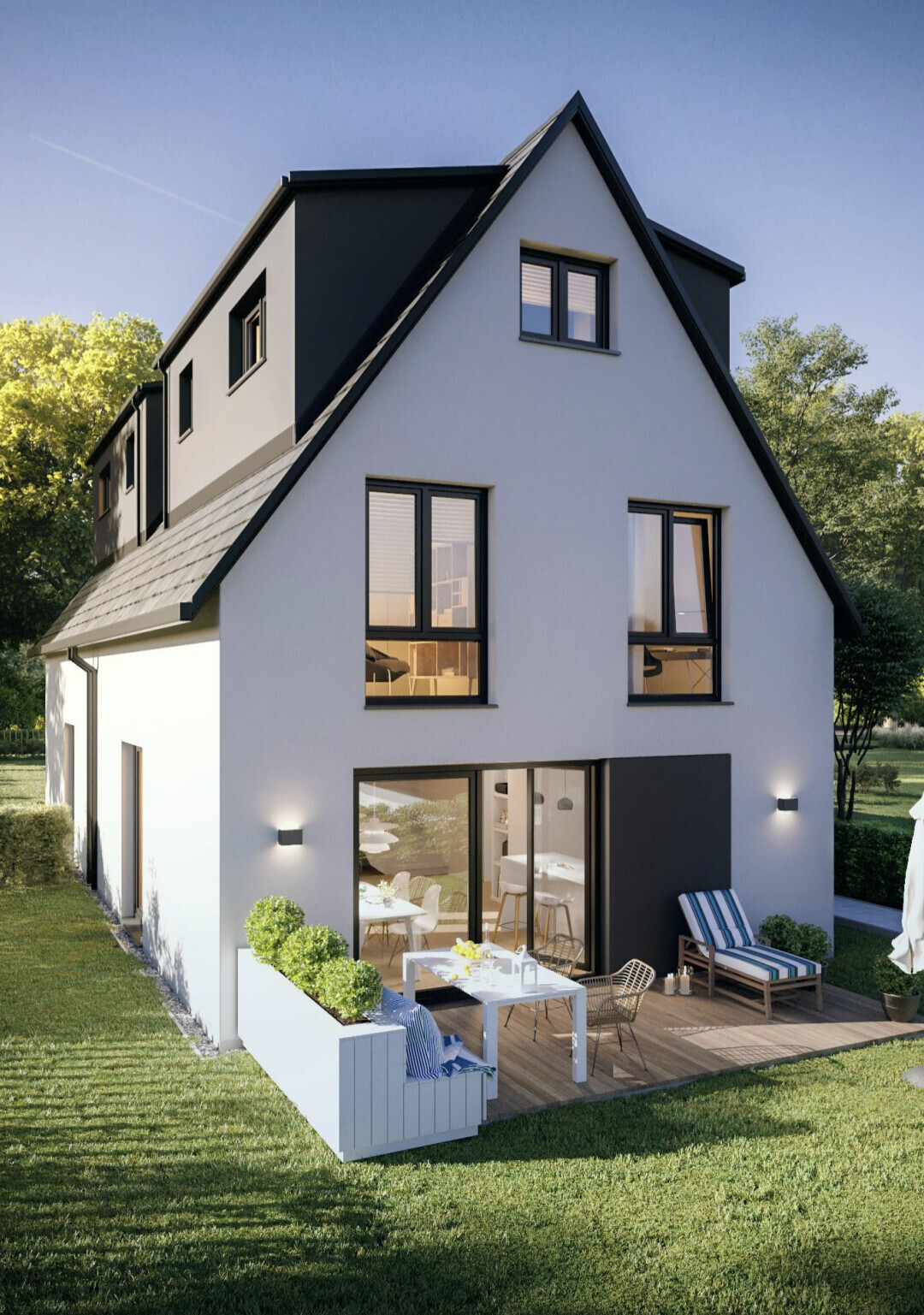

Here is an example from a construction project in Hamburg two years ago. The house is completed by now. On a similar footprint to ours, they cleverly maximized the living space. Especially the two dormers turned a narrow attic into a very usable room.
Our design won’t be quite that dormer-heavy. But it can definitely serve as inspiration for our situation.
Sunshine38713 Dec 2022 21:30Visually not a standout (based on your picture), but if I were in your position, I would also plan with dormers, as the dormers can significantly enhance the sense of space, especially given the limited area.
