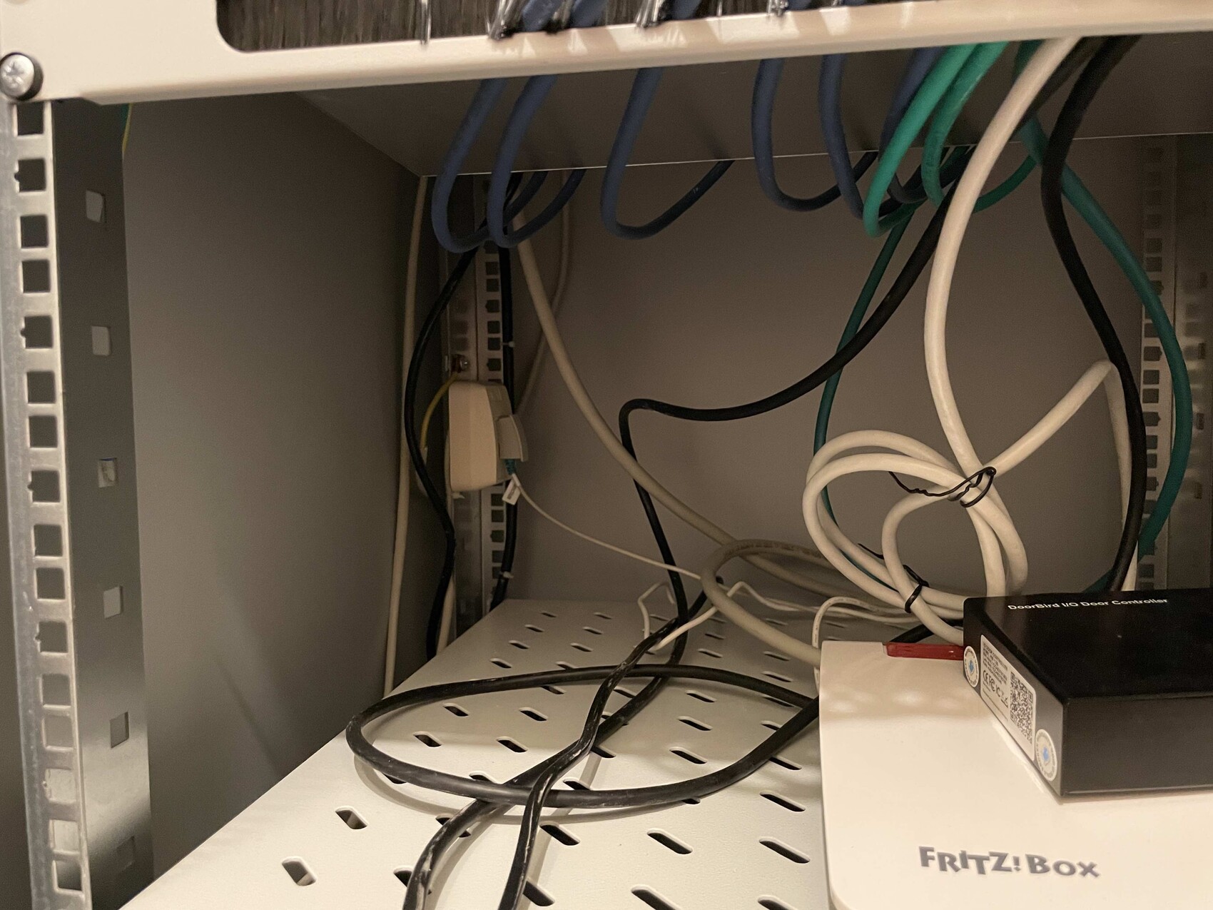

Why is that? You will probably receive a TAE socket from the telecom provider, which is the termination point for the incoming line from outside. Then, connect the Fritz cable (TAE to RJ45) to it, and from there either use a coupler or a small patch panel to connect to your home wiring (RJ45 to RJ45) leading to the patch panel where the rest is located. From the patch panel, use a standard Cat patch cable to connect directly to the DSL port of the FritzBox.

fromthisplace13 Jun 2022 13:30So, the shell construction inspection with the electrician is done. It actually went quite well.
For him, installing and equipping the network cabinet is not a problem. However, he said he would prefer to provide the patch panel himself to ensure his keystone jacks fit properly. For the house entry point, he will install a TAE socket in the network cabinet, just like @MBPassion (I had your photos as a reference 🙂 ).
He said he would be installing Cat 6 or 7 cable. Here, I specifically insisted that it should be at least Cat 7.
All in all, I’m feeling optimistic.
