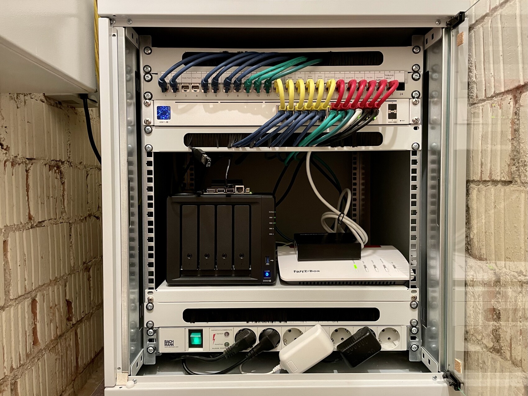

I want to model my network cabinet after MBPassion’s great setup. He/she also has the Fritzbox inside the server cabinet (with Wi-Fi disabled for technical reasons. See quote
MBPassion schrieb:
A total of 23 installation cables run to a patch panel in a small storage room in the basement. There is also a 19-inch (19") network cabinet where I consolidate the rest of the infrastructure:
  • 24-port PoE switch (Unifi USW-Pro-24-POE)
  • A Fritzbox (Wi-Fi disabled)
  • A NAS
  • A Doorbird I/O controller
  • (sometimes a Raspberry Pi or Jetson Nano) 🙂
We now have a Unifi Access Point nanoHD on each floor and are very satisfied with it. We no longer need the Fritzbox Wi-Fi and have disabled it.
The DECT signal from the Fritzbox for the phone actually covers from the basement server cabinet up to the attic. Of course, you could also use a DECT base station in a central location, like the Gigaset Pro N670 IP DECT for about 100 euros. (Other alternatives would have been to extend the DSL signal over an installation cable and then reconnect it to the network via a second cable; have the electrician place the TAE socket directly on the ground floor; use a DECT repeater; or install a second Fritzbox.)
I think I have found the answer: the Fritzbox DECT signal for the phone covers 1–2 floors, so having a handset with a network connection on the upper floor is sufficient, right, @MBPassion?
