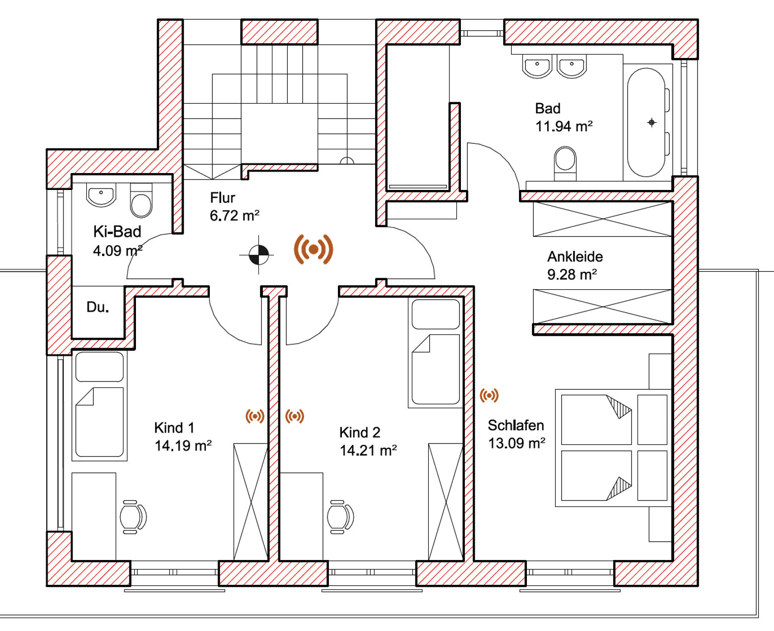

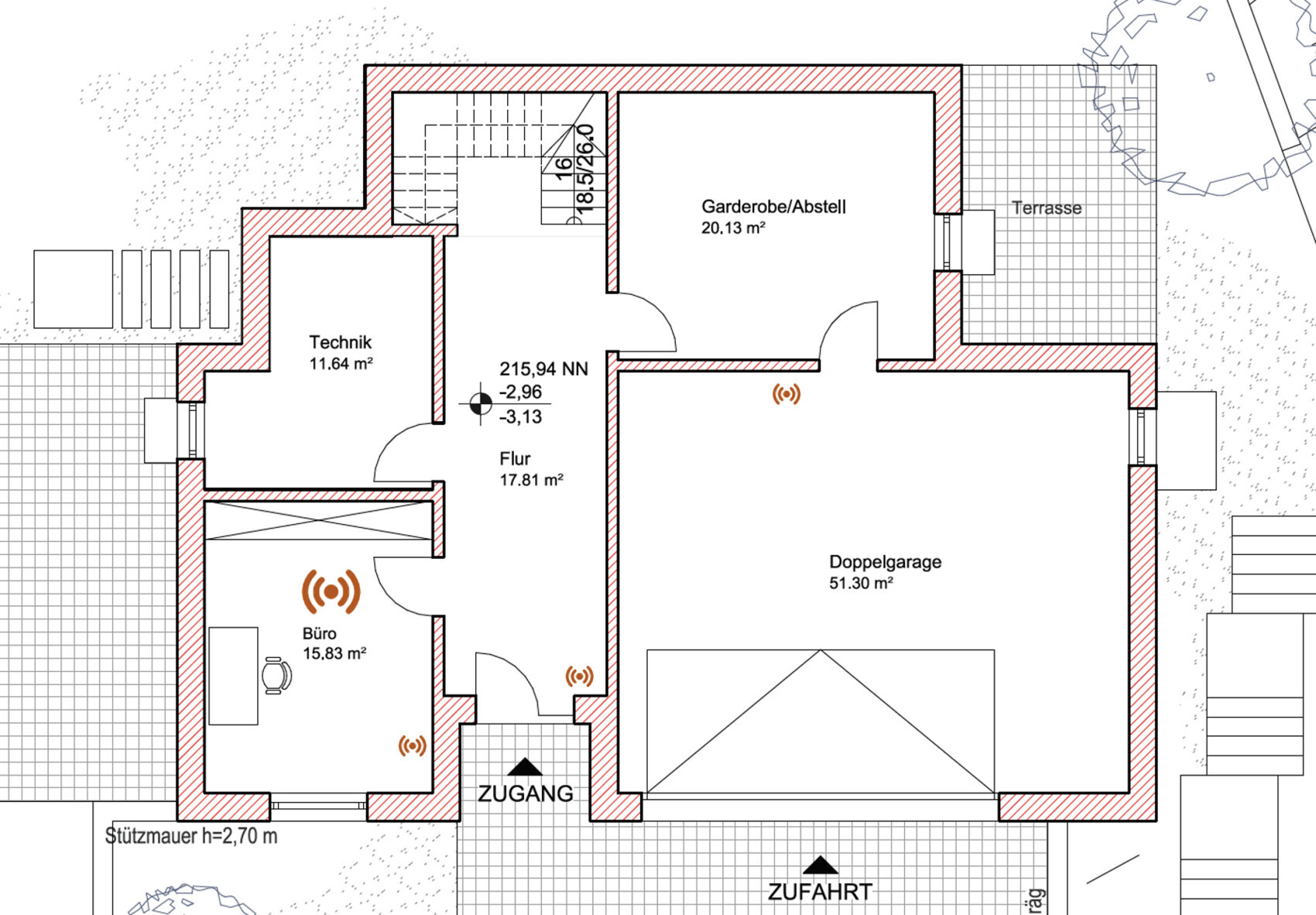

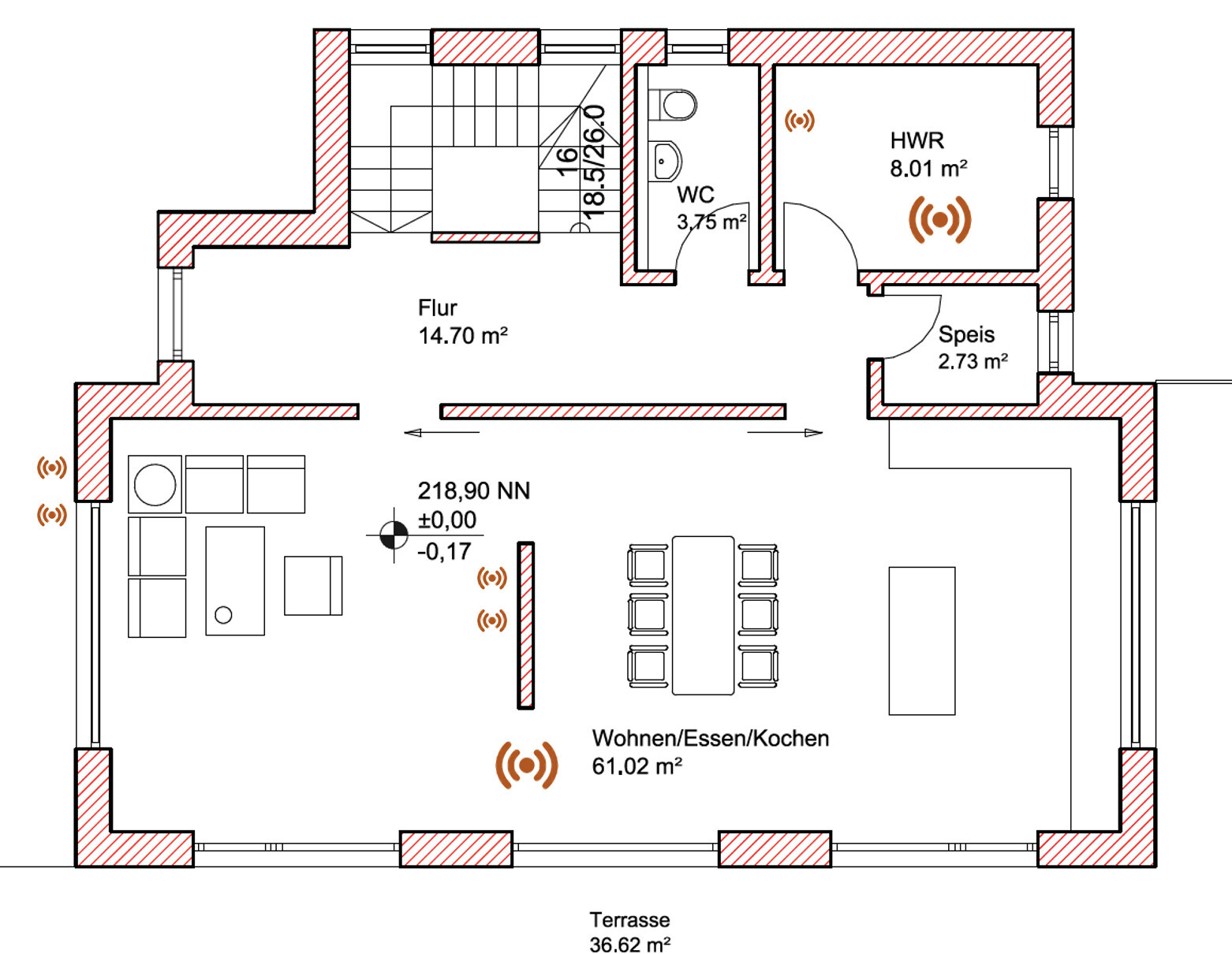

3 Jan 2022 18:16
Here is our network distribution. Generally, we have initially planned only one connection per room and no double outlets. You would probably position a second LAN connection in the flexible rooms (office, utility room, children’s rooms 1 and 2) at a different location, right?
Before I ask a few more detailed questions: What would you change? Where is something missing or where could we save a socket? For each room, we are also planning a satellite connection. Our viewing habits are approximately 50% linear TV and 50% streaming.
Basement
- Access point in the office (large symbol)
- 1x doorbell, 1x garage/wallbox, 1x office (later possibly children’s room?)

Ground Floor
- Access points in the utility room and living area (as suggested by you), 3rd access point outside next to the LAN outlet for the awning/shading
- 1x utility room, 2x exposed concrete walls for TV, 1x outside for awning/shading
Floor plan of an apartment with hallway, WC, utility room, pantry, living/dining/kitchen area, and terrace.
Upper Floor
- 1x access point in the hallway
- 1x children’s room 1, 1x children’s room 2, 1x master bedroom
Floor plan of a residential house: hallway, children’s bathroom, bathroom, master bedroom, children’s rooms 1 and 2; red walls.

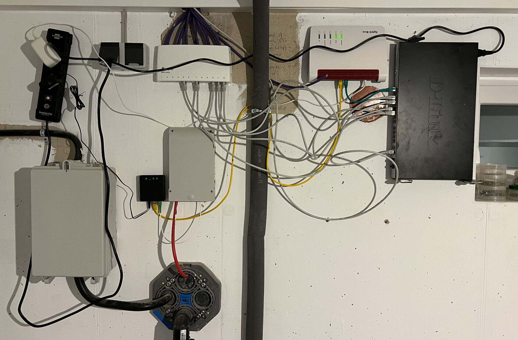

OWLer3 Jan 2022 19:16
majuhenema schrieb:
having to hope for a competent electrician
When unmotivated electricians meet unmotivated builders, this is what you get. He was skilled, just unmotivated when it came to the network. It really annoys me that everything is just hanging around there, especially since I look at the keystone jacks almost every day, which I want to fix.
That’s why: insist that electricians terminate the CAT cables into keystone jacks with enough cable slack at a proper free location (!) and then take matters into your own hands by tidying everything up neatly in a 19" rack yourself.
