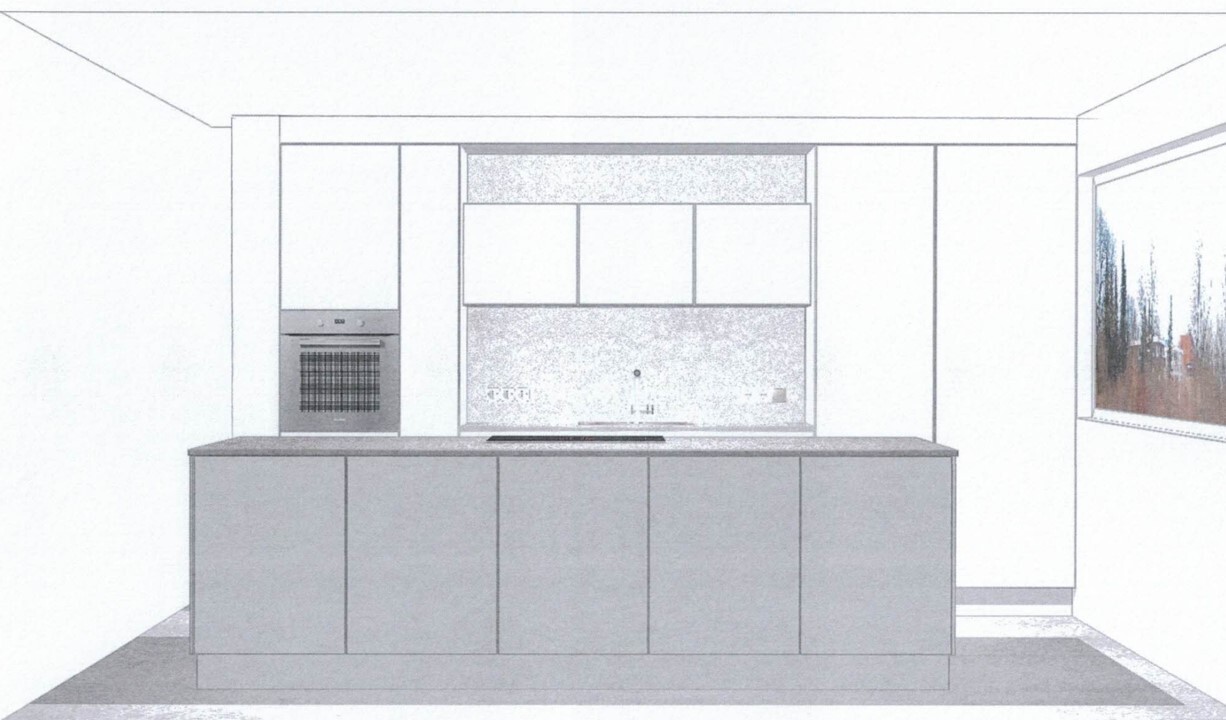

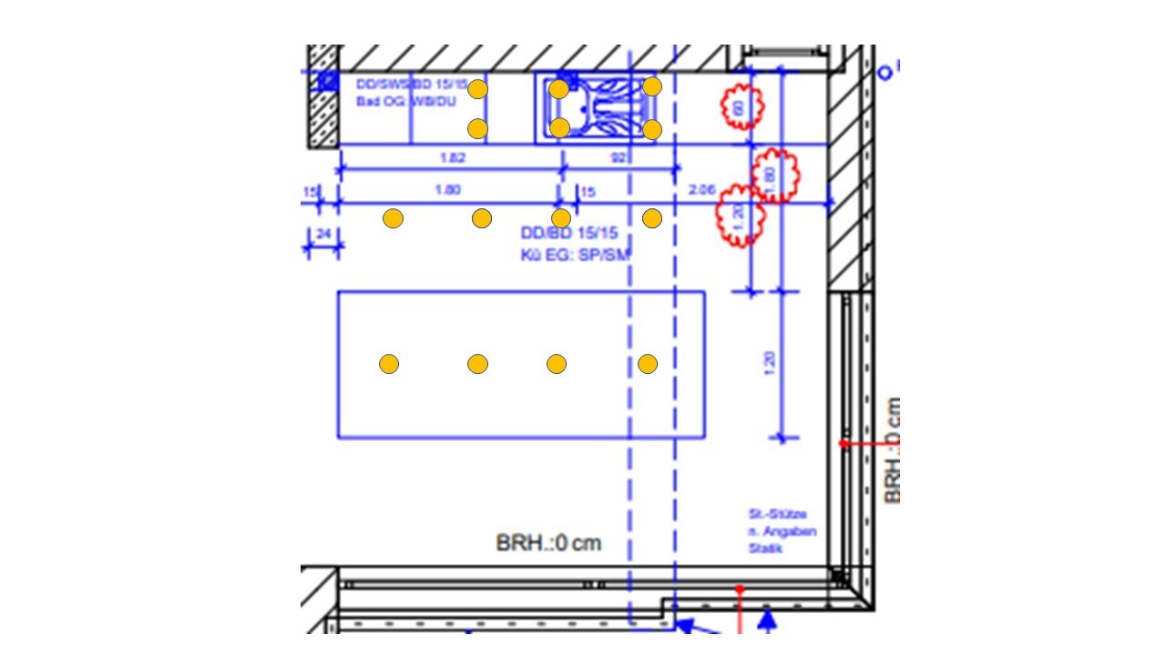

We have now reached the stage in the detailed planning where only the positioning of the ceiling spotlights needs to be finalized. Halox ceiling junction boxes 180 will be installed in the precast concrete ceilings. We are a bit uncertain about the kitchen lighting.
We are planning a 4m (13 feet) kitchen run that includes a niche 1.80m (5 feet 11 inches) wide with wall cabinets. LED spotlights are planned for the underside of the wall cabinets, which should provide sufficient lighting for the work surface. In front of the kitchen run, there is a kitchen island positioned 1.20m (4 feet) away, measuring 3.00m (10 feet) wide and approximately 1.20m (4 feet) deep.
Our idea now is to install 8 spotlights above the kitchen island (two rows of four spots, spaced 60cm (24 inches) apart). For better visualization, I have attached a picture. In your opinion, is this sufficient for the overall kitchen lighting, or should additional spotlights be planned, especially in the walkway between the kitchen run and the island?
Since the cost per spotlight—including drilling, materials, and installation—is about €250 each (installation of the junction boxes alone is around €120 gross), we naturally want to keep the number to a minimum. We are completely open regarding the choice of recessed spotlights (beam angle, etc.)...

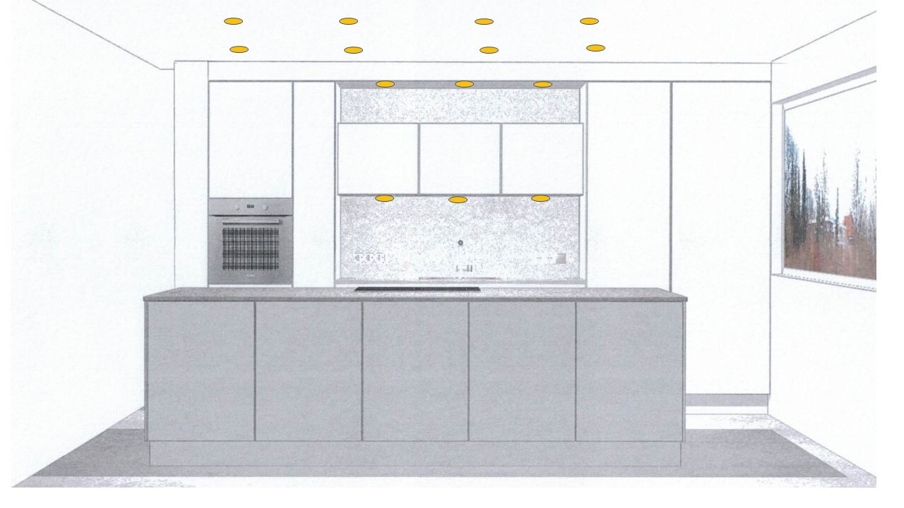

Thank you for the feedback. I have attached another 3D image of the kitchen, with the difference that on the right side there are floor-to-ceiling windows, and behind the line of sight there is also a full wall with floor-to-ceiling windows.
The preference is leaning towards two rows of four units each: one above the island and one row over the walkway between the island and the main kitchen run. We would not directly illuminate the walkways by the windows. To the left, the space transitions into the dining area.
We do not like pendant lights above the island. We specifically chose a downdraft extractor to avoid having anything overhead. In that case, it would make no sense to install a light above it instead.

Mmh... it always depends on how “bright” you prefer it.
How would you distribute the lighting between the ceiling and the island?
There are not only pendant lights but also surface-mounted lights, among others. Of course, it’s a matter of personal taste.
I personally like having different light sources.
If you’re sticking with recessed lights, I’d consider distributing them more evenly. Or at least make sure they don’t have narrow beam angles. It can get quite dark when you’re looking for something inside the front cabinets of the island if all the light sources are positioned mostly “behind” it. (This naturally depends a lot on the type of recessed lights used).

LED panels definitely offer savings potential, but I haven’t found them very attractive for kitchens so far. Do you have any pictures of those? Why not in front of the windows? I don’t understand your plan. Why are there spotlights above the wall cabinets over the sink? To highlight a vase collection?
Myrna_Loy schrieb:
Why not in front of the windows? I don’t understand your design. Why are there spotlights above the upper cabinets over the sink? To light a vase collection? The area in front of the windows is not a walkway. So, the room’s general lighting is sufficient there. The upper cabinets are less deep than the tall cabinets, as shown in the 3D view. These optional spotlights could serve as accent lighting to highlight the niche and also increase the overall illumination. However, they can probably be omitted most easily.
