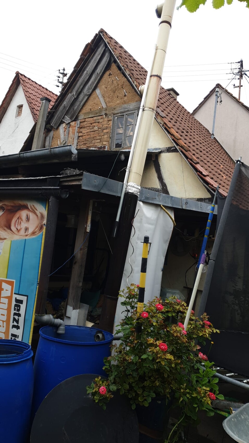

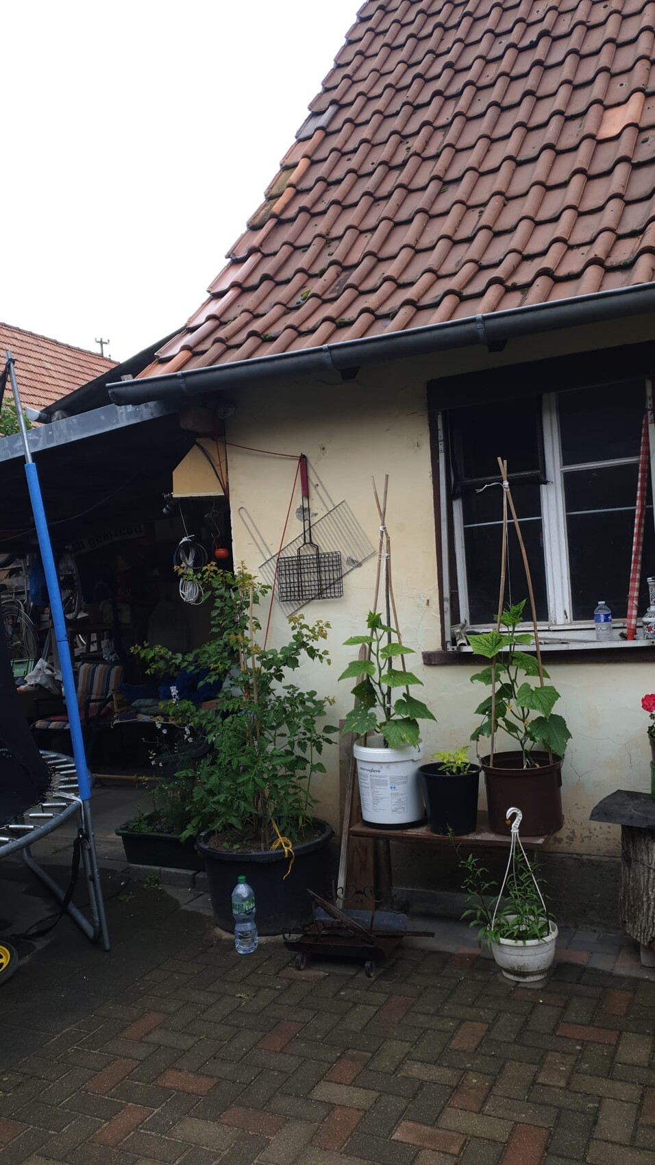

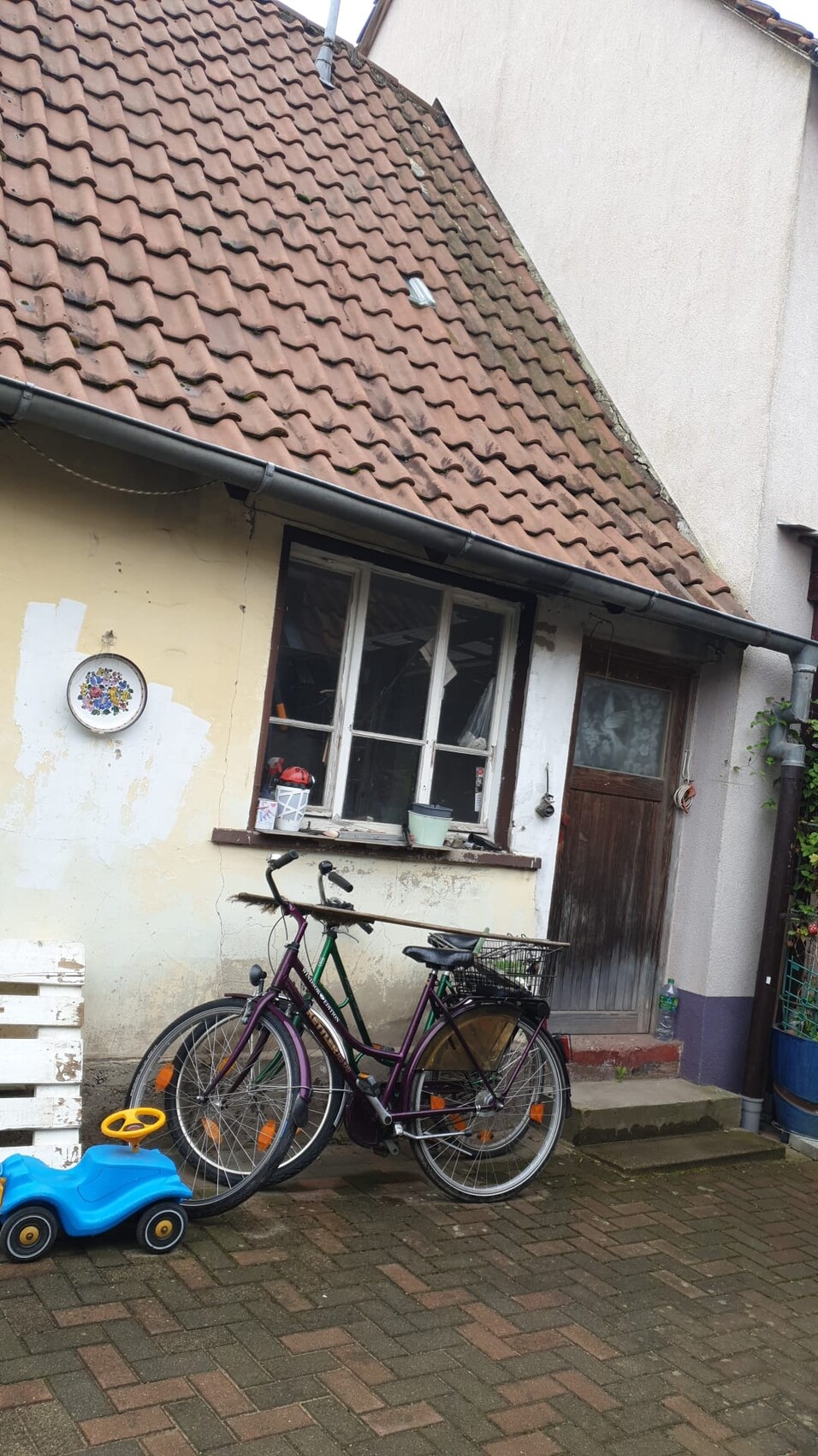

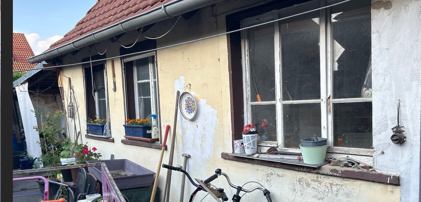

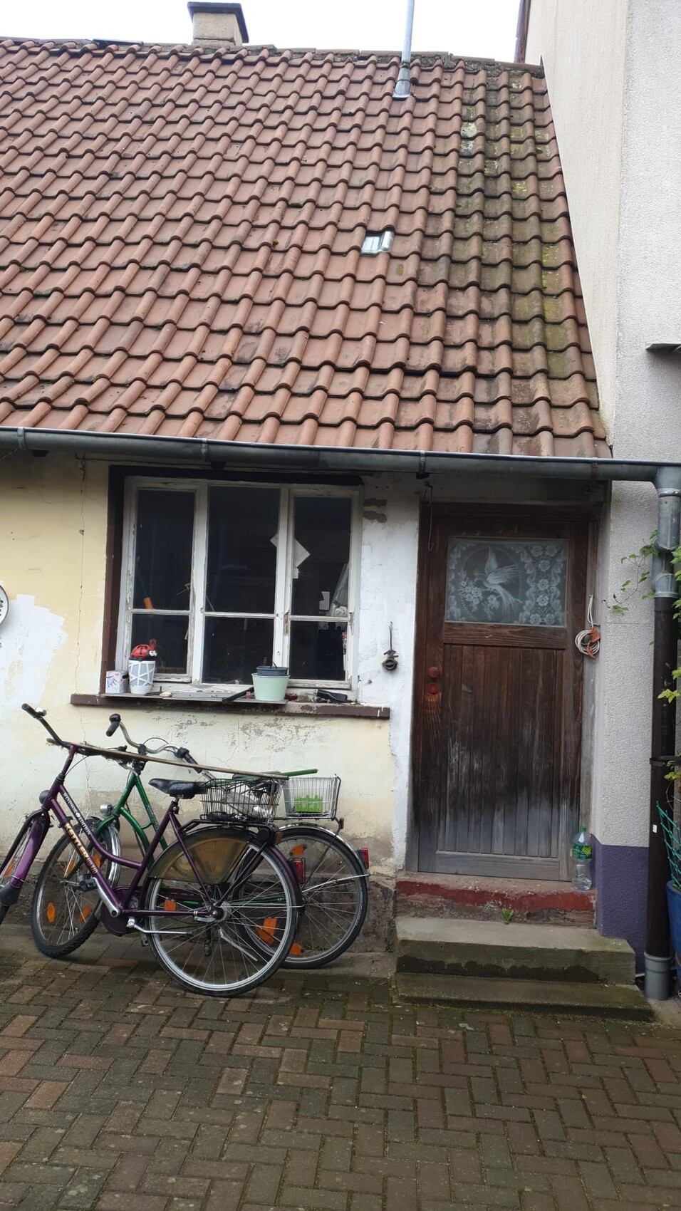

Hello dear community,
I have tried to read through the posts here and was able to understand quite a bit. Now I want to share my planning with you to possibly correct any misjudgments or mistakes on my part.

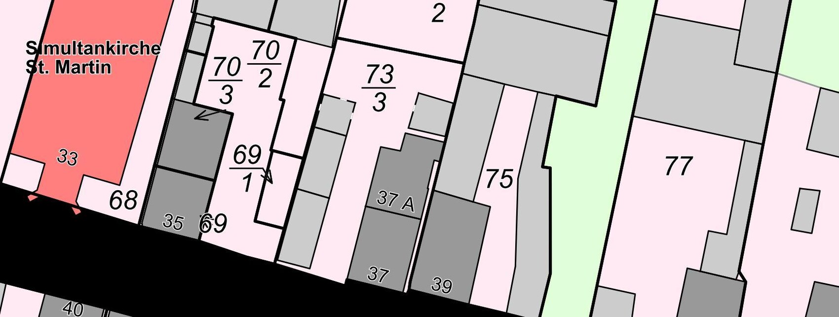

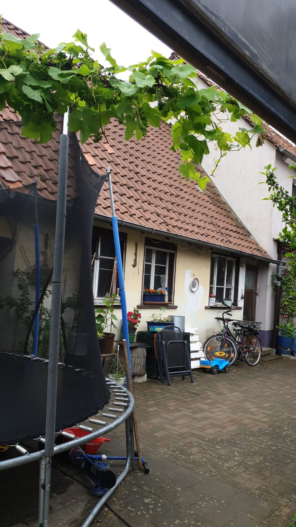

I am a 33-year-old married man with two children, currently renting in Baden-Württemberg. My parents own a plot of land in a small village in Rhineland-Palatinate. Now I am considering building a small wooden house there using a prefab wooden house manufacturer. Currently, there is an old building on the plot, parcel 37A. At first, the idea was to renovate it and make it habitable again. When I called the craftsmen, each of them said it wasn’t worth it; even the energy consultant advised against it. Since I am not a professional in this field, I took their assessments seriously and am now thinking about demolishing the old building and constructing a wooden house instead. The old building previously had a water supply and still has an electricity connection. The water supply was cut off by my father due to the risk of water damage.
The old building measures 6.50 meters (21 feet) in width and 9.50 meters (31 feet) in length.
The plan is for a prefab wooden house with a smaller footprint to simplify the building permit / planning permission process or to avoid complications with larger structures.
I am open to any criticism or questions.
I have also included a rough cost estimate.
If I have forgotten any cost items or if any cost items seem unrealistically priced, I would appreciate your experience-based feedback.
Many thanks,
Your layman

Großes Trampolin mit Netz im Hinterhof, daneben Spielzeug, Fahrräder und Topfpflanzen vor dem Haus.
