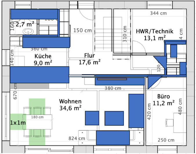

Schmirgel schrieb:
I think the children's rooms are a bit too large to furnish efficiently. ... To save space in the ground floor hallway, the office could be made accessible from the living room, allowing the hallway to be shortened in favor of the office and utility room. The furnishing is still open for discussion; we should take a closer look. However, I have no doubt that we can fill the rooms fully. 🙂 A direct connection between the office and living room was rejected outright 😉

Papierturm schrieb:
You enter and see a half wall leading to the semi-open living area. At first, we didn’t think it was that bad. After the simple 3D rendering from our design software, we still thought so. But when we recreated the drawing from @hanghaus2023, the closed version convinced us. If something like this is implemented with loft doors or similar, it probably looks much, much better than a half wall you walk towards.

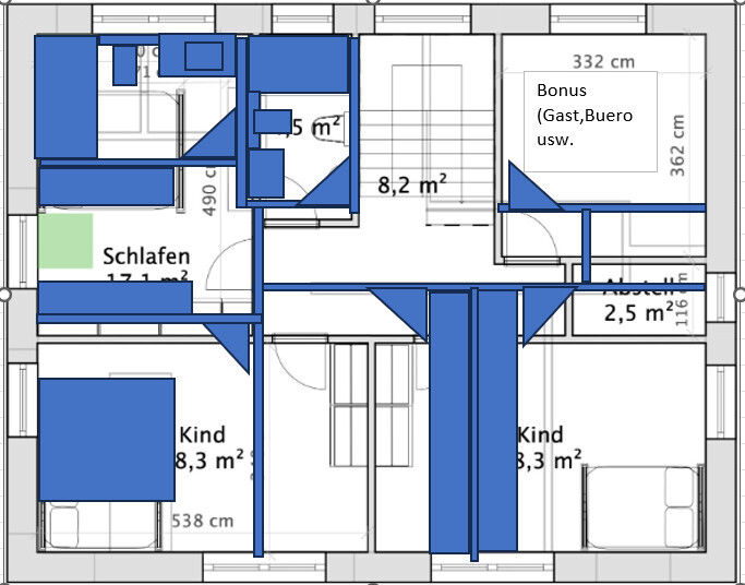

hanghaus2023 schrieb:
I tidied up the upper floor. Nobody needs a 15m² (161ft²) bathroom, and it’s extremely expensive. Where do you get 15m² (161ft²) from? The drawing only shows 12m² (129ft²) for the main bathroom. I haven’t recreated your upper floor plan yet to see the exact dimensions, but honestly, we don’t like this layout very much. An additional room has been added that we don’t really need. On the other hand, the main bathroom has become too small for me personally. We don’t need a luxury bathroom, but it can be a bit bigger. The children’s rooms have probably become noticeably smaller but are likely still adequately sized, and we have a walk-in closet instead. I don’t mind a walk-in closet, but the children’s rooms are more important to me than a walk-in closet. As I said, I haven’t recreated the exact dimensions yet.
Here is the ground floor… or something like that? I like the second option much better. However, we are still unsure about the kitchen island’s look. At the moment, I would tend to keep the kitchen island smaller and still be able to close off the kitchen and living area with sliding doors or similar when needed.
Ibdk14 schrieb:
We have a very similar layout but mirrored and longer (hence a straight staircase), with three children’s rooms facing south and our bedroom in the southeast. So the kitchen is in the east, the study in the west. I prefer morning sun in the kitchen rather than afternoon or evening when the sun has already set. Same with the master bedroom. Just out of curiosity, what is the reason for your preference? It’s unfamiliar to me, but you might have very different daily routines than we do. If you want, explain it to me. It might also be interesting for others helping with the floor plan. Well, the neighboring buildings play a significant role, too. The picture of the lot in the opening post shows a direct neighbor to the east. They will probably have a garage at the boundary and are very likely to build a semi-detached house with two full stories plus a pitched roof about 10m (33ft) deep. We’re also planning our carport/garage on the east side. This means east-facing sun will be scarce. On the west side, however, we have about 6m (20ft) of garden space before a 3m (10ft) wide bike path and then the neighbor’s garage/carport. Also, we tend to be home mostly in the afternoons and evenings and enjoy the evening light.
WoodyXYZ schrieb:
Another idea was to place the guest toilet on the east side, where the two niches are now. In both cases, the path to the guest toilet remains quite long.Still, I think the east side (as also suggested by @hanghaus2023) would be much better for several reasons.1. You don’t have to pass through the cloakroom. I’m not sure how you are planning the cloakroom, but with 2 adults and 2 children, I would expect some clutter and quite a few shoes/boots etc.
2. Also, the guest toilet wouldn’t be in the “dirty zone” anymore. Yes, some have rightly pointed out that you don’t (every day) cross through the barn.
However: There are people who always walk around in socks or even barefoot inside their home. For them, the entrance area often isn’t clean enough.
We tried that. If we keep the current layout with the open-plan living/kitchen area, we would end up with a 7m (23 feet) long corridor, which is absolutely out of the question.Basically, I find @hanghaus2023’s suggestion way better than my idea, so I would strongly recommend using that as the basis.Still, a small note: Whether the 7 meters (23 feet) look like a corridor depends on the design. A slightly protruding staircase, light through suitable elements (e.g., internal windows, doors with glass panels—maybe not for the guest toilet, but perhaps for the utility room or office?). And of course, the width of the hallway.
Even in the current plans, it is quite a long route, and depending on lighting conditions and design, it could feel like a corridor—or not.
(I really like @hanghaus2023’s layouts for both the ground floor and first floor.)
Ibdk14 schrieb:
We have a very similar layout but mirrored and longer (therefore a straight staircase), since three children’s rooms are on the south side and our bedroom in the southeast. So kitchen in the east, study in the west. I personally prefer sunlight in the kitchen in the morning, not in the afternoon or evening when the sun is already down. Same for the master bedroom.
Just out of curiosity: what is the reason for this preference? I just don’t get it, but maybe your lifestyle is quite different from ours. If you want, explain it to me. Maybe it’s also interesting for others who want to help with your floor plan design.
I can totally understand @WoodyXYZ here. We are also active in the kitchen mostly in the late morning/noon and afternoon/evening, but rarely early in the morning. In the morning, it’s usually only briefly and with simple tasks. We don’t need much light for making sandwiches, but when cooking and baking, we need more.But these are quite personal habits. In other families, mornings might be used more intensively.
