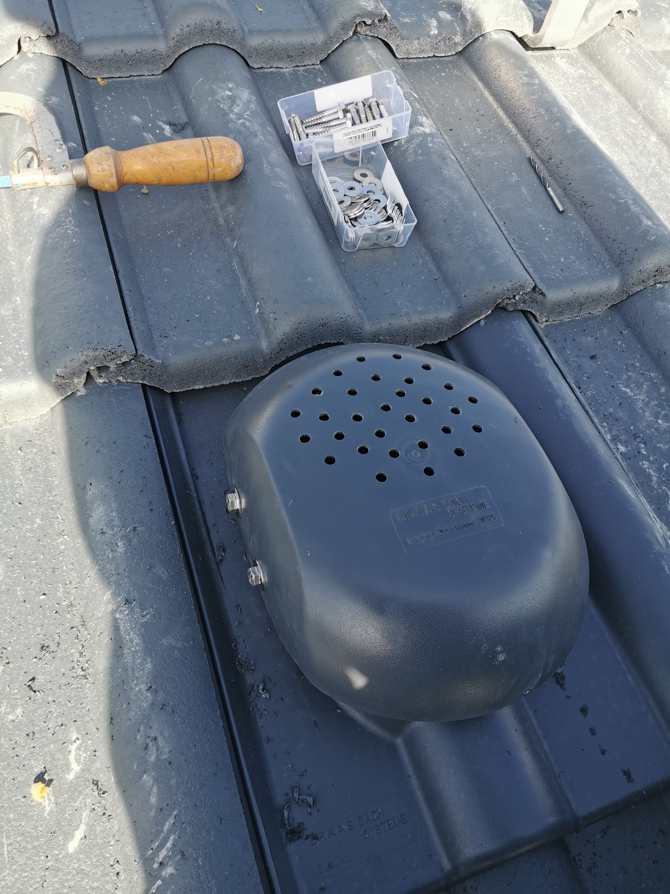

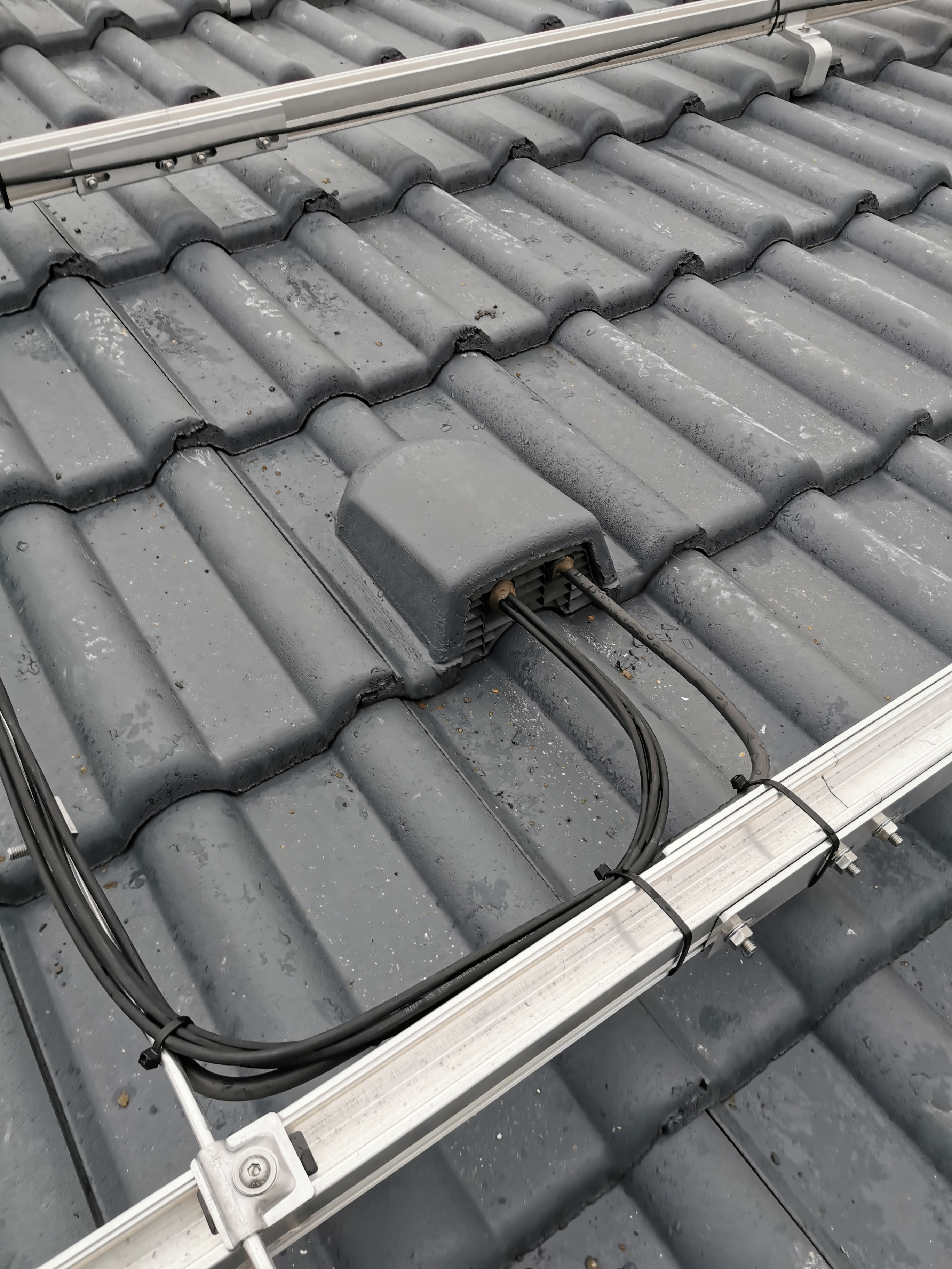

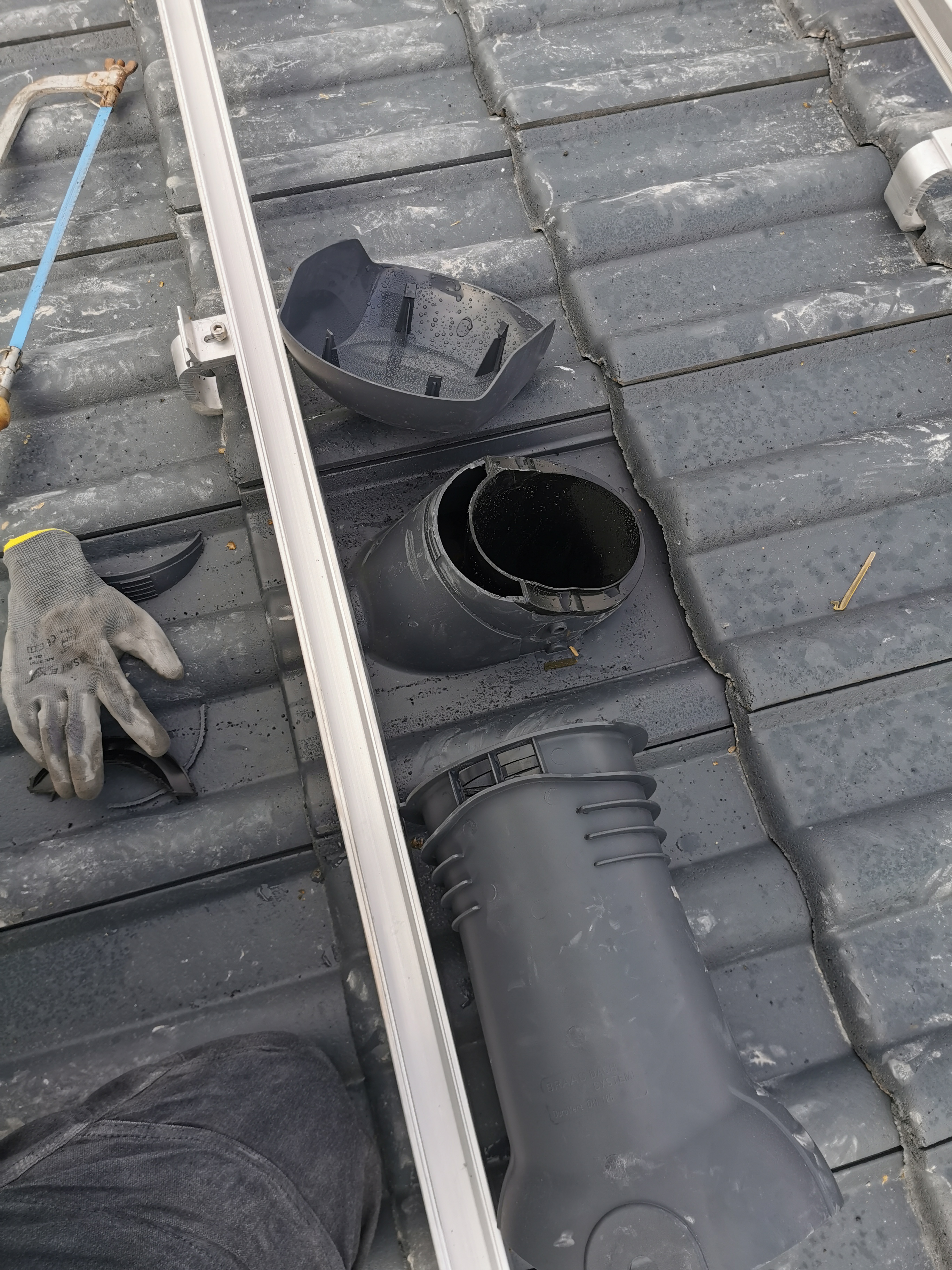

Oh, I almost forgot... the vent brick can be built over. Other ventilation pipes can also be shortened and built over. I specifically bought the vent bricks shown in your picture and used them as roof penetrations.
