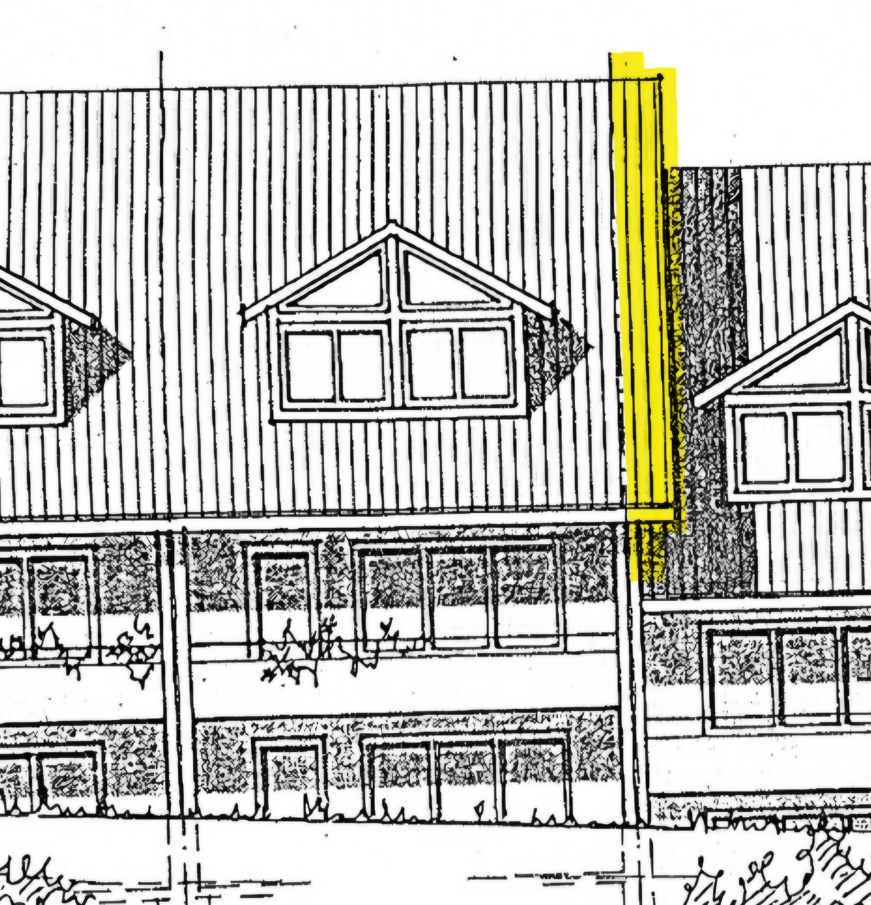

Thank you for your responses. I have looked into various tools, but in the end, measuring and working with the plans was the most effective for me. However, there is one question I hadn’t considered and would like to ask for your opinion. Our house is a mid-terrace house. I had planned to install a row of panels on the east and west sides of the dormer (see plan), which would just fit space-wise. Now here is the issue: the property boundary on the east side crosses over the roof. Although the roof physically belongs to our house, I suspect that the strip still belongs to the neighbor (marked in yellow). I find this a bit unusual, but this seems to be what the plan shows. For me, this means I cannot simply install anything on that strip. What do you think? I was not aware of this before, but after seeing the dividing walls in the plan, I assume this is correct. Does this also mean that for a roof renovation or repair on this strip, the neighbor would be responsible and I would have to coordinate everything with them? It could be that a repair is necessary there (which is actually the case), because although the roof belongs to my house, on the overhang that extends over their side, there is a flashing strip hanging down that makes considerable noise when it’s windy. I would appreciate any answers or assessments.
HubiTrubi409 Mar 2026 13:03One more question: Is it possible to relocate such ventilation bricks, or possibly cover them with a panel? I think the latter is less ideal, as the air beneath the panels would likely get even warmer in summer.
Basically, I believe this overhang belongs to you and should be maintained and serviced by you. Additionally, you should ask your neighbor if they would have any issues if the panels don’t meet the minimum spacing requirements.
