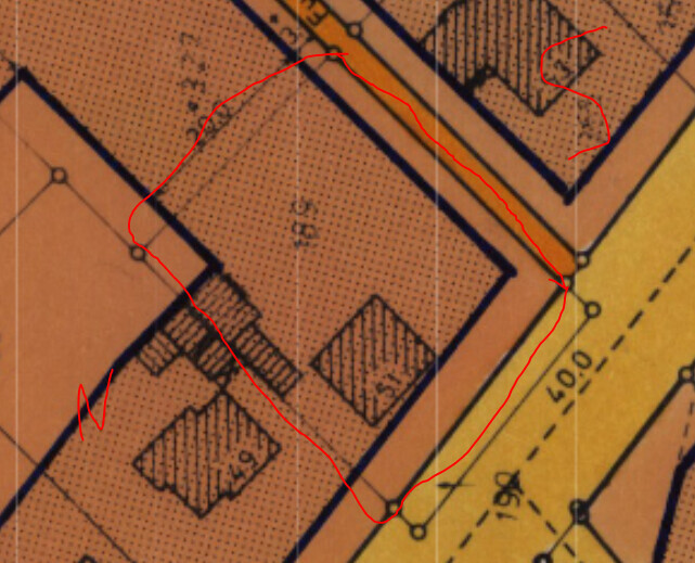

Hesseder11 Jan 2020 13:50Development Plan / Restrictions
Plot size: 1000sqm (front approx. 29m (95 feet))
Slope: -
Site coverage ratio: 0.3
Floor area ratio: 0.5
Building envelope, building line, and boundary: see photo
Edge development:
Slope: -

Building boundary ... 5m (16 feet) to the southeast and 3m (10 feet) towards the northeast? Northeast ... the dark orange area, is that a dead-end street? Could the property access also be from there?
What type of road is marked in yellow?
Is the adjacent plot to the north still undeveloped?
Is the house going to be built with a basement? Although the questionnaire specifies no basement.

Hesseder11 Jan 2020 15:37Hi,
unfortunately, I don’t understand the question about the building envelope...
All the plots are already built on.
The dark orange area is a footpath, about 1.8 meters (6 feet) wide. The road is a standard street in a residential area.
My mistake, I meant the ground floor...
