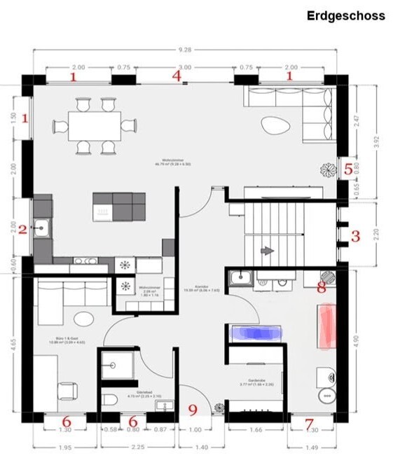

Utility room briefly tidied up; blue indicates the meter cabinet and server cabinet (behind the door, with enough clearance when the door is closed), red marks an optional cabinet. We currently have some concerns about the air-to-water heat pump and whether the clearances will be sufficient – but that depends greatly on the technology used, and meeting the DIN standard will hardly be possible anyway.
Regarding the kitchen: we really dislike elevated ovens 😀 so far, we have always placed them inside the island, which prevents the kitchen fronts from being visually interrupted by a black oven.
Optional granny flat: not important to us, we would never insist on it but would consider it if it makes sense financially and the opportunity arises.

I have to say, I am somewhat speechless that such detailed furniture layouts are being squeezed into the house plan. On top of that, with so much enthusiasm explaining some components as if they were set in stone. I can already see a lot without dimensions, but if you are passionately working on your own design, something like this (just as an example) should stand out as NOT working as expected.
Unfortunately, I can only guess the measurements since screenshots of screenshots often become unreadable on screens, but the 9.28 m (30 ft 5 in) interior dimension is usable. Also noticeable here is the contradictory thickness of the partition wall, as the wall lining is actually located not there, but on the vertically oriented wall in the plan.
And these “errors” run through the entire floor plan. My scaling is already quite generous (I am even adding a few centimeters inside), but it reveals many bottlenecks like the staircase with 2.80 m (9 ft 2 in) depth, kitchen furniture similarly, then the sofa, etc. By the time you get to the ironing board, it should be clear that some things are not functional.
It may be very commendable to think about household appliances right away, but is a closet with a door really necessary just for the floor cleaning robot?
