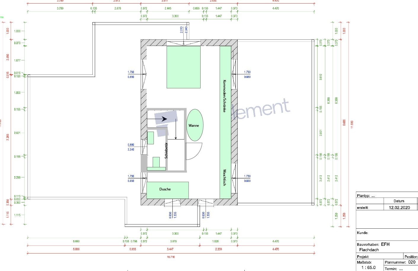

I don't have anything against the fragmented building form, but what I would do is leave the parent area completely open upstairs, with no walls except maybe for the bathroom and possibly around the staircase (but made of glass there). Quite impractical for everyday life, but it always looks so great in architecture magazines...

Tamstar schrieb:
I don’t mind the fragmented shape either, but what I would do: keep the parents' area upstairs completely open, no walls except maybe for the restroom and possibly to the staircase (but made of glass there). Quite impractical for everyday life, but it always looks so great in architecture magazines...
First of all, I want to express my enthusiasm. I really appreciate that you don’t just think about it but you, Tamstar, even invest time in the drawing.
Regarding your drawing: It will definitely look great, or rather, it certainly does in all those magazines. Personally, I also like it a lot in the various hotels where I stay for work during the year.
“Impractical for everyday life” is a good way to put it. I want to have my peace when my partner gets up earlier in the morning — or vice versa. Therefore, we don’t want the bathroom directly adjacent to the bedroom, let alone a completely open area.
In our current apartment, the bathroom is directly next to the bedroom. You hear everything, starting from the shower and hairdryer up to the exhaust fan in the bathroom.
