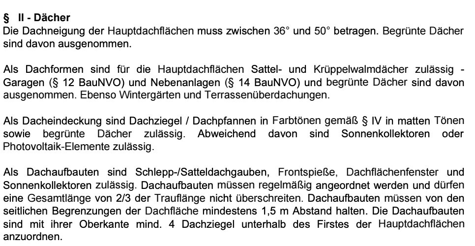

Do we have, or is there, the exact wording of the development plan?This is the exact wording:
For the main roof surfaces, gable roofs and half-hipped roofs are permitted – garages and ancillary structures and green roofs are excluded from this.

tfb0307 schrieb:
this is the exact wording:
For the main roof surfaces, gable roofs and half-hipped roofs are permitted – garages and ancillary structures and green roofs are exempt from thisDo you know: I’m confused about the hyphen (or whatever it’s called).
Is this really used in a development plan?
Would you be willing to post the complete development plan or at least provide the name of the district including the building area?
You know, the hyphen (or whatever it’s called) confuses me.
Does it really exist in a development plan / zoning plan?
Could you please share the entire development plan or at least name the county including the building area?... the dash does exist, at least in this development plan / zoning plan.But it’s good that you mentioned it again. I was a bit inattentive myself and definitely should have included the first and third paragraphs — or just the picture right away.
But have a look for yourself:
Edit: I apologize for my oversight and for providing incomplete information...
I agree with @11ant. It is correct and important that you point this out. For my statement, I used the passage from the questionnaire as a direct quote and therefore as the basis. The excerpt that came most recently confirms this in my opinion: they almost seem to prefer green roofs, given how often this is specifically highlighted as an exception.
