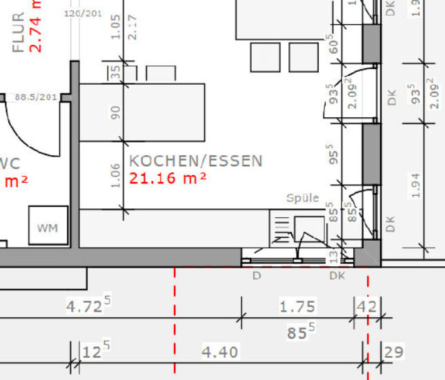

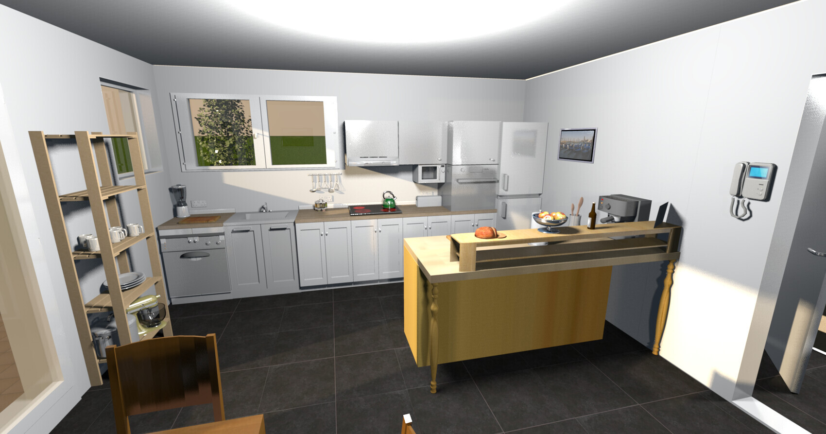

with the existing floor plan, we have currently planned the following kitchen layout.
The total area of the kitchen with the dining corner is 21 sqm (226 sq ft), and the length of the room (wall with the kitchen units) is 440 cm (14 ft 5 inches).
A kitchen island is planned, but purely as a work surface (no stove), possibly with open cabinets underneath;
and optionally with a raised section at the end of the island so it can serve as a kind of bar.
Note: In the rendered image, the colors and designs (wall shelf, island, sink, etc.) are just examples (as rendered by Sweet3D), the main focus is on the arrangement and sequence of cabinets and appliances.
It might also be nice to have a (small) work surface in the window corner (facing southwest, evening sun).
Currently, the dishwasher is planned there, close to the sink, and the open door is hardly an issue (because it is along the wall).
Any ideas, comments, suggestions?
Good luck,
martin

martin So basically, you really like your design? You describe your plan and ask for “ideas, comments, suggestions,” but then dismiss everything that is suggested and still think your layout is perfect as it is?
What kind of ideas, comments, suggestions are you actually looking for and why?
I’m a bit puzzled.
I don’t fully understand it either. Especially since many of the points made were quite valid. For example, the comment about the fully automatic coffee machine being placed near the sink. The response was, “You can just carry it three meters every couple of days.”
Sure, you can do that. But you could also trip, spill the coffee grounds and water mess over the floor, and then have to clean it up. Someone living in a rental apartment where the kitchen is already installed and who can’t find another spot for the coffee machine might be able to manage that just fine. But if I’m designing a kitchen in a new build, would I really plan such inconvenience into it myself?
Many of the points raised are valid, while many of the replies are more like “it doesn’t bother us.” You can live with a lot, but when planning something new, shouldn’t you try to avoid inconvenient compromises where possible?
