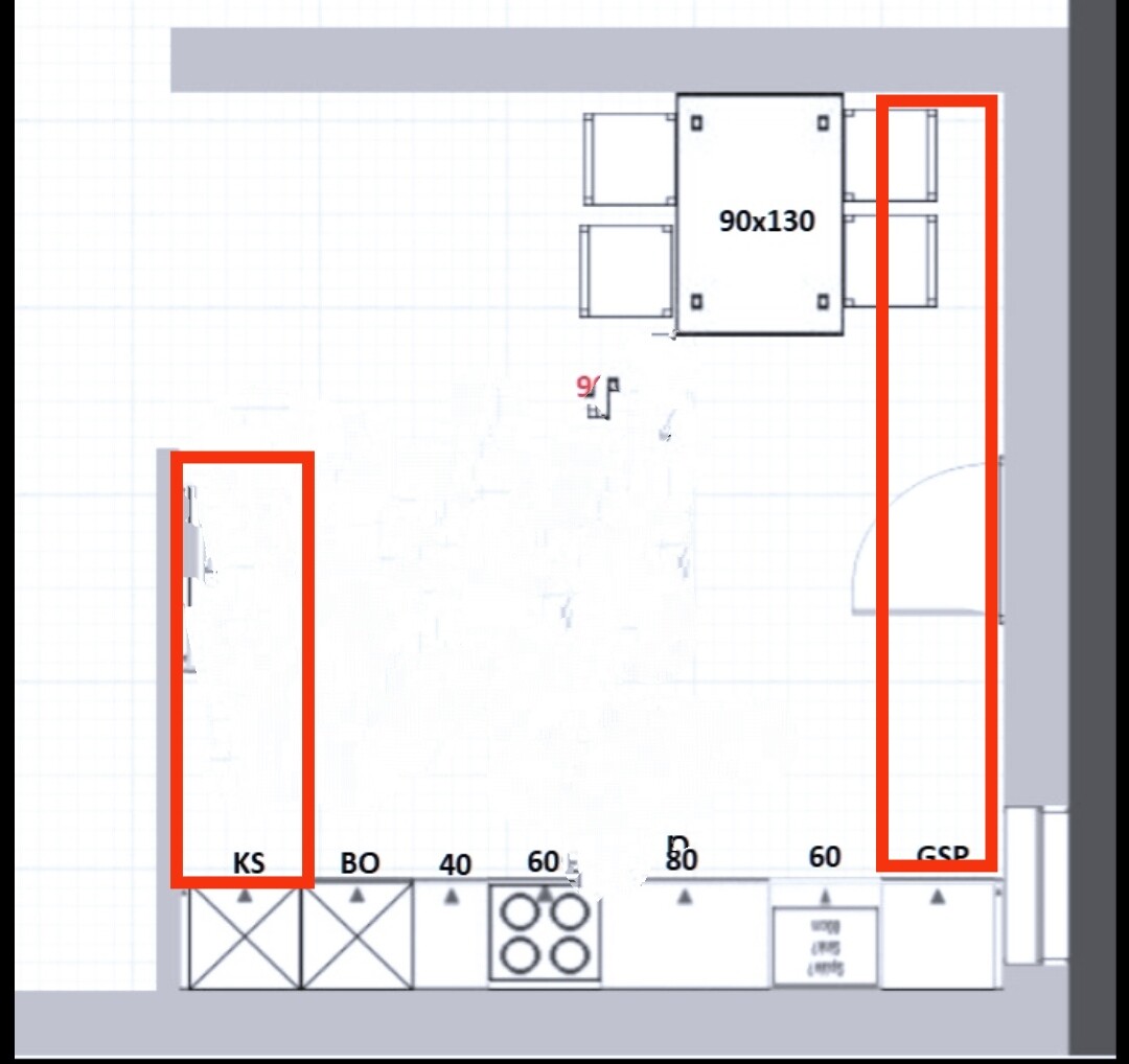

with the existing floor plan, we have currently planned the following kitchen layout.
The total area of the kitchen with the dining corner is 21 sqm (226 sq ft), and the length of the room (wall with the kitchen units) is 440 cm (14 ft 5 inches).
A kitchen island is planned, but purely as a work surface (no stove), possibly with open cabinets underneath;
and optionally with a raised section at the end of the island so it can serve as a kind of bar.
Note: In the rendered image, the colors and designs (wall shelf, island, sink, etc.) are just examples (as rendered by Sweet3D), the main focus is on the arrangement and sequence of cabinets and appliances.
It might also be nice to have a (small) work surface in the window corner (facing southwest, evening sun).
Currently, the dishwasher is planned there, close to the sink, and the open door is hardly an issue (because it is along the wall).
Any ideas, comments, suggestions?

darksun schrieb:
PS: Don’t get me wrong, but we don’t see some of the points mentioned as disadvantages ...Then not. You asked!darksun schrieb:
So, what would be your proposed solution given the floor plan?I don’t see a floor plan, only a small section. I also won’t waste time if obvious mistakes are not recognized or acknowledged.
Tip: use a kitchen planner, not a floor plan software.
But it’s best to consult a professional or join a suitable forum where kitchens are designed.
Benutzer 100119 Jun 2022 06:41Such a large kitchen, but it somehow feels like nothing fits in.
Maybe consider moving away from the idea of an island if you want to keep the table and simply build the kitchen in a U-shape.
Benutzer 100119 Jun 2022 07:24evelinoz schrieb:
A U-shaped layout would mean less storage space, less surface area for placing items.If that’s the case, why would it result in less storage space?
