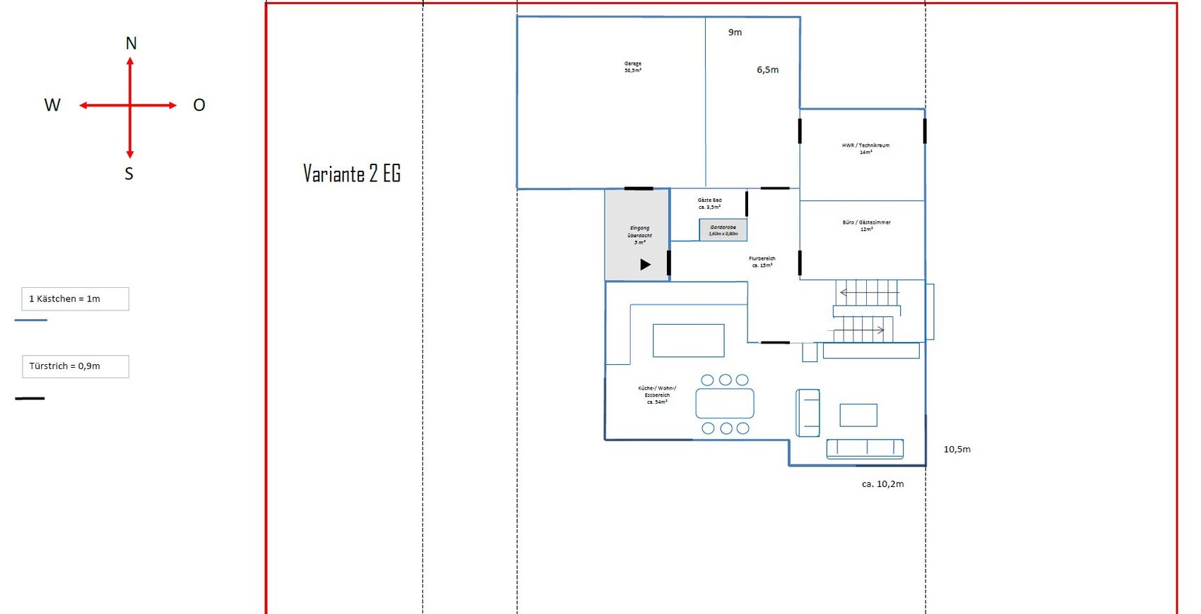

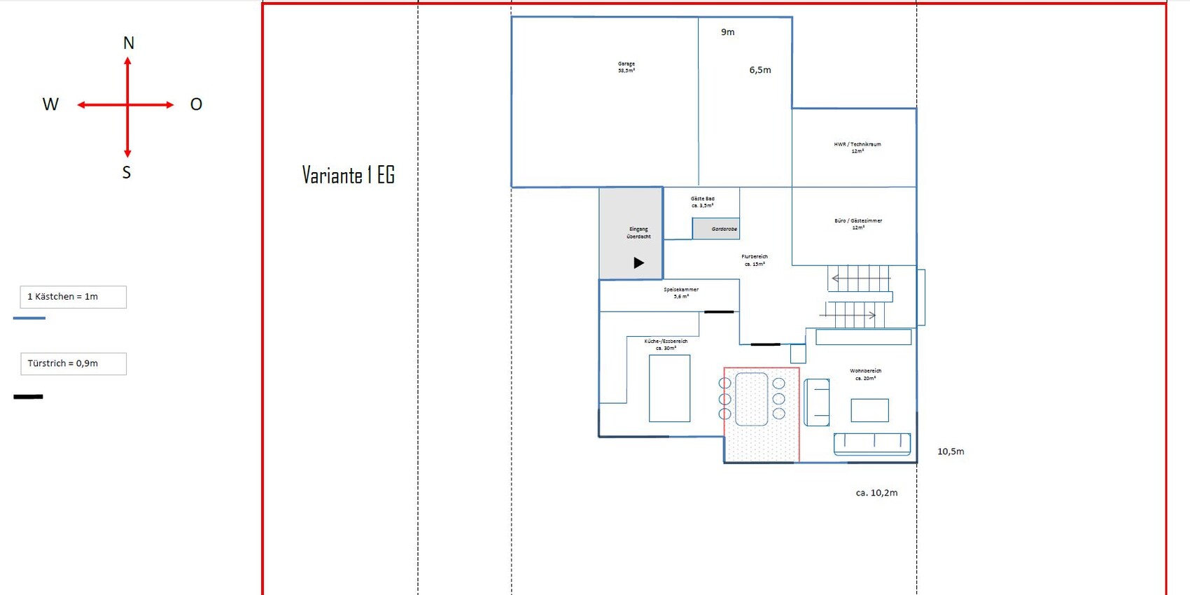

This morning I tried again to refine Yvonne’s draft by incorporating your feedback and taking spatial conditions (possibly square meter figures) into better account. Since we are still discussing the floor plan layout of the house or possibly the room arrangement, I have not yet included wall thicknesses (which would affect the total square meters and size of the house).
(Initially, our focus was actually only on the alignment of the garage in relation to the house within the specified building plot, which has now developed a bit further)
Variant 1 Ground Floor Changes:
Ground floor plan variant 1 with entrance area, kitchen, dining room, office, and garage.
  • Entrance hall area reduced
  • Kitchen door removed
  • Pantry widened to 1.20m (4 feet) (as already mentioned, no freezers are planned here)
  • Gallery indicated
Variant 2 Ground Floor Changes:
Ground floor plan variant 2: kitchen/living/dining area, office/guest room, utility/technical room, staircase
  • Utility/technical room enlarged from 12m² (129 square feet) to 14m² (151 square feet)
  • Pantry removed
  • Gallery removed

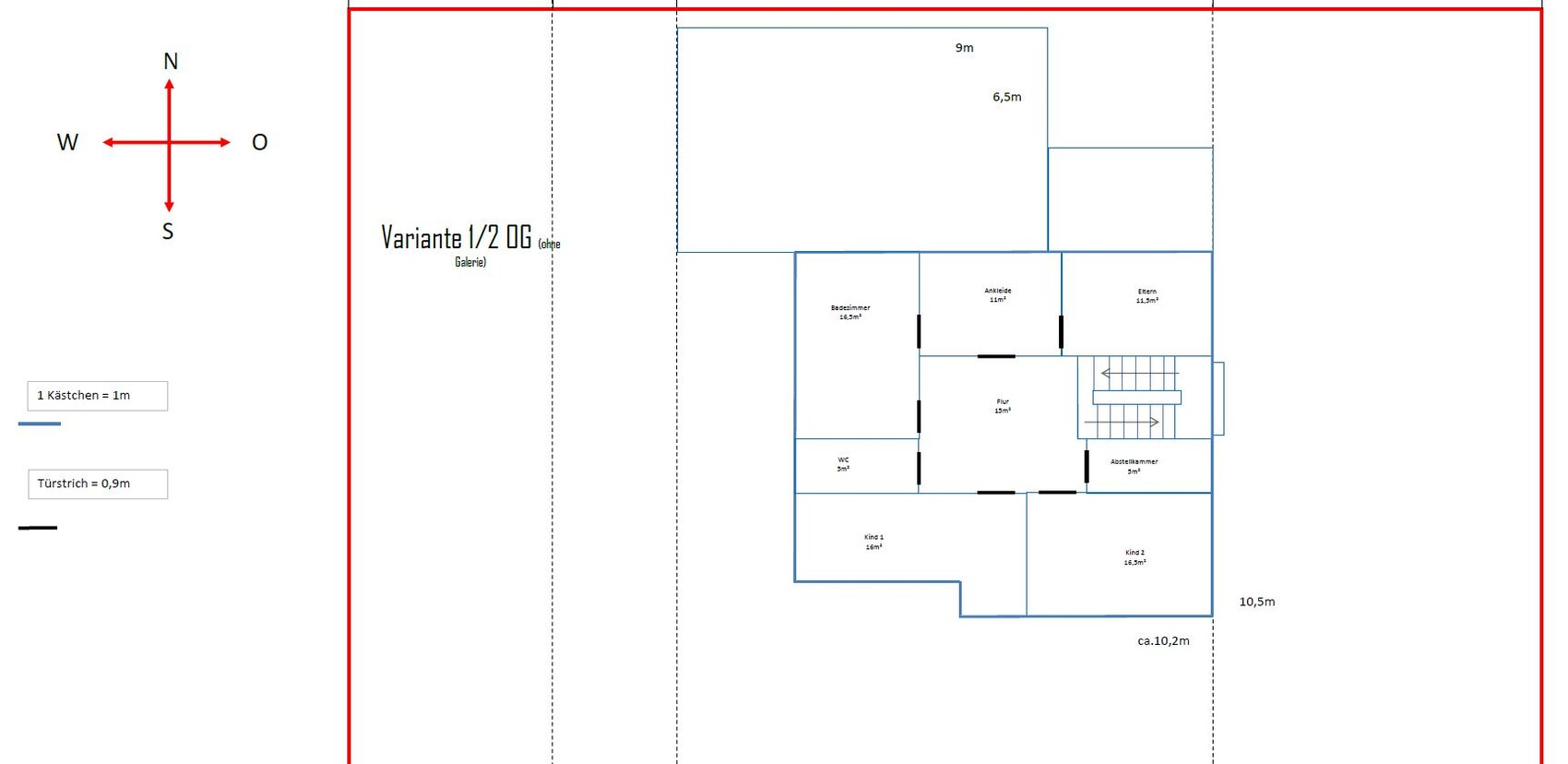

Variant 1/2 First Floor Changes:
Floor plan variant 1/2 attic (without gallery) with bathroom, WC, hallway, parents’ and children’s rooms.
  • Hallway area reduced
  • Square meters of the parents’ bedroom and dressing room adjusted
  • Bathroom size adjusted
  • Storage room included in the plan
  • WC included in the plan
  • Gallery removed

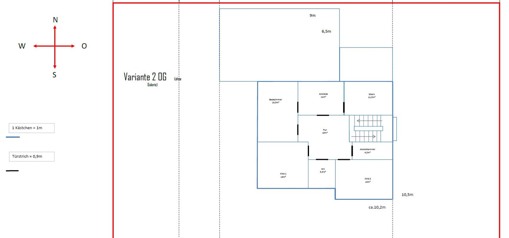

Variant 2 First Floor Changes:
Floor plan of a residential house: gallery variant 2 on the first floor with bathroom, parents’ and children’s rooms.
  • WC position changed / slightly larger
  • Gallery removed
  • (the corner area of child 1’s room could of course also be moved inward)
RobsonMKK17 Aug 2016 12:49
What I noticed:
  • The bathroom is huge, about 17 sqm (183 sq ft). What is supposed to go in there?
  • The storage room on the upper floor seems too narrow. What is meant to be stored there?
  • Why not make the house fully cubic and remove the last bend as well?
  • I find the kitchen area too tight in both plans. The very large island only has a clearance of about 70 cm (28 inches).
  • As mentioned before, you seem to prefer a very complex layout.
  • How wide is the entrance hallway? It looks to me to be just over 1 meter (39 inches), which could be tight with the front door. Is only a door planned there, or will there be a glass panel next to the door as well?
Häuslebau3r17 Aug 2016 13:17
RobsonMKK schrieb:
What I notice:
  • The bathroom is huge at about 17 sqm (183 sq ft). What exactly will go in there?
  • The storage room on the upper floor seems too narrow. What will be stored there?
  • Why not make the house completely cubic and remove the last kink as well?
  • In both plans, I find the kitchen area too tight. The very large island only has about 70 cm (28 inches) clearance around it.
  • As already mentioned, you seem to prefer quite a complicated layout.
  • How wide is the entrance hallway? It looks just over 1 meter (3.3 feet) wide, which might be tight with the front door. Will there only be a door or also a glass element next to it?
Hello Robson,
Thanks again for your comments. I would like to address and incorporate your points once more.
The plan includes a bathtub as well as a walk-in shower, toilet, and a washbasin unit with either one long or two separate basins. Details are not finalized yet since we are still in the preliminary planning phase.
It is mainly intended as a utility closet for items like the vacuum cleaner and other household accessories. It would certainly be too small for a dedicated ironing room or similar. Possibly, the bathroom could be made slightly smaller to add the gained square meters there, depending on what works better.
We were a bit bothered by the purely rectangular appearance of the sample houses we have seen so far and didn’t feel fully convinced by them. That’s why we wanted to soften the shape of a typical cubic townhouse with this small projection.
I based the island size on online examples and tried to scale it to our current island. However, I’m not entirely certain it needs to be that big; in the drawing, it measures 2.40 x 1.30 m (7.9 x 4.3 ft).
Are you referring to the external shape of the house or also to the ground-floor hallway layout? We tried to arrange the kitchen, living, and dining areas on the ground floor in more of an L shape. We actually wanted to avoid a narrow corridor shape, but with this lot layout, it might not be so easy.
Including a glass element would definitely look nice. Due to reducing the hallway size, it has now been set to 1.50 m (4.9 ft). What would be the approximate standard width needed for this?
I am open to other configurations that would allow an L-shaped arrangement of the kitchen, living, and dining areas with an entrance from the west, but I believe that is not exactly easy, especially while placing the staircase on the east side.
