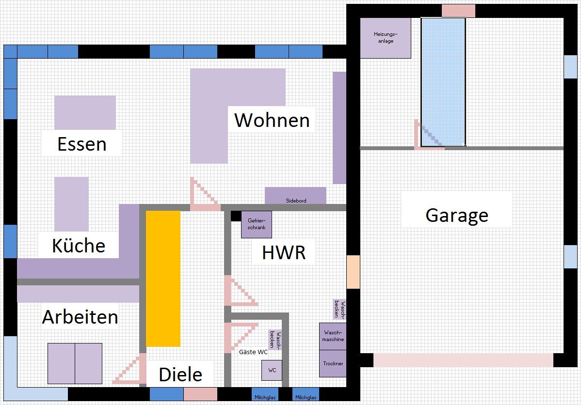

I need to learn more about these drawing programs, so far I've only used the usual drawing and word processing software. Let's see if my CAD programs still work. Before you struggle or buy software:
Take a piece of paper and draw it roughly to scale. Alternatively, you can even do this with Excel:
Häuslebau3r schrieb:
Maybe also with a slanted wall at the top like in the design with the gallery, just without the gallery itself. UHHHHHH... you’re planning such a nice, straightforward house and then want to add a slanted wall... that really makes my hair stand on end. But, of course, that’s a matter of personal taste.
UHHHHHH... you’re planning such a nice, straightforward house and then want to add a slanted wall... that really makes my neck hairs stand on end. But, of course, that’s a matter of personal taste. Well, now you’re really surprised.
So far, the wall isn’t built yet.
Yep, I’ll get around to making a proper scale drawing when I have time. First, I’ll collect the data for a staircase.
Now I actually had to laugh again at my own Tetris design.
But Excel is really practical for this; you can easily move everything back and forth.
Simply set the rows and columns to a small but consistent height and view it as a 10cm (5 inches) grid. This means you only have 40cm (16 inches) exterior walls and 20cm (8 inches) interior walls, but 60cm (24 inches) cabinets can be represented well.
Jochen104 schrieb:
I just had to laugh again at my own Tetris design.
But it’s really practical in Excel; you can easily move everything around.
Just set the rows and columns to a small but consistent height and use it as a 10cm (5 inches) grid. That way, you end up with 40cm (16 inches) exterior walls and 20cm (8 inches) interior walls, but 60cm (24 inches) cabinets can be well represented. Maybe you can import the floor plan from the other program and then, as you suggested, redraw it to scale again. I might give that a try tonight. (without glass white), otherwise it won’t work again.
