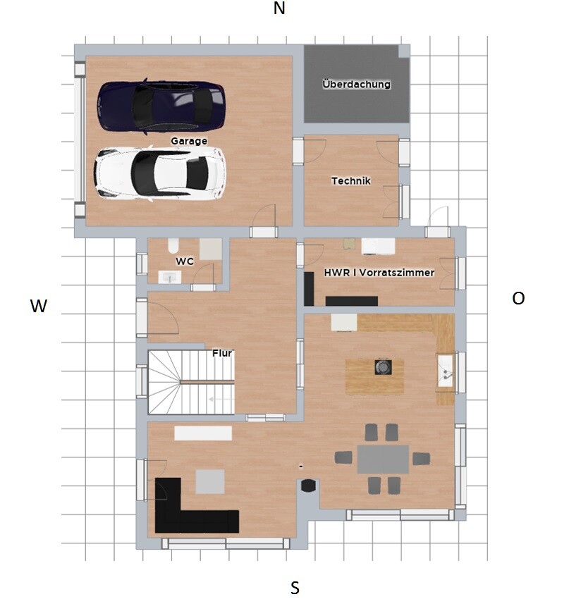

I’ve been a bit busy the past few days and am only now getting back to this topic.
Andreas, in general, I’ve noticed that you initially had quite detailed ideas about certain parts of your future house (for example, the staircase). Without scrolling back through the thread, I would say that unfortunately most of those seem to have disappeared. What remains is a relatively simple floor plan with a recess on the bottom wall of the plan.
I’m putting it quite bluntly on purpose to make sure you’re aware of this. Our floor plan is actually quite simple, too. But that was intentional.
Regarding the current design and the discussion about sightlines: Because of the strong L shape of the living/dining/kitchen area, you are naturally blocking some of the views. We placed more emphasis on sightlines within this area itself rather than looking into or out of the hallway. For this reason, we deliberately kept the leg of the L where our kitchen is located a bit shorter and moved the kitchen island closer to the dining area. From the kitchen island, for example, you can see almost the entire living and dining space.
Edit: What I want to say is that you should think in advance about where you will spend time at home and what you want to do there. Consider where you want to look and what you want to see...

Jochen104 schrieb:
Andreas, I’ve noticed that at the beginning you had quite specific ideas for certain parts of your future house (for example, the staircase). Without scrolling back through the thread, I would say that, unfortunately, most of these have disappeared. What remains is a fairly simple floor plan with a projection in the lower wall of the plan.That’s exactly what I said. Specifically, it was about the staircase and, I believe, the unobstructed view to the east.
Now there is a staircase, just some staircase—and even if it is the dream staircase, hardly anyone will see it.
The original ideas included openness, which would have allowed views to some highlights inside the house.
Jochen104 schrieb:
I was a bit busy the past few days and am only now getting back to this topic.Hello Jochen,No problem at all – I’m often in the same situation myself lately, which is why I can’t always write every evening or day. Still, I’m glad that constructive and especially honest feedback keeps coming in.
Jochen104 schrieb:
Andreas, in general I noticed that at the beginning you had quite precise ideas for certain elements of your future house (e.g. the staircase, etc.). Without scrolling back through the thread, I would say these (unfortunately) have mostly disappeared. What remains is a relatively simple floor plan with a protrusion on the lower wall in the plan.
I’m saying this quite bluntly on purpose to make sure you are aware of it. We also have a rather simple floor plan. But that’s what we wanted.I think we had somewhat complex ideas at first, judging by how the designs evolved. Of course, the initial thoughts were firmly anchored, but I believe they’ve now simply been adapted to reality (feasibility). The L-shape was always desired, as was the staircase and the focus on the southeast view, which is still available through the windows. Of course, for example, the staircase with the view to the east was sacrificed, but this allowed for a better room layout upstairs.Jochen104 schrieb:
Regarding the current design and the discussion about sightlines: With the strong L-shape of the living/dining/kitchen area, you naturally block quite a bit of the view. We placed more value on the view within this area than on looking from or into the hallway. For that reason, we deliberately kept the leg of the L where our kitchen is a bit shorter and moved the kitchen island more towards the dining area. From the island you can see almost the entire living and dining area.We also considered softening the L-shape a bit and straightening the dining area with the living area or removing that protrusion. But since we wanted to avoid a purely cubic space, we would be reluctant to change this. Perhaps some compromises are indeed necessary. P.S. We have also moved away from the large sliding door between the living and dining areas.What are your experiences, or those of others, regarding kitchen odors spreading into the open areas?
Jochen104 schrieb:
Edit: What I meant to say was: You should think in advance about where you will spend time at home and what you want to do there. Where you want to look and what you want to see...At the moment, we are getting a turnkey quote from construction company 1, which we visited again yesterday, based on the newly created first rough floor plan, just to get a rough idea without commitment. For us, the important thing now is what it comes down to in the end or whether we need to change our plans.
That’s exactly what I said. It was specifically about the staircase and, I believe, the unavoidable view to the east.
Now there is some staircase, any staircase – and even if it is the dream staircase, hardly anyone will see it.
The initial plans aimed for openness, which would have allowed views of some highlights in the house.Yes, I understand what you mean, Yvonne.
For example, the staircase has now moved to the west to better design the southeast orientation of the rooms. (I have marked the cardinal directions again.)
The openness might, as mentioned earlier, still be possible in summer with sliding doors (which, of course, are not cheap). In winter, though, you tend to be more practical, trying to keep out the cold air without a small entrance area (vestibule) and closing off rooms... or is that unrealistic?
It’s clear the current design is nothing spectacular, nor was it ever meant to be. But of course, we are always grateful for and open to suggestions for changes.
