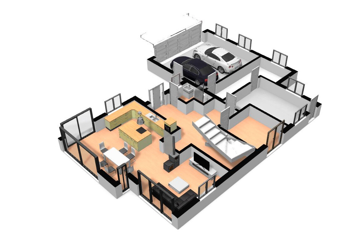

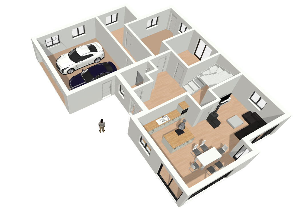

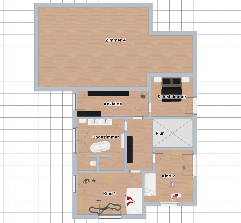

You now have 7 rooms on the upper floor, which means quite a few walls, making the individual rooms naturally smaller.
I would place the bed against the top wall of the plan (then you can also install a window facing east and avoid looking onto the garage roof). You can adjust the width of the bedroom according to the suggestions from @kbt09. To achieve the required depth, you will need to move the staircase downward. This should not be a problem for the children's room upstairs, but it will, of course, affect the size of the living room and office on the ground floor. However, it should still work.
kbt09 schrieb:
Well, that immediately expands the room size for the bed ... I would set the room width, meaning the wall where the bed is placed, to at least 375 cm (12.3 ft) and the room depth to at least 320 cm (10.5 ft), preferably 340 cm (11.2 ft) = 12.75 m² (137 ft²). And now you see the problems that arise from seemingly ideal line drawings. Start making the plan including wall thicknesses. Use graph paper, accurately draw the exterior dimensions once, make multiple copies, and then start sketching with pencil. And keep the costs in mind. I just read your statement about that in a financing thread. What is the maximum budget for the house?Will definitely do that in the coming days.
I already mentioned that you never really stop learning. I will try Robson’s software or maybe start with pencil on an A3 drawing board beforehand.
Regarding the monthly payment or house costs, I don’t want to speculate yet, since so far only our intended maximum budget is known. With this finalized draft, we want to go into preliminary planning with our designer first (we didn't want to show up empty-handed). After that, we will start initial talks with lenders or brokers. Every “nice to have” costs money, and right now, I can’t estimate that. I already mentioned that the planned costs without the plot are around 320,000 to 350,000 euros. The plot, costing 70,000 euros, was purchased from equity earlier this year. The loan will probably be about 270,000 euros. Still, I don’t want to focus on costs in this thread but rather on the technical aspects.
In the other thread, I found the monthly payment range of 1500 to 2100 euros confusing, especially with an income similar to mine at 4800 euros, considering we plan to have children, which will reduce available funds further. I wouldn’t feel comfortable with that! That’s all I wanted to say about it.
... An architect would know that you can’t just place the staircase wherever you feel like; the position of the stairs determines room widths. So ideally place the stairs centrally first to allow for practical room sizes beside it. You can still move it in the following year. That was a joke and intended as a reminder... Has the plot been purchased yet?.??Since I’m not an architect, I’m all the more grateful for your semi-professional and professional advice. I will definitely take that into account.
Jochen104 schrieb:
You now have 7 rooms in the upper floor, which means quite a few walls, making the individual rooms smaller. I would put the bed on the upper wall of the plan (then you can install a window facing east and avoid looking at the garage roof). You can then adjust the bedroom width according to the suggestions from @kbt09. To get the desired depth, you have to move the stairs downwards. That shouldn’t be a problem for the children’s room upstairs but will affect the size of the living room and office on the ground floor. It should still fit though.If I move it, the storage room would be removed, giving more space upstairs for the bedroom and allowing a wall to be omitted (so only 6 rooms). I will definitely do it as you suggested and then present it here again.
The only thing that might bother me a bit is the edge that will appear on the ground floor between the kitchen area and the staircase. But we’ll have to see.

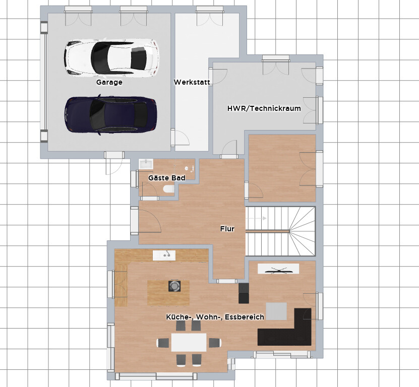

Good evening Yvonne,
it’s always nice to read something like this, and I agree with you.
Nevertheless, I haven’t been completely inactive and have given "Home by me" another try.
I will add dimensions and square meters later, as these are not shown there, as Robson already mentioned.
Good morning everyone,
Exterior walls 36cm (14 inches) and interior walls 20cm (8 inches) @RobsonMKK
I took the liberty to base it on your version.
Yes, as mentioned, "Home by me" doesn’t do this automatically, so I will measure everything manually today (time permitting) and also provide the square meters.
Regarding your point @kbt09, this would of course need to be checked on site. The house above mine, seen from the plot, has a similar structure, i.e., the garage is connected to the house, but with about 3m² (32 square feet) of an entrance area integrated on the west side.
I think this would initially be something to discuss with the local planner, and you could certainly also inquire about it with the municipality. (I am not aware of anything specific so far, but that doesn’t mean much.)
The technical room could also be modified or refined. I don’t know if it would be possible on the upper floor to extend the bedroom by about 1m (3 feet), but otherwise, as you already mentioned, the bed just won’t fit. Our current one is slightly larger than the one shown in the plans.
I’ll get back to you after measuring everything today.
Regards,
Andreas

In the latest version, dimensions would be really helpful. The utility room and workshop seem difficult to furnish, especially the technical room, with too many windows and doors.
Regards,
Andreas
