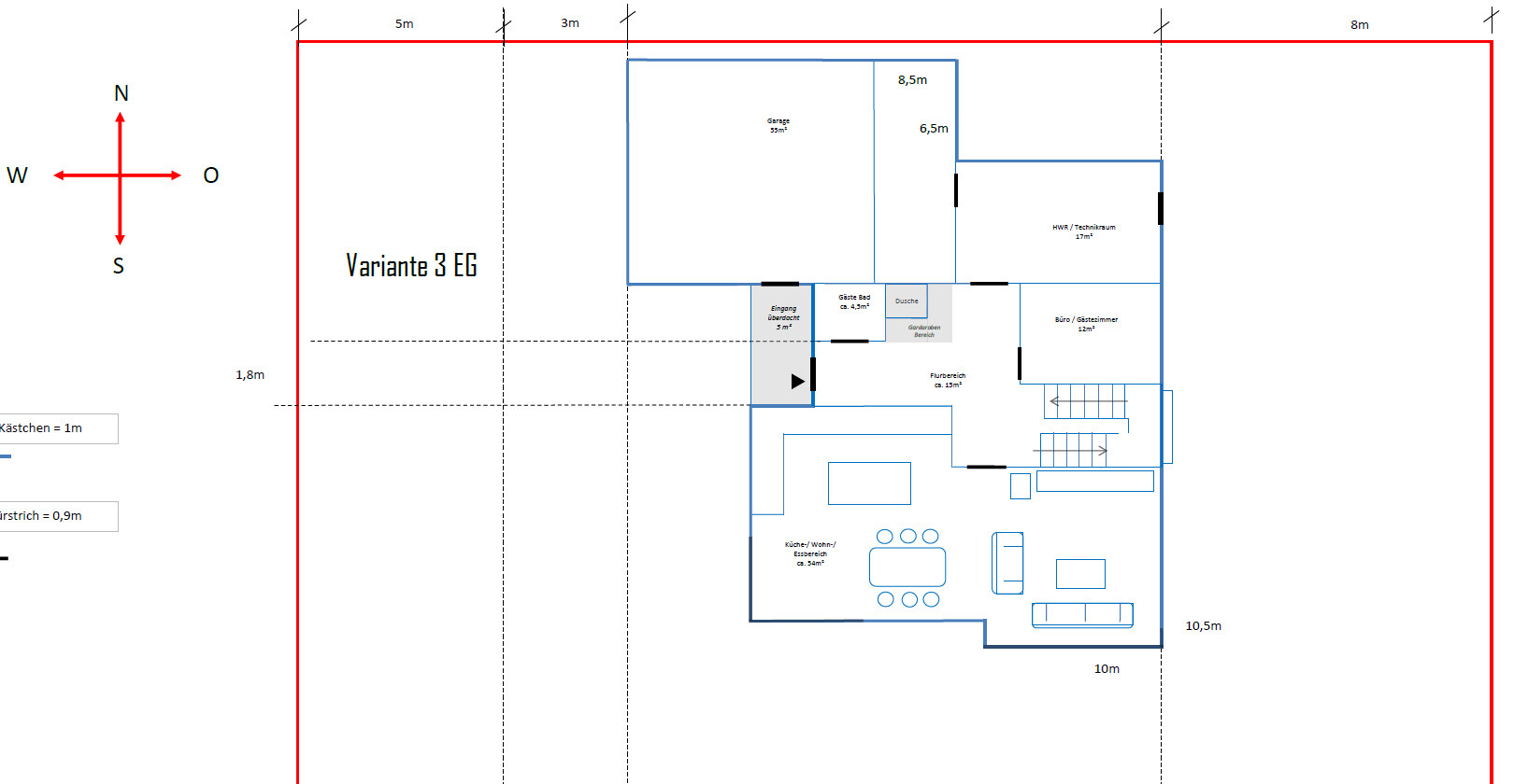

I used the internet regarding the island size and tried to draw it to scale based on our current island. However, I’m not exactly sure if the island needs to be that big or should be (in the drawing it’s 2.40 x 1.30 m (7 ft 10 in x 4 ft 3 in) (LxW)).As I said, the walkway around the island is more of an issue than the island itself. It just doesn’t look like there’s enough space to comfortably move around.
Yes, I understand where you’re coming from.
We’re also trying hard to figure out what would still be possible with an L-shaped kitchen, dining, and living area, with the entrance on the west side and the staircase on the east. I think it’s not that simple with such layouts.
It probably doesn’t look very good either if you enter through the front door and see the staircase directly at the end of the hallway. Hmm...
Regarding the front door, you would likely need to plan for about 1.80 meters (6 feet) in width.
As for the kitchen itself, I think we have about 90 cm (35 inches) of clearance around the island in our current apartment. Of course, that also depends somewhat on the size of the island, and so on.

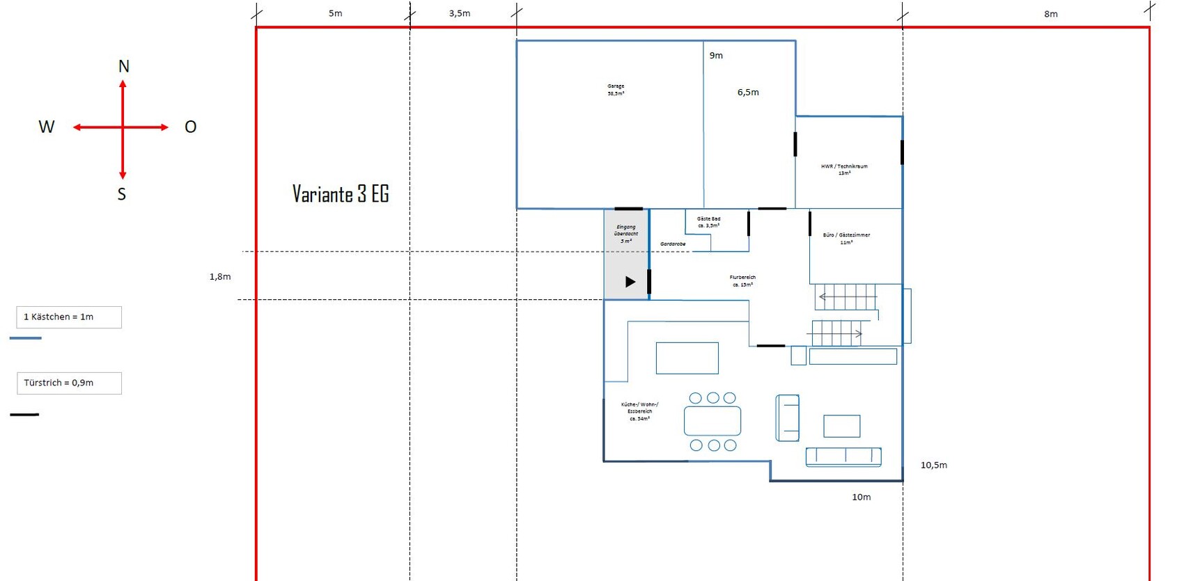

I have tried again to enlarge the entrance area on the ground floor.
Furthermore, the island has been adjusted in size. There is now a distance of 1 meter (3 feet 3 inches) to the counter. Due to the changes on the ground floor (aligning the corridors / eliminating angles), the utility room and office are naturally a bit smaller.

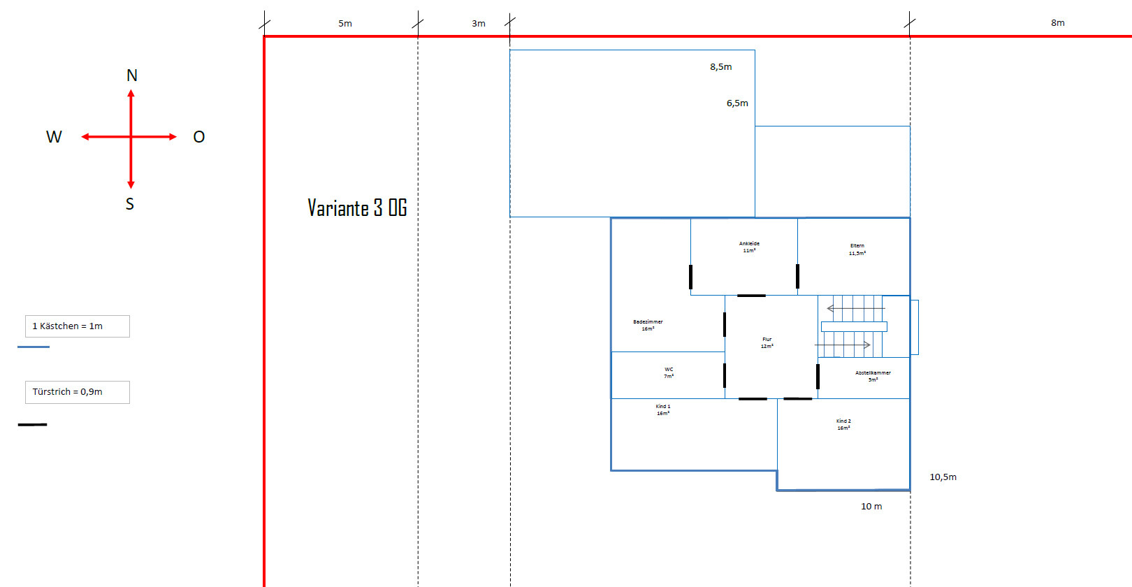

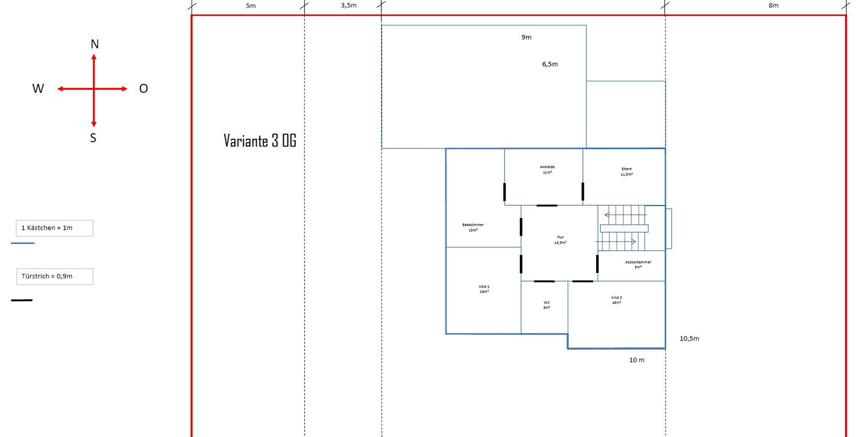

On the upper floor, the WC, storage room, and bathroom have been modified accordingly.
Looks much better already.
I have three small remarks:
1. I would remove the bend in the guest bathroom. With the niche, you have created a kind of "space" for the wardrobe. I’m not an expert on wardrobes, but I’m sure something useful can be done there.
2. Regarding the storage room upstairs, I still believe it will be difficult to fit a proper shelf due to the width. I suggest double-checking that.
3. Do you want a single-leaf door as access to the living room? Or something with a side panel or even double doors? I would try to consider that as well.
Otherwise, I find the overall layout much clearer now.
