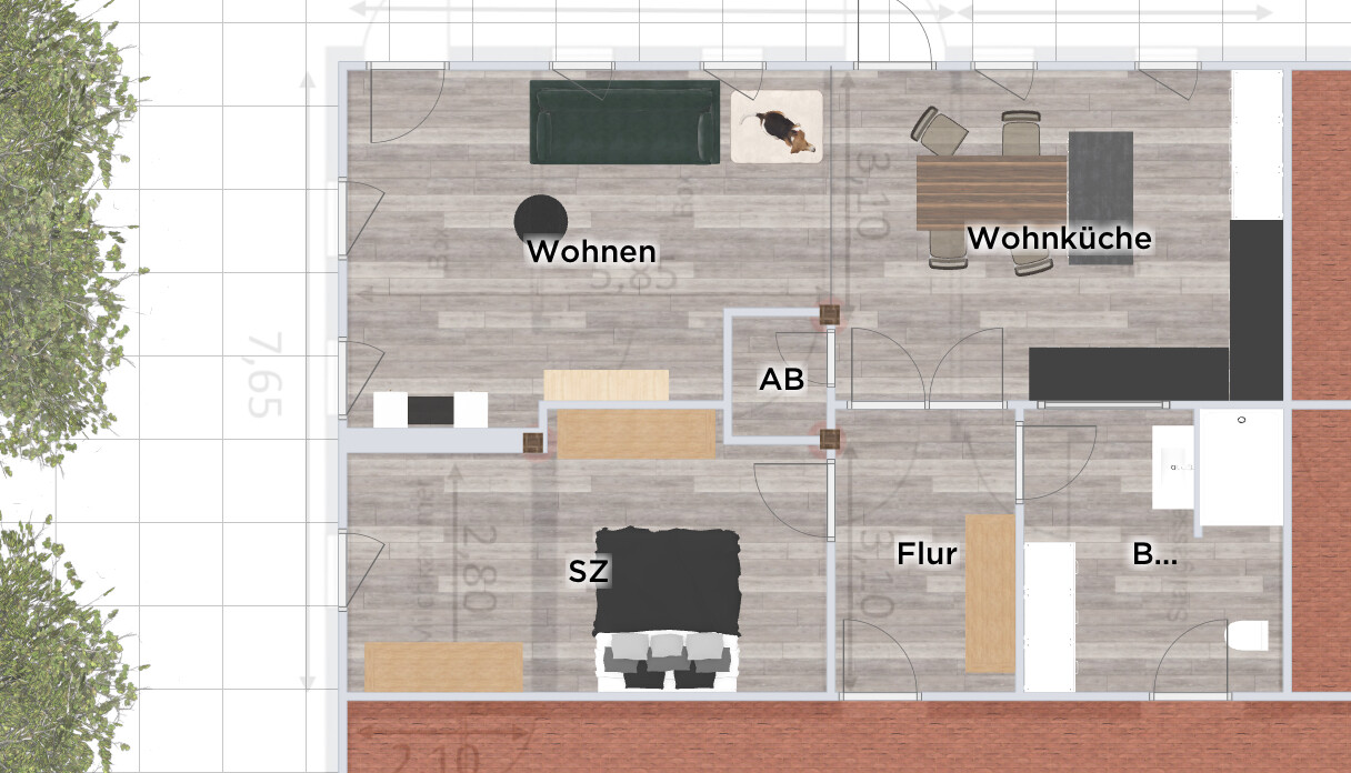

We are currently in the process of buying a former farmstead in Schleswig-Holstein (the notary is preparing the purchase contract) to combine living and working (self-employed with animals) under one roof. We, a family of four, will move in together with my mother-in-law on the property. The main residential part is basically ready to move in and is not a topic for discussion here. The part of the building previously used as a barn will be partially converted for my mother-in-law.
About 80m² (860 sq ft) will be used for the apartment, the section facing the courtyard is intended for my wife’s business use or as a guest WC for visitors to the farm. In the middle of the building, between the old residential unit and the barn, there is an unheated, continuous threshing floor. Access to the apartment can be via this area, which can also serve as a corridor for coats and shoes.
I sketched a draft for a possible layout, but somehow it doesn’t feel quite right. I have prepared a questionnaire, shortened for practical purposes:

Other requirements: Facade is protected by historic preservation. Window and door openings are predetermined. In the center, there is a beam with two supporting pillars (circled in red on the floor plan). These cannot be moved. At the lower right is the old milk room. The walls between the milk room and the rest of the barn could be removed. The door shown at the lower left on the plan can be bricked up or equipped with a window / terrace door.

Space needs on ground and upper floors: open-plan kitchen and living room, bedroom, utility room corner, bathroom

The outdoor area faces north and west, and towards the west there is the road as well as two large (listed) chestnut trees in the garden. My biggest concerns are 1. enough natural light entering the house and 2. some sunlight in the garden as well. For the latter, there is a shared backyard with a southern exposure.
Behind the western wall is the road, outside the built-up area but with little traffic. The wall has not yet been built, but according to the new state building code in Schleswig-Holstein, a height of 2m (6.5 ft) is allowed.

Low finishing effort, walls use existing posts.
What do you not like? Why?
I would like to keep the door at the lower left on the plan as a second exit open, but I haven’t found a space for a media / sofa area.

How can the living area be planned and divided efficiently without ending up with one big hall and inefficient space use?

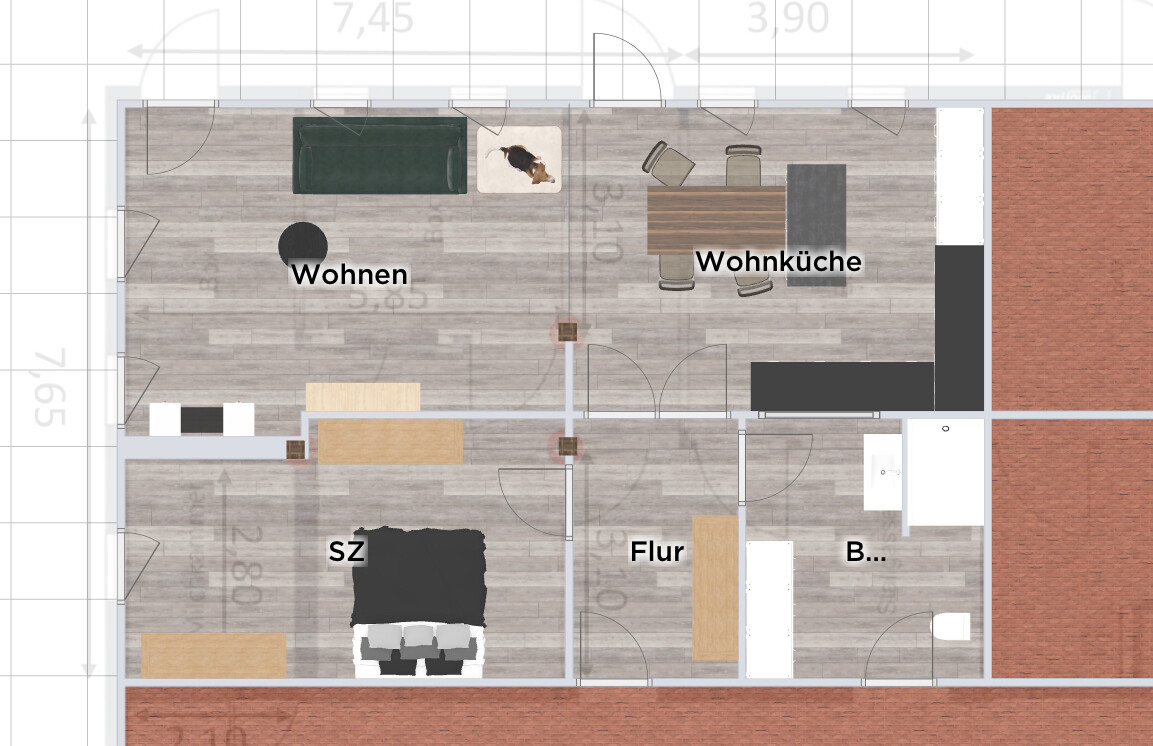

hanghaus2023 schrieb:
I used the original poster’s plan.Have a look. This is definitely different.I revisited Katja’s idea… and still didn’t move any supports 😉
This creates a work/desk area in the living room.
In the bedroom, you could create a built-in wardrobe between the columns or/and, as indicated here, set up wardrobe areas to the left and right of the window. I also added cabinets in the bathroom, where a washing machine could fit, or stand instead, and I created a storage room afterwards if needed. But I think that could be omitted.
