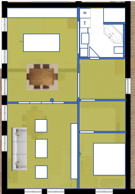

I sketched a draft for a possible layout, but somehow it doesn’t feel quite right. I have prepared a questionnaire, shortened for practical purposes:

Other requirements: Facade is protected by historic preservation. Window and door openings are predetermined. In the center, there is a beam with two supporting pillars (circled in red on the floor plan). These cannot be moved. At the lower right is the old milk room. The walls between the milk room and the rest of the barn could be removed. The door shown at the lower left on the plan can be bricked up or equipped with a window / terrace door.

I would like to keep the door at the lower left on the plan as a second exit open, but I haven’t found a space for a media / sofa area.

Once you have set it up, I see a small issue. It’s definitely workable, but with a disability, accessing the window side would be difficult.The support posts can be shifted from right to left in the plan. In both cases, there are beams running that need to be supported, and at the marked points there are currently posts or, in the case of the milk room, a wall. You can’t just move them “up/down.”
Edit: I only found out over the weekend that they can, of course, be repositioned.
dertill schrieb:
Simply moving it "up / down" is not possible.What about the third support at the bottom of the chamber plan?ypg schrieb:
What about the third support at the bottom of the chamber plan?That is the corner of the milk room. From the corner to the left side of the plan towards the exterior wall runs a beam. This beam must be supported at least in one place that is not closer to the exterior wall than the corner currently is – so moving it one meter (3 feet) to the left is no problem, moving it to the right might be. The structural engineer will need to calculate that.
hanghaus202312 Dec 2022 16:37hanghaus2023 schrieb:
If you can move the supports, it’s a bit easier. Definitely! However, please take a look at the windows on the lower side of the plan. They are different in your layout. So, if you move the support further to get more than 2.80 meters (9 feet 3 inches) in the bedroom, you will enter the area of the middle window, which is drawn differently in your plan.
hanghaus202312 Dec 2022 17:14ypg schrieb:
Definitely! However, please take a look at the windows on the lower side of the plan. They are different in your version. So, if you move the support further to get more than 2.80 m (9 ft 3 in) in the bedroom, you will reach the area of the middle window, which is drawn differently in your plan. I used the original poster’s plan. I drew the wall at 2.90 m (9 ft 6 in). The original poster should measure exactly where the windows are located again.
