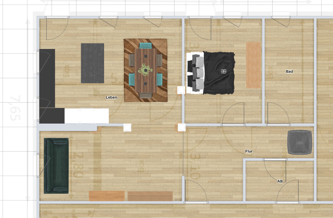

I sketched a draft for a possible layout, but somehow it doesn’t feel quite right. I have prepared a questionnaire, shortened for practical purposes:

hanghaus2023 schrieb:
I find it strange to have to go through the kitchen from the bedroom to the bathroom.
Is a daylight bathroom mandatory? Yes, that bothers me too. Do you have any other suggestions to solve this? Yes, there should definitely be a window in the bathroom.

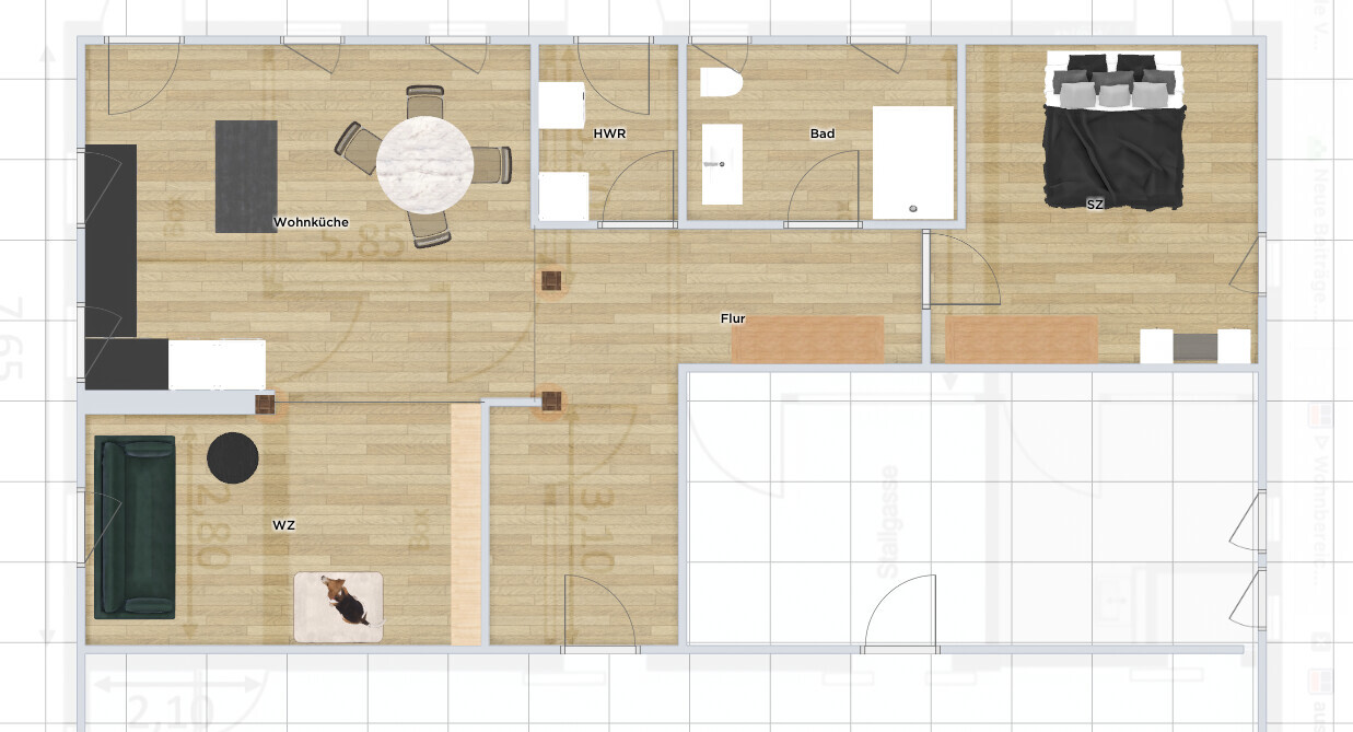

Thanks, I’m already looking forward to it. What about the water pipes? The kitchen and bathroom are planned on the exterior side according to the floor plan. Will new pipes be installed there?
I’m asking
You want to close off the ceiling area, meaning the roof? That’s interesting in terms of natural daylight lighting inside the house.
What about the water pipes? On the plan, the kitchen and bathroom are planned on the exterior side. Will there be new pipes installed?
I'm asking for a friend... regarding the most practical bathroom and kitchen layout for the apartment.
Are you planning to close off the ceiling area, meaning the roof? This is interesting in terms of natural daylight entering the house. The house’s own water supply system is shown in the upper right corner of the plan, on the opposite side of the barn area, in the basement.
Since only cold water is provided there and heating will happen in the new living area, you have freedom to plan.
I believe skylights would only be possible with considerable effort. The ceiling is already closed, above that there is a 5m (16 ft) high hayloft, and then the roof.
I have to admit that I’m also struggling with the space you’ve mentally reserved for the apartment, especially with the windows you’ve placed. There is hardly any usable wall space, and everything I try feels awkward.
(negative) example:
However, I also have to admit that I kind of took the wall on the west side, where the pantry is, as fixed. Probably because I like when an old element remains visible. So I could try again with that version if I decide to remove it 😉
But I also saw the possibility to use the windows in the other area and plan the kitchen as an interior room.
What came out of that I consider successful. Especially worth mentioning is that a lot of usable wall space was created. If the support column in the hallway is a problem, it can be moved against a wall:
What do you think, @dertill?
(negative) example:
