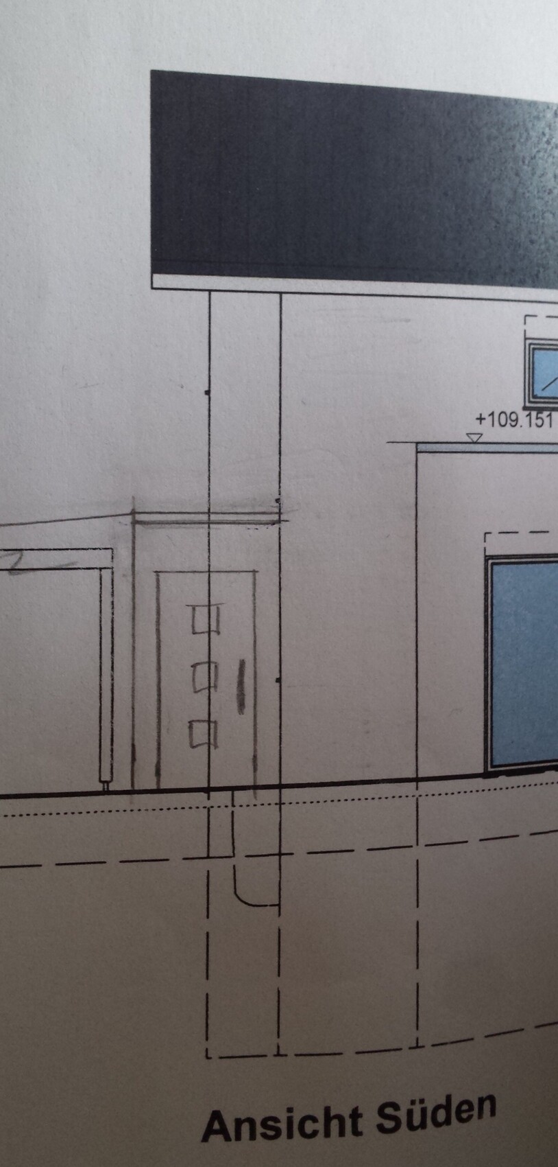

A concrete slab for an extension would initially remain unused until the extension is built, and therefore it would need to be thermally insulated from the main building slab (to prevent cold from entering the house). It would also remain unburdened for that time, which naturally would affect its settlement behavior. I could be wrong—after all, business consultants are supposedly clueless about these things—but my immediate thought is that the slab would not cost more to install in a few years than it does now. So, I wouldn’t be in a hurry to do it.
What I find more important to clarify now is whether the desired extension would even be allowed there, or if it would already lie outside the building permit/planning permission boundaries. This means
that the extension would have no actual structure, but would basically be like a kind of terrace made just from the slab?

So, I finally managed to upload it.
@11ant: The plan is to eventually build a complete extension, not just the slab. :-) I just thought it might be easier and more cost-effective if all the materials and machinery for the concrete slab are already on site...?
Explanation of the picture:
On the left edge, you can see part of the carport, with the driveway at the bottom of the image (which corresponds to south). In the current plan, the front door is a bit hidden from the street, oriented towards the west side. In the extension (shown in pencil), we could move it forward so it faces the street. The idea is a flat-roofed extension of about 5m² (54 sq ft), basically an entrance hall with a boot scraper and open access to the storage room (where the window of the storage room currently is). On the carport side, we would need a simple solid wall, and between the new and original house walls at the rear of the extension, either a fixed pane or a floor-to-ceiling window to avoid it being too dark. That would mean eventually removing the existing window, so it would probably make sense if the replacement window is already floor-to-ceiling. We would leave the passage from the extension into the existing hallway (where the front door currently is) open.
The carport ceiling could be extended as a canopy over the front door and along the house wall, allowing us to get to the car with everything dry.
Have I explained this clearly? Does this sound reasonable? And is it possible to get something like this significantly cheaper somewhere else than for $14,000?
Lina
