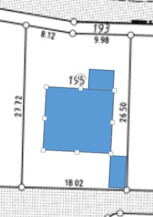

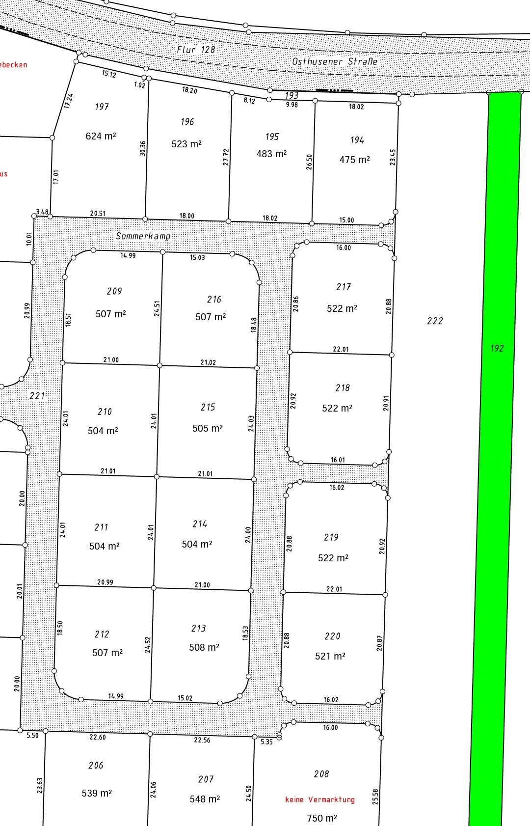

Corridor 129, parcel 195, building area within the entire property excluding a 3m (10 feet) setback from each boundary
Site plan with parcels and area measurements (m²) along Osthusener Straße and Sommerkamp.

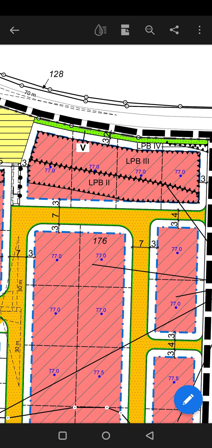

Here is the building envelope, see image
Site plan with red hatched building zones LPB II/III, blue outlines, yellow roads, and green area.

What does the development plan say about floor area ratio, site coverage ratio, number of storeys, roof pitch, roof type, etc.? I don’t think a bungalow is ideal for such a small plot.
