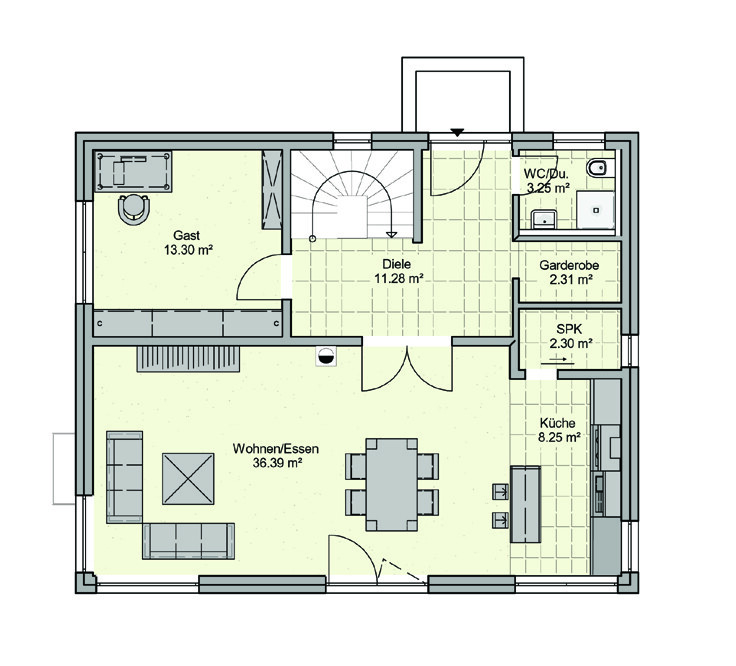

I happened to see this floor plan elsewhere (which is certainly open to debate and is only intended here to illustrate window placement): If you arrange it in a similar way, you can almost fully attach the garage on the north side. Natural light enters the open staircase area through the upper floor window, and the guest/office room receives light from the west, eliminating the need for a north-facing window. This means that on the north side, starting from the main entrance (facing west), there are no more windows, allowing you to preserve much of the garden by building a nearly flush garage.
